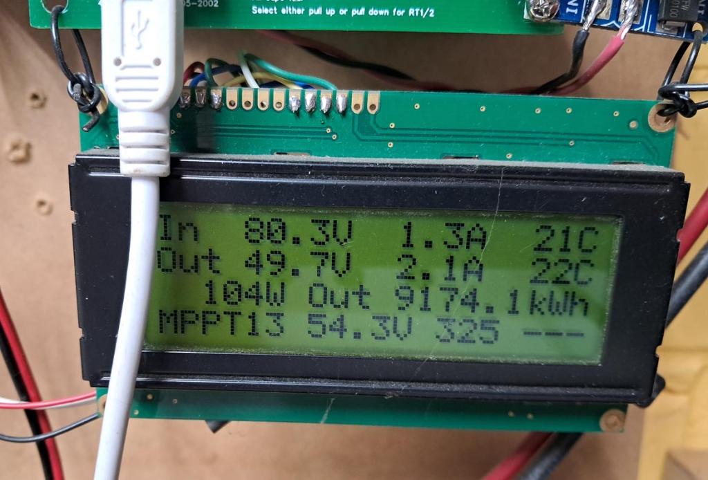

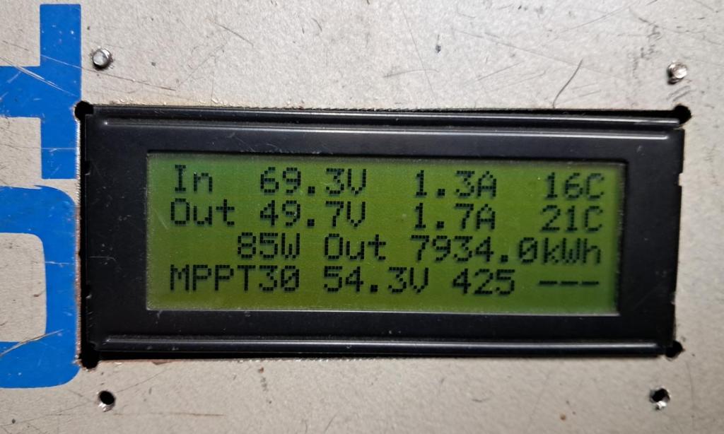

And to add insult to injury, here's a picture of the output from the first two mppt's going strong at one stage today, while the third was lagging behind. Had the camera at the wrong angle, so the third display didn't show. Not sure I should run it this hard  ...  but it was cloudy and only intermittant.
What's fascinating is that the first two lots of panels are old used 275 watt panels, two lots of 3.3kW  ...  and for short bursts they were pumping out just over that. I'm impressed. Great design, thanks man.

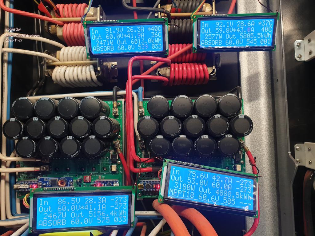

I know this thread hasn't been updated for a while, but thought I might upload a picture of my set of MPPTs and to thank Poida for an amazing project  ...  as well as Nicks and Wiseguy.
If you add it up you can see that combined they have generated 21,862kWh of power since being installed in March last year  ...  so 21 months.
Normally the outputs of all four are connected together to charge a couple of 48v forklift batteries  ...  but just at present I'm refurbing a 3rd battery and the 4th mppt is charging that on its own.
The top two are each fed by 3.3kW of panels  ...  two lots of 12 x 275W panels 3s4p
...  and bottom two by 3kW each ...  two lots of 12 x 250W 3s4p
As you can see I flog them pretty hard and have set them all to max 60A output and have never had any problem doing that.
The only time I have had issues was early in the piece when I turned off the outputs before I turned off the input from the panels. Doesn't seem to like that.
When it happens it blows the little batt volts - 12 volt converter and also once an optocoupler. If I switch them off correctly, no problems.
I added a tvr protection device to the inputs and a 13v zener on the outputs which seems to limit any damage.
Anyway, thanks guys for an amazing project  ...  and anyone considering building one, it's well worth it.

good to see. I had to respond when reading you run them up to 60A.
no doubt they can do it.
how are the chokes and heatsink temps when doing this? are they reasonable?
In my experience, these MPPT just do the job.
here are my 2, it's 7pm, cloudy in Melbourne.
Posted: 11:56am
29 Nov 2025
rogerdw
Peter, wow yours have clocked up some miles too.
Surprisingly the heatsinks never seem to get warm  ...  maybe a few degrees above ambient.
The chokes can warm up fairly quickly but I have a wide, single barrel fan across the bottom which is set to come on at 40C  ...  and shut off at 35C. The fan seems to keep them under control and doesn't get much above 40. You can hear it cut on and off during the day and doesn't seem to run long. It can start fairly early in the charge cycle too  ...  but again, doesn't have to run for super long periods.
It probably helps being all open but it's in a corrugated iron shed which can get pretty hot at times.

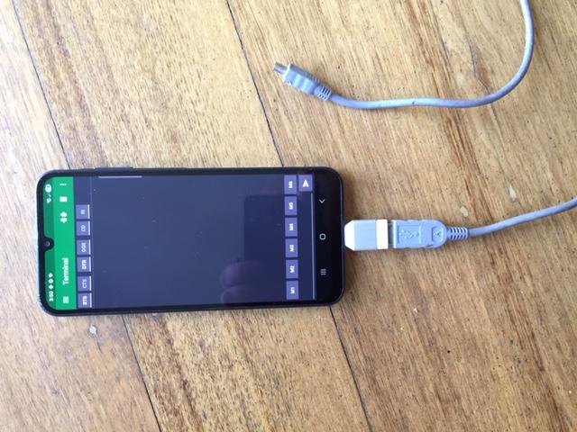

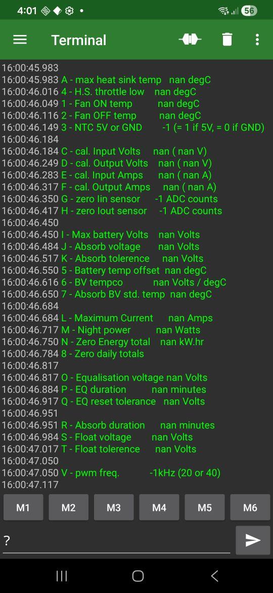

poida
I have used a samsung phone, with usb cable and special USB plug/thing called an OTG adaptor.
find and install "serial usb terminal"
config it to be
9600 baud, 8 bits, 1 stop, no parity
when sending, just "LF" as the newline terminator
choose to clear input on send
connect, send "?" and get the menu.
Edited 2025-11-30 15:08 by poida
Posted: 09:07am
30 Nov 2025
rogerdw
Thanks Peter, I had no idea that was possible.
I have a Samsung phone so I downloaded "serial usb terminal" and managed to find an OTG connector in the drawer.
You wrote "when sending, just "LF" as the newline terminator" which I didn't understand  ...  but found when I clicked the funny little symbol at the top  ...  a bit like a waveform with a gap in the middle  ...  it connected and recognised a legit target.
I was able to see the menu and make changes easily  ...  awesome.
Now that I'm rereading your comment I understand why you suggest "choose to clear input on send"  ...  otherwise you have to manually delete the previous command.
Well that's going to make any changes so much easier, thank you very much.
