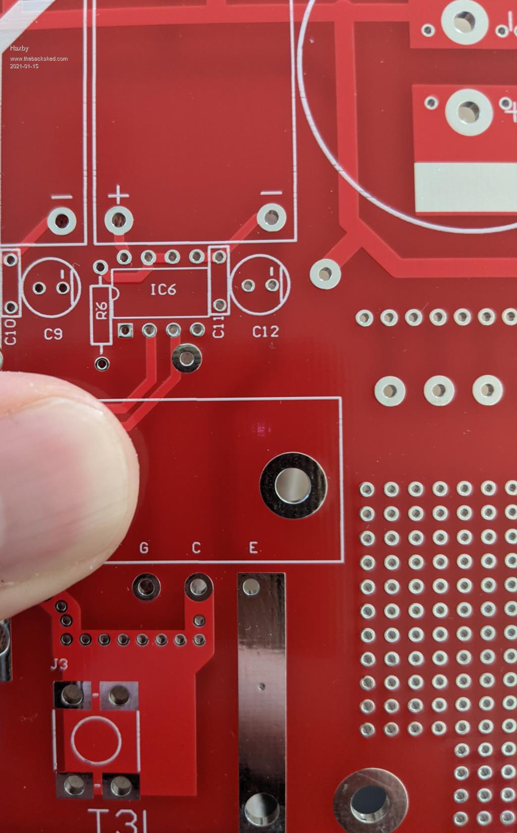

I'm following this project with great interest!
I'm not an expert in pcb designs like others. So I don't know if I'm the right person to give some critic. But we are all here to learn some things.
I like the "looks" of your pcb design, but there are some design flaws. I didn't see the bottom view, so I don't have the whole picture. Maybe you can post the whole design?
My opinion, your gate driver's look close to your igbt's but they aren't, they are cm's away because there are heatsinks between, you could better place them on the other side of your igbt's, on the outside of your board closer to your igbt's. That way your current carrying track could be shorter.
Probably there is also a current carrying track on the pcb bottom close and parallel to your gate tracks,you want to avoid that as well, it will act as an antenna.
If you can't avoid that you need to cross your current carrying track under 90 degree angle to pick up as little noise as you can.
In all cases you must try to keep gatedrive as far away as you can from the current carrying tracks.
Your capacitors are far far away from your igbt's, they are in the inside and the power tracks  are following the outside of your board. That way everything sensitive is "trapped" between noisy conductors. It will also have great inductance and this will cause fast voltage spikes. You can buffer-cancel it out a bit with low ESL/ESR caps verry close to your igbt's.
I think you can get away with this at lower voltages, but the higher the voltage, the faster the transitions (dU/Dt)will be. And the higher the spikes on your DC bus, or more precisely between collector-emittor.
Slowing down the gatedrive could help with reducing this.
I would also twist your wires coming from your brainbord to the power pcb. Or use ribbon cable, it's probably the least important bit. But those wires can pickup some noise as well and this will go to the brain board. Don't let the wires go over your powerboard, let them also leave the pcb under 90 degrees, this should reduce the amount of noise it will pick up.
I don't know if this design is the cause of your problems, I would certainly invest in an oscilloscope at this stage.
Sorry if I'm to hard on you, I just want to help and think with you. I would certainly add those low ESL/ESR caps to start with, place them verry close to your igbt's , 1 each push pull stage.

Yes an oscilloscope purchase is now inevitable.
My photos may look misleading  There is less than a fat thumb distance between gate and gate drive resistor R6.
All gate drive layouts are a cut and paste of this one. Can't get much tighter, but the leads to each opto driver IC are currently about 6 to 12 inches and not twisted, so I can fix that up easily. Though they are low impedance and floating since they only activate the opto led, so I don't think they are the problem.
The distance between caps and the IGBTs is of concern. When I was designing the board, I designed for the largest inverter to be closest to the capacitors, as that's where most of the current will be circulating. Each power track also has a copper bar soldered to it.
For now I'm convinced I'm experiencing voltage overshoot. The oscilloscope should prove that. So I'll concentrate on lowering on/off time, increasing bypass capacitance and maybe adding a low value snubber capacitor between C and E of every IGBT.

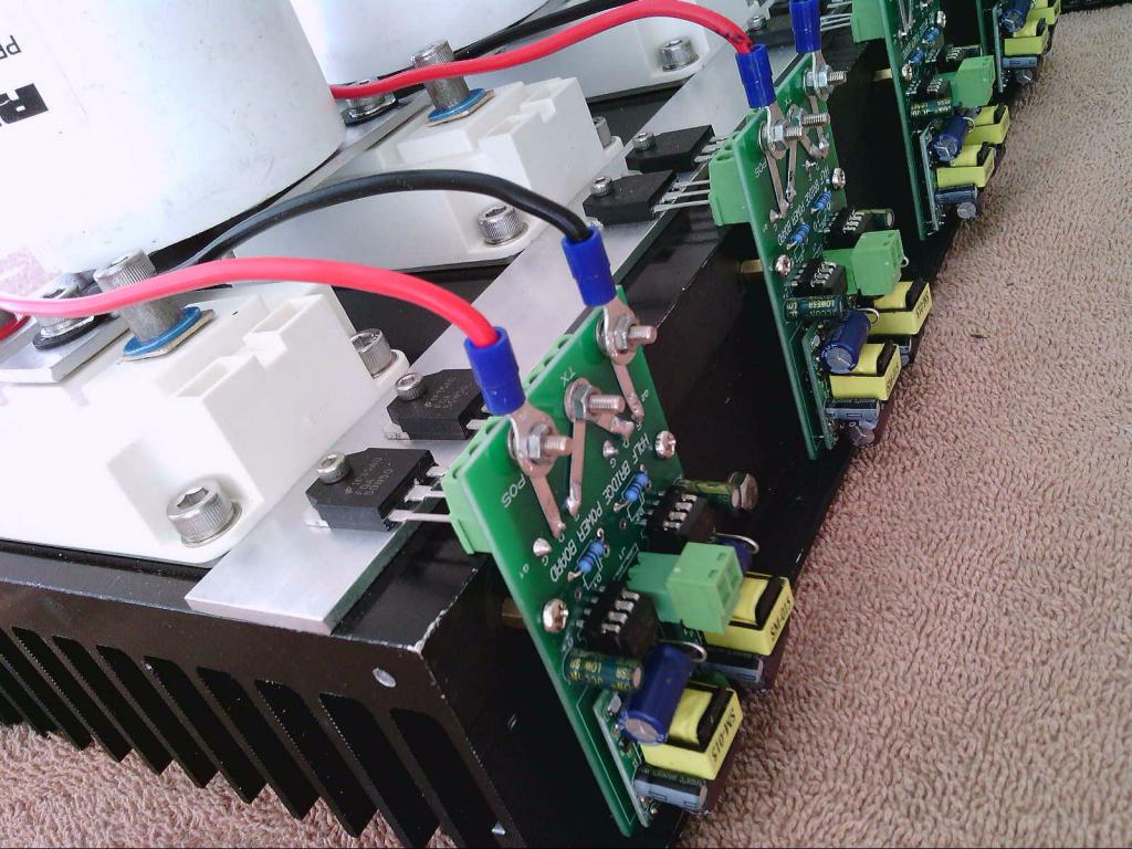

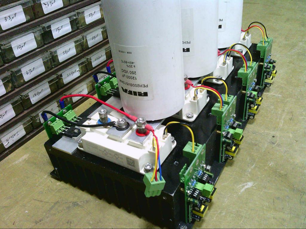

This is how I built mine three years ago.
I have given this a great deal of thought since, and still cannot think of any ways to improve on the basic layout or concept.
Good quality low esr electrolytics mounted on heavy busbars, with the shortest possible physical distance to the IGBT half bridge power blocks.
The gate drivers are on the opposite side to the collector outputs which drive the two largest transformers.
Its very simple "nuts and bolts" construction, and easy to make, and changing an IGBT only takes a few minutes without requiring a soldering iron or 230v power !
The two smaller inverters are on the other side of the heatsink.
The twisted pair connections back to to the control board plug into the green connectors, and can be made as long as required without any possibility noise pickup problems.

Posted: 10:38pm
14 Jan 2021
  Haxby said   There is less than a fat thumb distance between gate and gate drive resistor R6.
You beat me to the draw.
That looks fine.
Just as important as the distance to the electrolytics will be the type of electrolytic.
Low esr type are going to be far more effective.
Posted: 11:11pm
14 Jan 2021
Haxby
I'm using 9x560uF 450v Epcos brand caps salvaged from my ever-growing collection of aerosharp inverters.
I can't find an exact datasheet match for the part number, but all indications are that they are suitable for switch mode power supplies, so should be low esr. Part number is B43252-S5567-M1
The oscilloscope should tell all.

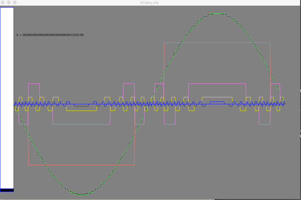

  Warpspeed said  That waveform is not right !
Its not returning to exact zero in the middle.
The positive and negative peak values are when a pair of diagonal IGBTs turn on.
The zero point is when either a pair of upper, or a pair of lower IGBTs turn on simultaneously and place a dead short across the transformer primary. It does not matter which pair turn on together (both uppers or both lowers), either will work fine, but that does not seem to be happening.
That is your problem for sure. Now we need to work out why ?
Should look like this:
I made a simple tool to visualise the waveforms of the warpverter.
You need to download the programming thing called "processing"
It is basically a java programming environment but easy to use.
download, install and run, then load this
trinary_vis.pde.zip
and run it.
it shows a perfect sinewave in Black, then the result of a 4 inverter warpverter, in Green, then the outputs of the 4 inverters in Brown, Purple, Yellow and Blue.
The idea is these last 4 are added together to make the Green curve.
You can drag the black rectangle up and down (with the mouse) to change the size of the sinewave, showing how the 4 inverter's outputs change at different times in the sinewave.
It looks like this:
Posted: 06:14am
15 Jan 2021
That is just amazing Peter.
It may be a simple tool to you, but its way beyond anything I could ever do.
It took me literally years to work all this out and solve all the problems using basically just hardware.
But it has all finally worked out much better than I ever dared to hope.
It has no commercial value because the high cost and physical size of the transformers makes it uncompetitive.
But for home brew, especially at very high power levels, it has rather a lot going for it.

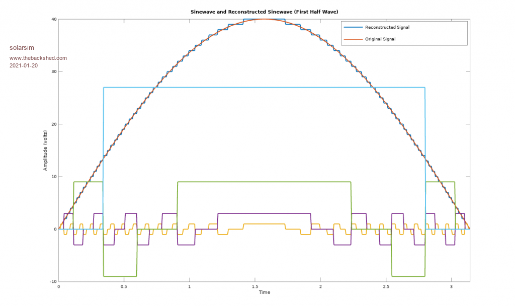

Posted: 03:57am
20 Jan 2021
solarsim
Thanks for your (usual) detailed and generous response.
(my background is physics-maths teaching-hobby electronics - theory is great, but practise and working things is even better - thats my challenge)
I wrote some code in octave and got some nice data
Here's the code
% Octave/Matlab Simulation of a warpverter sinewave
% Using a 1:3:9:27 sequence.
% Solved +-(3)^0 +-(3)^1 +-(3)^2 +-(3)^3 = unique integers from 1..40
% Note the pattern created.
clear all; close all; clc;  % Warps step inverter uses 1024 pts/cycle ..50kHz
x = linspace(0, pi, 512);  %number of points must be high to ensure good resolution
y_nat = 40*sin(x);          %original signal
l = length(y_nat);          % length of signal / array length
y = round(y_nat);           %signal array rounded to nearest integer
%transformer states required to generate voltage
a = zeros(1, 40); % states can be -1,0,1
for i = 1:3:40;   % pattern [1  -1  0  1  -1  0  .....
 a(i) = 1;
 a(i+1) = -1;
 a(i+2) = 0;
end
a = a(1:40);  % reduces a to 40 elements long (clips 41 and 42)
b = zeros(1, 40); % creates an array of 40 elements with zeros
for i = 2:9:40;      % pattern [0   1   1   1  -1  -1  -1   0   0     .....
 b(i:i+2) = 1;   %these are tables of tran
 b(i+3:i+5) = -1;
end
b = b(1:40);
c = zeros(1, 40);
c(5:13) = 1;
c(14:22) = -1;
c(32:40) = 1;
d = zeros(1, 40);
d(14:40) = 1;%testing that recombined will generate approximation of original signal
yval_test = a + 3.*b + 9.*c + 27.*d;  % test routine to call at command prompt
aext = zeros(1, l); % array of zeros l long (8192 now)
bext = zeros(1, l);
cext = zeros(1, l);
dext = zeros(1, l);
%calculating transformer state over time from rounded version of original signal
for i = 1:l
 if y(i) == 0    % matrix only goes from 1..40  Cant ask for the 0^th element
   aext(i) = 0;  %  so transformers off for 0v when rounded
   bext(i) = 0;
   cext(i) = 0;
   dext(i) = 0;
 end
 if y(i) != 0
   aext(i) = a(y(i));
   bext(i) = b(y(i));
   cext(i) = c(y(i));
   dext(i) = d(y(i));
 end
end   %reconstructing rounded data from transformer state arrays
y_recon = aext + 3.*bext + 9.*cext + 27.*dext;
%plotting data for comparison
plot(x, y_recon, 'LineWidth', 2);
hold on
plot(x, y_nat, 'LineWidth', 2);
title('Sinewave and Reconstructed Sinewave (First Half Wave)');
legend('Reconstructed Signal', 'Original Signal')
xlim([0 pi);
plot(x, aext, 'LineWidth', 2);  % amplitude=1
plot(x, 3.*bext, 'LineWidth', 2);% amplitude=3
plot(x, 9.*cext, 'LineWidth', 2);% amplitude=9
plot(x, 27.*dext, 'LineWidth', 2);% amplitude=27
xlabel('Time');
ylabel('Amplitude (volts)')
and this produces this graph
Is it a bad thing for a transformer drive signal to go straight from +1 to -1 without stopping at 0 (off) for a short while.
ie  % amplitude=9 (medium) transformer driven one way and then totally reversed without a bit of settling time? Should i hand edit the data to force a 0 state inbetween?
thanks in anticipationjavascript:AddSmileyIcon('')

  solarsim said  Thanks for your (usual) detailed and generous response.
That diagram above is beautiful !
You have nailed it perfectly.
Its the math and software that I find very difficult.
The hardware part is much more my thing.
A transformer can certainly transfer a square or rectangular voltage waveform without any problem at all.  Its square wave current that transformers struggle with, but in the Warpverter, all the transformer windings only ever see a perfect sine wave current.
If you can get to the stage of programming a suitable prom with multiple lookup tables, you are at least half way there.
What I did was measure the dc input voltage with an eight bit analog to digital converter that begins at half scale.
In other words X input volts give 00 and 2X input volts give FF
That selects one of 256 different lookup tables.
You can then jump from one lookup table to another at the zero crossing points without introducing any abrupt waveform discontinuities.
That same prom will work over any 2:1 input voltage range, and all you need to do is wind your transformers to suit the minimum voltage the inverter will ever see.
