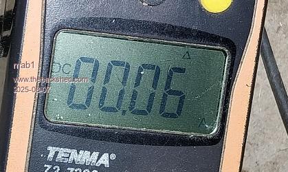

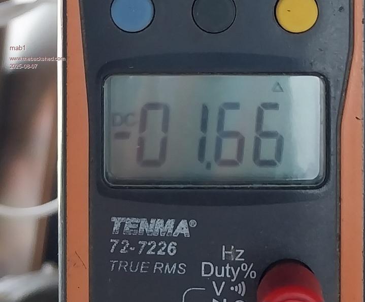

Update:
having resoldered the optos, it was running much nicer, but there still seemed to be noticeable transformer noise when running under load, but oddly, got quieter when backfed from the gti's, even at higher power. It made me wonder if I still had asymmetric drive - the gti's are sunny boy transformer types so they would obviously push back with a symmetrical output.
Had the idea of measuring the primary current using the clamp meter set to d.c. and sure enough, it was consistently showing 1 amp or more in one direction even with no load connected.
With 2kw load it would nudge up towards 3A.
When backfeeding it was too noisy to be sure, but given that other people's builds have quiet transformers, it was time to go back to the test bench.
Thinking it could be another dodgy solder joint , I tried to think of a way to test the whole gate drive, optos,  and totem pole drivers: decided to use a signal generator to drive a 10khz 5v-0v square wave into each opto in turn and look at the mosfet gate signal in each case:
Actually turned out easier to spot than that: for 3 of the optos, applying the 10khz signal caused the 12v supply currect to increase from 55mA to around 78mA for the high side drives, and about 86mA for one of the low side drives, and I could actually hear the 10khz drive faintly. For the 4th opto (one that had had a bad solder joint) there was no increase from 55mA and no noise!
Soldered a new opto in and bingo! All four drives work and produce a square wave on the gate resistors   (although, there was still a slight difference in the current draw for the two lowside drives: about 86mA for one and 94mA for the newly installed one - I'm still thinking about that   ).
So reassembled the inverter with a transformer and:
almost inaudible!
It's been running running quietly ever since - except:- every now and then the transformer does make a little noise, and using the clampmeter, it does coincide with a small dc current (0.3 - 0.5A). It seems to build smoothly over a few seconds,  then fades gradually over several minutes,  then it will be quiet with no measurable d.c. for the best part of an hour before doing it again - I can't figure what could cause it and it dies it irrespective of if there's any load connected or not.
I tried wiggling the optos,  just in case it was a dodgy socket, but even moving them about in their sockets has no effect. Tried one of the other programmed nanos, but it's not that either.
I don't know if that's small enough imbalance to not worry about or not.
