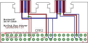

The nunchuk ports 2 and 3 board I posted here plugs into the 40 pins on the back
of the CMM2 would be better with the nunchuk pcb mount connectors.
a two port I2C using the front nunchuk port
two port I2C
an I2C way to make use of joy sticks and other analog devices
joy sticks I2C way
I have not had time to cut into my code for some of my boards using some of the
I2C chips posted in here  some I2C chips
