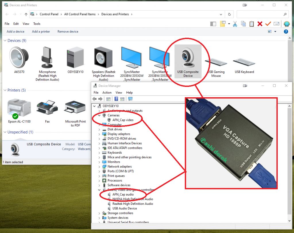

In this thread I volunteered to test a VGA to USB video capture device:
  Womble said
  Volhout said  capture
Maybe something like this ?
  TassyJim said  Volhout,
That capture device 'should' work but until it's tested, no one really knows.
I don't have a VGA capture device so am volunteering as a Guinea Pig
I have ordered one of those, and will report back on how it works with the CMM2... once it arrives on the slow boat from China.
I has now arrived, and I have got around to some preliminary testing
It Works
Intel i7-4790 16GB GTX1050ti Windows 10 Home (version 2004)
Using VLC to display video and sound, no drivers or software were required to get this working
(no software is supplied with the kit, just the device, a short VGA cable, and a USB-A to USB-A cable).
I used the supplied cable the last time I updated the formware on my CMM2
There is some lag when typing on a keyboard --> displaying output on the PC
but it is useable.  I did need to fiddle with the settings in VLC to display the output legibly, but selecting a suitable "Video  Size" fixed this.  I am sure there must be better software for the PC end of things.
I also plan on testing this using the serial console to see if I can do away with the keyboard, and will test with soem of the "new" widescreen resolutions that Peter has implemented in recent betas.
I will investigate further and post the results here.

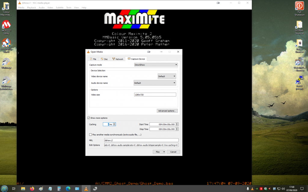

  elk1984 said  Cool!
I was looking for something similar so I could use that plus TeraTerm to "remote" into my CMM2.
I have not tried TerraTerm, but I was able to connect to my CMM2 with PuTTY (release 0.74 64-bit x86 Windows) using
115200baud 8data 1stop NoParity XON/XOFF
enter text and commands in the terminal window and display graphics and sound output  via the VGA-->USB2 capture device in a VLC window.
I used this command line (created a windows shortcut) to open the VLC display
"C:\Program Files\VideoLAN\VLC\vlc.exe" dshow://  :dshow-vdev= :dshow-adev= :dshow-size=1024x768 :live-caching=0
here is the output of matherp's ghost demo. VLC settings shown. CMM2 v5.05.04RC3
Using VLC there is some lag, and audio stuttering.  I am not caching the video stream at all.  I will try OBS and maybe some other software soon, but for the time being VLC seems to do the job, although I would not want to play a game this way.  Its good enough whilst coding.

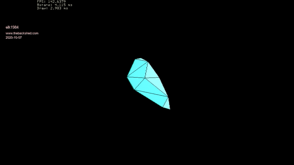

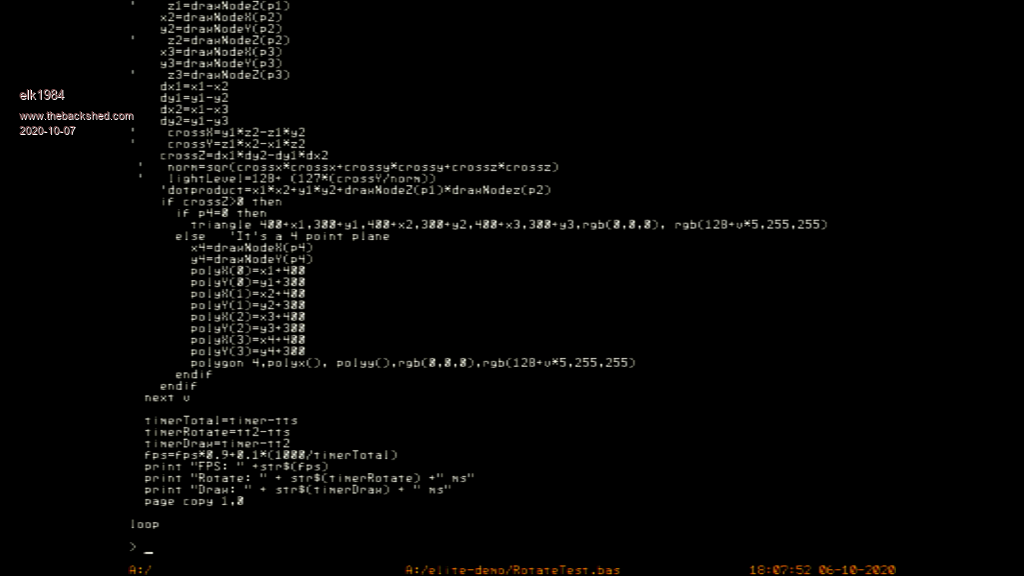

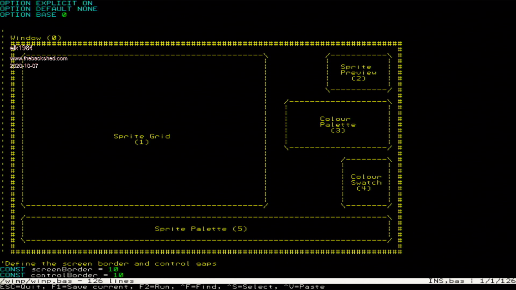

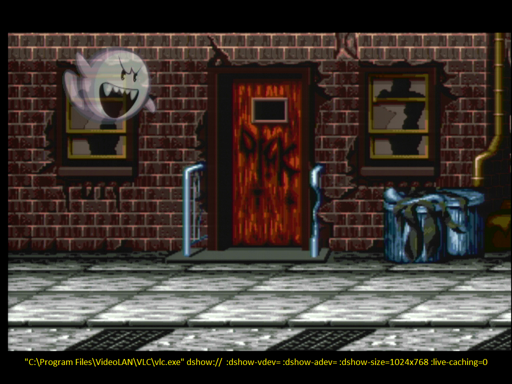

I have tested using firmware V5.05,06b9 using the latest version of TassyJims excellent colourBars.zip and recorded a crude video of the output using VLC
1080p = 1920x1080 pixels
"C:\Program Files\VideoLAN\VLC\vlc.exe" dshow://  :dshow-vdev= :dshow-adev= :dshow-size=1920x1080 :live-caching=300
Here is a YouTube link
Aplogies for the crude nature of the video, that is the raw output, and it was produced blind, no editing, just me pressing keys to cycle through some video modes.
Hope it gives you an idea.
Software Used: Windows 10x64, PuTTY, VLC
Running on: headless (PuTTY) CMM2 --> [capture device : VGA --> USB2] --> I7-4790 16GB SSD GTX1050ti
I really need to investigate some better software, OBS has been suggested.
The video is very laggy and slow because I was caching the input and converting to h264 / MP4 on the fly, and manually counting to ten between each keypress to cycle modes because I could not see the output whilst recording.
Using VLC as a monitor, without processing any video is much better, although you need to play with the settings to find the sweet spot.  It does not help that I am using dual 1680x1050 monitors so some scaling is occurring on my screen.
But the upshot is that all the video modes seem to display ok.
You asked for Mode 7, here is the original snapshot from VLC which I have zipped up because the forum software scales things.
vlcsnap-2020-09-20-01h37m55s864.zip
Hope that helps
