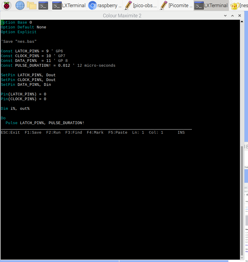

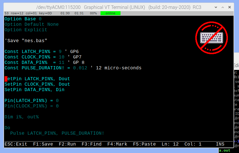

Hi Rob/folks,
I noticed that Editor syntax highlighting from the PicoMite is not display properly in GFXterm (20-may-2020, RC) on the Raspberry Pi.
Using "nes.bas":
   nes.zip
PuTTY shows:
GFXterm shows:
Note the incorrect colours starting at Option Default and again at Pin(CLOCK_PIN%).

hi tom,
   it seems the pico port of mmbasic is sending some really weird/obscure escape sequences to set text colours. many terminal emulators (including GFXterm) simply ignore such text colour/attribute sequences, as there are far too many variants to support them all and throwing an error would be 'unreasonable'.
here are a list of what i get from my pico (a25) with a typical page:
ok?      sequence             occurrences    effect/colour
yes     <ESC>[0m                    2       normal text (reset to defaults)
yes     <ESC>[32m                   3       green
yes     <ESC>[36m                  23       cyan
NO      <ESC>[38;2;128;128;128m     2       bright black (grey)
NO      <ESC>[38;2;192;192;0m       2       yellow
NO      <ESC>[38;2;255;128;0m       4       orange
NO      <ESC>[38;2;255;128;128m    29       pink
yes     <ESC>[4m                    2       dim foreground
NO!!!   <ESC>[97m                 150       bright white (aixterm standard)
the aixterm one (<ESC>[97m) is a doozy - i'm surprised anything supports that.

Posts: 4405
Posted: 03:54pm 13 Jun 2021
  robert.rozee said  it would seem that they are not supported on the putty Tom is running on his Raspberry Pi. perhaps Raspian has a special cut-down putty version?
Tom says "Huh?"
If you look at my original email it is GFXterm which isn't displaying the correct syntax highlighting ... unless they are both wrong and the output should be more colourful ... I did think it was a rather grey palette.
  Quote  you have a palette of 16 standard colours (8 dim, 8 bright) available that is supported by just about every terminal emulator out there. the only things lacking are the colours pink and orange. why not just use that palette to maintain compatibility?
+1
Peter can you confirm that the PicoMite EDITor is using different syntax highlighting colours to the earlier 'mites ? I (briefly) looked at the source for them and they all seemed to be using the standard 16 colour palette.

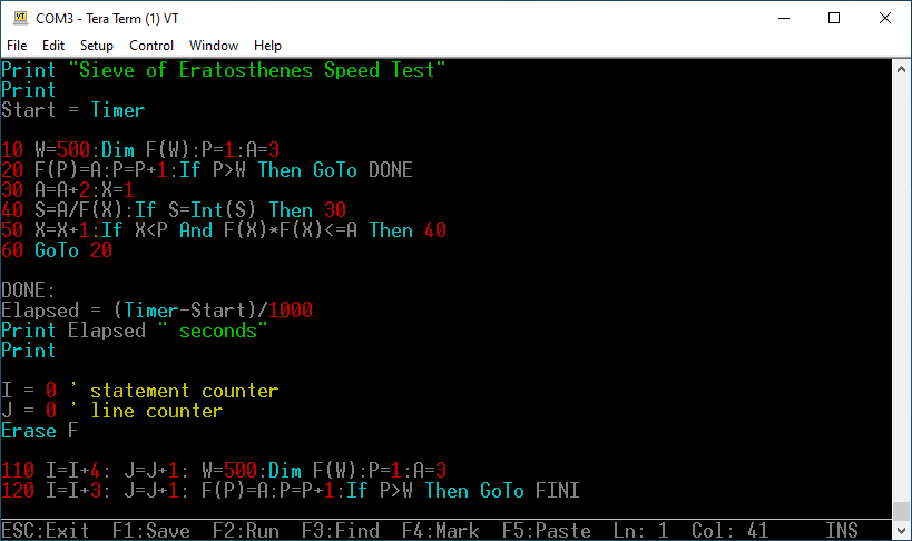

Posted: 12:47pm 14 Jun 2021

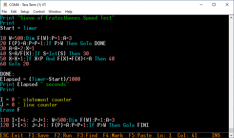

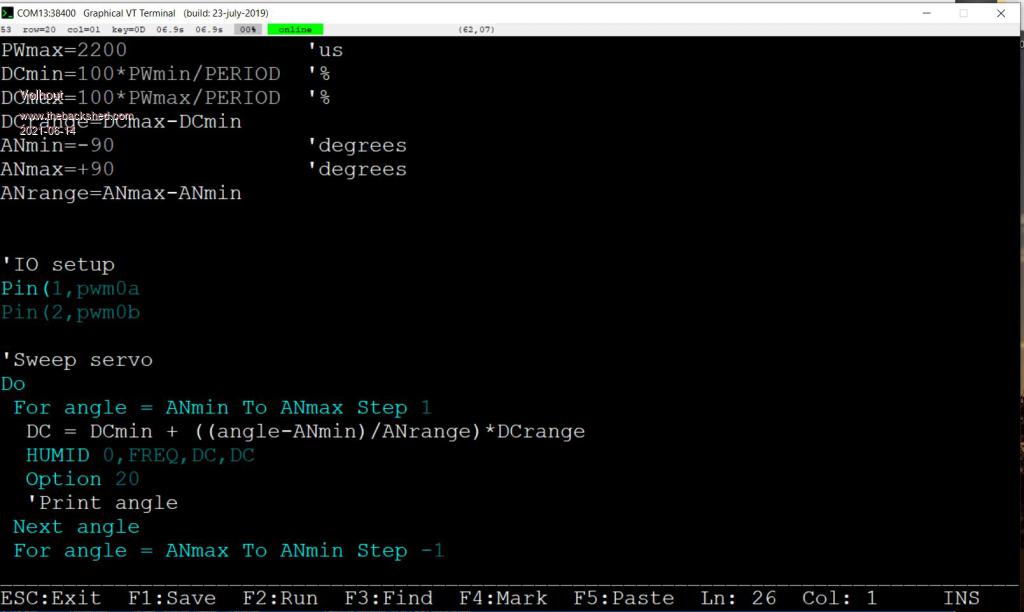

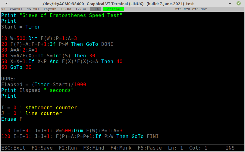

just realized i had a win10 netbook here that i haven't wiped yet, so did some experiments comparing teraterm to GFXterm. each has exactly the same code loaded onto an MX170 or pico.
GFXterm, MX170:
TeraTerm, MX170:
TeraTerm, RP2040:
note: TeraTerm has the palette change made so that grey text is visible.
the file sizes (screen captures), despite being roughly the same dimensions, came out quite different, with the one from GFXterm about 4x larger than the TeraTerm ones. i eventually figured out what was going on - while GFXterm uses font dithering for the displayed text, TeraTerm seems to turn dithering off. this is, partly, why the TeraTerm text appears to be less smooth.
rob   :-)

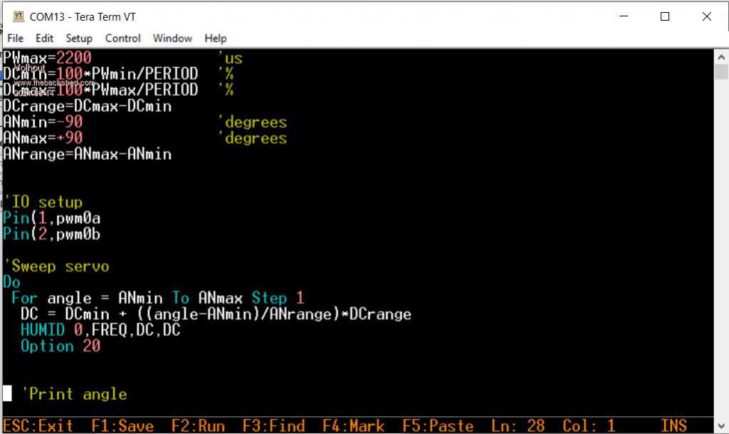

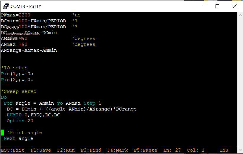

Posts: 6169
Posted: 01:13pm 14 Jun 2021
pi pico MMBasic a25
GFXterm windows
Putty Windows
Teraterm (windows ...)
Edited 2021-06-14 23:36 by Volhout
