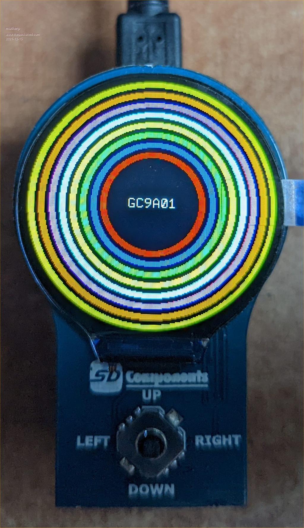

Lewis recently sent me a 1.28" Round LCD HAT for Raspberry Pi Pico with a request to create a driver for it. This I have done and rather than add it to my huge box of unused displays we have agreed to send the display (not the cheapest) to the person who comes up with the most interesting idea for using it, with of course a commitment to building their idea.
Details of the display are in the link. The PCB is 37mm at its widest point and 58mm tall and of course includes the 5 position joystick switch. It plugs directly onto a standard Pico
Please post ideas on this thread and Lewis and I will judge the best with a Christmas deadline. Extra points will be given to anyone who models and demonstrates their idea on any other Pico display.

Running on a PicoMite: https://youtu.be/LbC8pWRzu-4
Note that the PicoMite version does have audio, but mine isn't yet wired for sound ... TBH I'm a little suprised I didn't get an error about the fact that OPTION AUDIO is unset (Peter?)
Running on a Colour Maximite 2: https://youtu.be/quosIboidbM
Code will go up on GitHub when I have a moment.

Posts: 6151
Posted: 02:36pm 23 Dec 2021
Wauw, you did it Tom !!!
This looks vey nice...
Posts: 11938
Posted: 05:05pm 23 Dec 2021
After due consideration, the judges (Lewis and me) are happy to award the display to Tom (thwill). I'll get it in the post after Christmas.
Congrats to Tom for an inspired idea and implementation
Posts: 4405
Posted: 05:21pm 23 Dec 2021
Thank you Peter and Lewis, as you probably guessed I really wanted this device and really appreciate winning it.
I actually had a more original (game) idea but I was already half-way through the implementation of Polar-Snake. Hopefully I'll be able to follow-up on that in the New Year ... just need to knuckle down and deliver serial comms for MMB4L first.
Merry Christmas,
Edited 2021-12-24 03:22 by thwill
