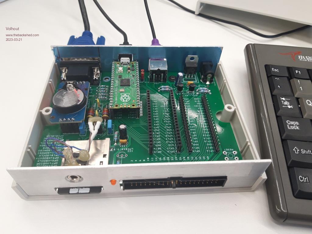

Posts: 6036
Posted: 05:47pm 21 Mar 2023
Ok, you want a pi zero hat connector to a picomite.
Sorry, misunderstood.
There is one thing to take into account: On the VGA mite there are not many IO pins unused (10 in total, 7 digital, 3 analog/digital), and you could add to this the I2C bus (2 pins). We have to carefully plan the pins on the 40 pin (hat) header to make best use of the available hat's.

I think of having one PicoMite and dedicated boards for each job. You can then plug the Picomite into any of them. Ok, you really need a VGA and a non-VGA, but you get the general idea.
A "hatstand" is only a PicoMite wired to pins, maybe with a power supply socket and/or  a reset button. Everything else is out to pins and you plug on the appropriate "hat". It's not as dependent on external bits like the Microbridge as the MX170 was. In fact, put pins into a PicoMite pointing "upwards" and you have a "hatstand" already.
TBH I, personally, couldn't find a use for that - it's too vague. If the "hats" are stackable then you can only use them in particular sets because of pin clash. Do you, for example, have separate "hats" for VGA, PS2 and audio just in case only one of those functions is used?
Perhaps a better way is to make all "hats" I2C. The connector has 5V (in case it needs a high current), 5V GND, 3V3, 3V3 GND, SDA and  SCL pins. Each "hat" makes its own arrangements after that. It could be a simple expander chip or a MX170 reading some analogue inputs into buffers. Using this system you can use another Pico as intelligent IO if you want. Several of them. :) It will work with any of the existing designs that makes an I2C port available, but you may need an adapter board to get the pins in the right positions for "hats". The adapter could simply stand alone and be connected by wires, plugged into a CMM2 for example.
