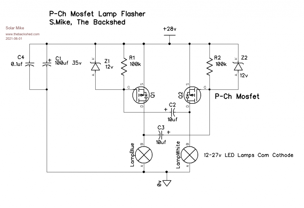

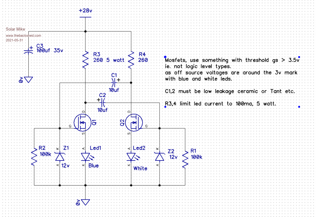

Mike is correct in pointing out the zenners were left off the circuit, and should be included. Otherwise...."POOF" after the first flash.
I like Mikes simpler, but very clever discrete circuit. His thought process is above what I came up with and I'm going to breadboard one up just to tinker with.
Good luck with the project.
Pete'.

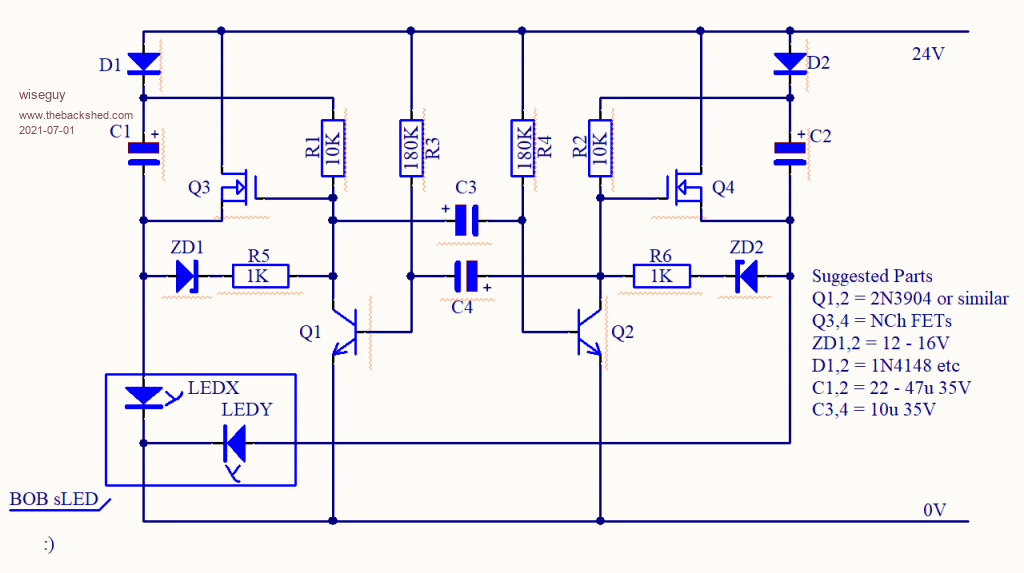

Posted: 01:06am 01 Jul 2021
Ok I fess up, there is something in my circuit that I don't like and it needs to be fixed or you could end up with 3 legged resistors as Bob has found out.
If you follow the current path when a power FET is on, at the instant that the smaller transistor turns on (to turn off the FET), there is an unintended high current path via the source of the FET via the zener into the small transistor. (see original circuit a couple of pages back)
So it is a race whether the FET turns off first or the zener or and the 1N914 or and the small transistor curls up their toes first.
Admittedly the FET turns off in probably 100 - 200nSecs but damage/stress may have occurred.
I know my breadboarded circuit worked fine but I did have one instance of a 3 legged resistor due to a wiring error (and probably this high current path).
The circuit improvement is posted below, I placed a 1K resistor in series with the Zener (R5 & R6), now the current is limited to ~ 25mA, the resistor adds about another volt to the zener voltage so suggest no higher than a 16V zener is used.  C1 & C2 charge up fully in less than 250mSecs (for 47u) so operation is essentially unaffected.
If you dont like the flash rate, increasing the value of resistors R3 & R4 or capacitor values C3 & C4 will slow down the flash rate & vice versa to speed up.
There should be no slow turn off of the LED current - it is instantaneous, so a slowly turning off LED has another reason why, faulty component or wiring error.
So Bob, if I caused you some grief with this oversight - sorry, but look at all the experience you have gained in the process

wiseguy
Joined: 21/06/2018
Posts: 1336
Posted: 03:26am 01 Jul 2021
I forgot to add, if you use Pete's circuit 1 or 3 with the Mosfets & zeners, they should also have the 1K resistor added in series wih the zener for the same reasons.

I got warpspeeds ,Mikes.  circuit up and running and put a video here
I'm still getting transistors blowing though . Its not a worry with this new tester but I must have put in 5 new pairs to date.Got about 90 left though.

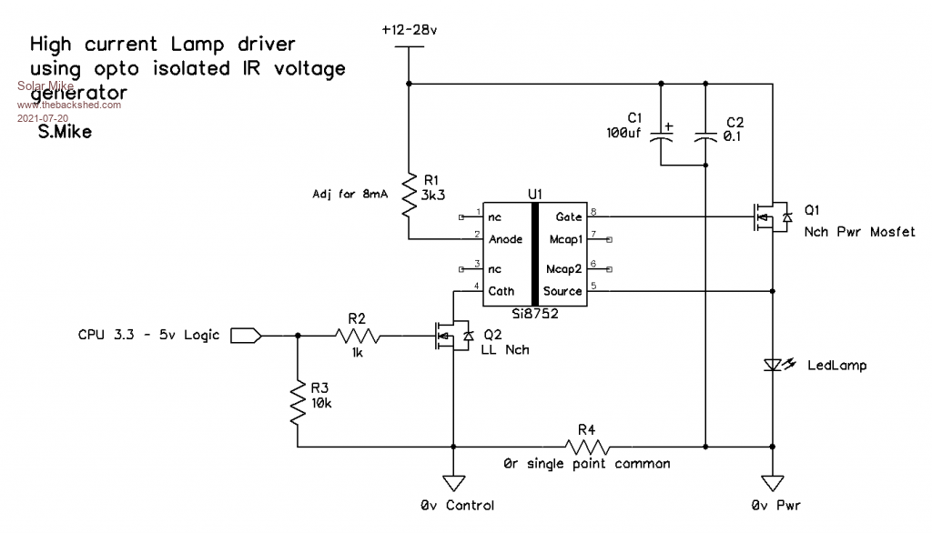

Solar Mike
Joined: 08/02/2015
Posts: 1255
Posted: 11:21pm 19 Jul 2021
  bob.steel said
I have however moved on. I like the flashing of the Police car circuit and am considering adding a third red LED lamp to the mix when I get the right Mosfets and get them to behave with the cheap lights I intend to use.
Bob a cpu will give you ultimate control to achieve exactly what you want and as you say you have learnt some new ideas through your experimentation and input from TBS, building designing any electronics is always a learning experience, and yes sometimes there is smoke...
I can understand wanting to use components on hand, however there are some smart mosfets for sale now that allow high side power switching with low side control from a cpu, see this example IR6226 , there are others similar, coupled to your cpu would make the easiest to build solution for high side power switching considering you need quite a number.
One of those 8 pin Picaxe chips 08M2 would be ideal for this sort of thing.
I quickly drew up this circuit, which is what I would use in a similar case usage where the switching is quite slow and some of the parts are already on hand; the SI8752 chips are used in solid state switches. The circuit would have to be duplicated for each lamp.
Alternatively Solid State DC Relays  that work with DC maybe the quickest solution.
