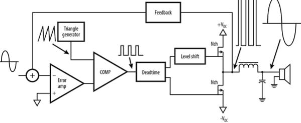

Warp, what about a micro " creating " the spwm and a analog device ( external ) to adjust the peak/average of the waveform for voltage regulation? ? Sort of what you do with a square wave fed into a comparator and adjust the trigger point voltage ( feedback )

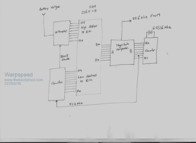

Posted: 11:51pm 15 Apr 2018
Here is my most recent idea for the simplest possible hardware only pure sinewave PWM generator.
The idea here is that we use a very large ROM to store multiple 1K lookup tables.
Each lookup table cycles through 1K fifty times per second using a 51.2 Khz clock.
The data output of the ROM is compared to a high frequency counter to produce 25.4 Khz PWM with an 0-100% duty cycle.
A digital voltmeter reads the dc battery voltage coming into the inverter, and selects a suitable lookup table to keep the amplitude of the PWM going into the transformer primary constant, regardless of any changes in battery voltage.
Just as an example, we could easily cover a 2:1 input voltage by only using the upper half of the ROM addresses (giving 128 different lookup tables). The voltmeter would measure the incoming dc voltage once only at each zero crossing to select an appropriate lookup table for the next mains cycle.
This has both advantages and disadvantages. The advantages are extreme speed of response, with total stability.
Under very heavy loads the transformer output voltage is going to fall slightly, but hopefully not by enough to be a problem. The main challenge an inverter faces are large voltage changes at the dc input created at the battery.
Many improvements are possible such as adding slow integral output voltage correction, or using more of the available ROM. But the aim here was to come up with something really simple using the fewest possible parts.
Posted: 12:09am 16 Apr 2018
  noneyabussiness said   Warp, what about a micro " creating " the spwm and a analog device ( external ) to adjust the peak/average of the waveform for voltage regulation? ? Sort of what you do with a square wave fed into a comparator and adjust the trigger point voltage ( feedback )
What you are suggesting sounds very much like a high power class D switching amplifier.
That is also a very interesting approach.
Its basically a multi kilowatt PWM audio switching amplifier running with a 50Hz tone.
The waveform purity would be excellent, and so would the output voltage regulation.

Posted: 09:02am 16 Apr 2018
Exactly what I was thinking. .. d class amps are common and filtering etc. Is well established and well documented. Its just the unknown load, whereas speakers you can calculate easily (ish).

Posted: 09:16am 16 Apr 2018
Class D avr
Something along these lines, fed a 50hz sine wave
