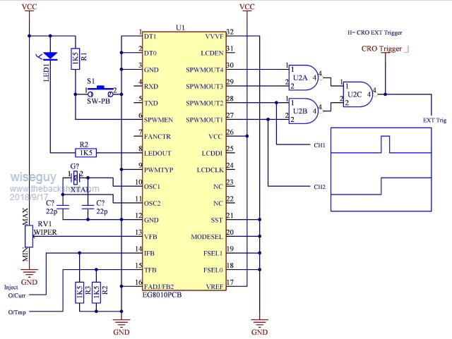

I have tried to discuss premature inverter failures on the forum a few times as I had a suspicion that all is not well. Despite the resistance to new ideas and the negativity and scorn I keep receiving I have continued to ignore it & evaluate the EG8010 as I have a desire to help others in a constructive manner (and it also benefits me).
If I am going to use the EG8010 I want to know about any bad behaviour that it has so I may avoid some of the pain and frustration that others have faced.
The first clue that all is not well in EG8010 land is that the updated EGS002 board has external transistors on the SPWM outputs to eliminate cross conduction. I eluded to this point in an earlier post that it may have been prudent to include those transistors on the Mad controller boards - I was confident they served a purpose.
So today I soldered my EG8010 on an adaptor board and set it up on my prototype board with the minimum components required to bring it to life and operate.

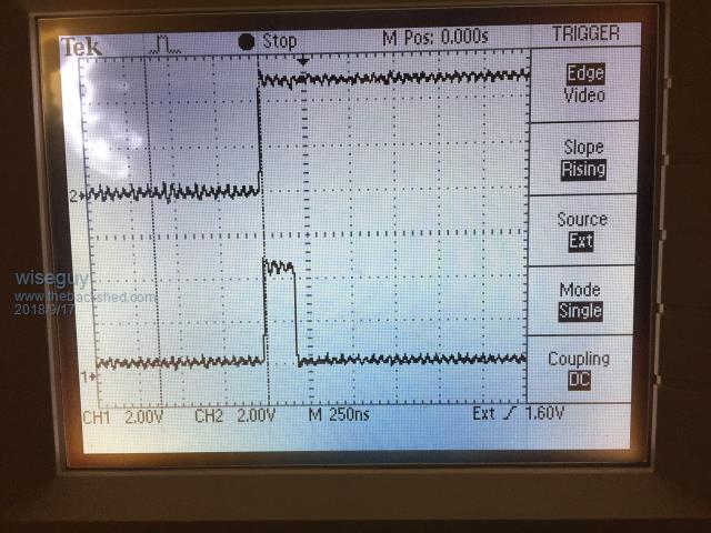

To test my theory I grabbed a quad nand gate & put 2 nand gate inputs on the SPWM1&2 outputs and another two on the SPWM3&4 outputs. If ever either of the nand gate outputs become low we can potentially kiss our FETs goodbye. For the non technical (should you be reading this...) a nand gate will provide a high output as long as both inputs are never high at the same time.
By coupling the two nand gates into yet another nand gate we can monitor both halves of the bridge. Now if either side of the bridge has 2 concurrent (high) drives to the upper and lower FETs the third nand output will go high and trigger the CRO so we can see the evidence. Remember there is supposed to be a 300nSec dead-time between the on transitions from the upper to lower FET and vice versa, so if the CRO triggers it would appear that something is seriously amiss ?
Bingo! Within a few minutes after switch on I had captured a 250nSec pulse overlap generated after a disturbance. Over temperature or over current will cause the glitch, just as the fault (O/temp or O/Curr) condition is removed and the LED becomes steady again the glitch appears. Over and under voltage behaves slightly differently & will also cause the glitch on the chips third attempt to re-start.
I will post my schematic and a CRO shot of the event and implore that someone (maybe Poida?) may run some tests to duplicate my results. I have just the one EG8010 that I tested but I am confident that my findings will be verified. If Poida uses that nice looking Rigol it will probably have a A&B = high trigger to avoid wiring in the nand gates?
So in summary if this is the smoking gun, it explains a few things. Most inverter failures happen after a start/restart. If prior to the restart there was no over temperature or feedback voltage out of range event that stopped the inverter then all is well. I havent fully analysed an overcurrent thyristor shut down, I believe it needs a power down to restart, which might then avoid the glitch occurence. Setting up the inverter properly ala a Tinker pre-run setup, gives the inverter the best chance of starting properly with everything in range and avoiding a pyrotechnic display.
I am nowhere near finished torturing this device - maybe this is its one and only achilles heel, but I doubt it ?
I am busy for the next few days but I will wire in the anti cross conduction transistors and prove (or not) that the glitch is gone.

Solar Mike - I will definitely be placing some logic at the SPWM outputs for a few reasons not all that I wish to publish at this time - I am over the arguing and criticisms.
Noneya - Maybe I wrote too many words. The guts is that when set up properly and then turned on, an inverter may run indefinitely whether running small or huge transformers and small or huge loads.
However if you ever have an overtemp or under/over voltage shutdown event (I havent modelled the overcurrent behaviour yet) I wish you good luck - but it will probably go bang.
Likewise if you have not set up the unit in a similar fashion to Klaus's excellent set up guide, it may go bang very prematurely.
Let me state once and for all - I like the EG8010 I believe that it can make my inverter work reliably and well. I couldnt write software like Mad, Poida or Solar Mike to save my life. But I can find & design out hardware issues and foibles & I dont give in easily - thats my forte.

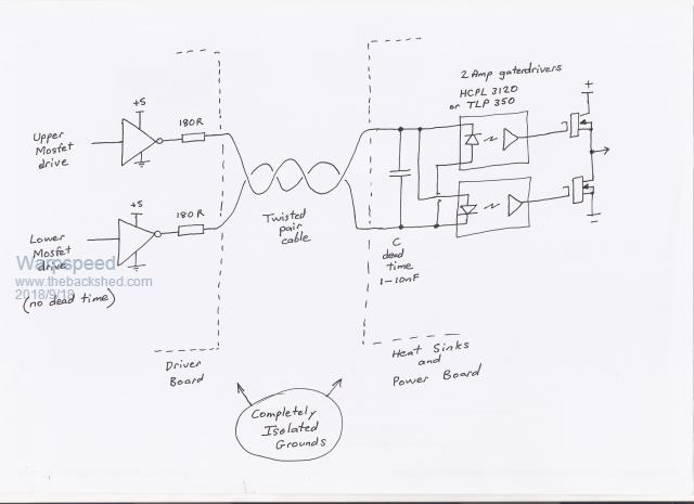

Yes indeed. I have just about given up trying to help people here, it only results in being attacked and rubbished, its just no longer worth the aggravation.
There are a great many unknowns in these Chinese chips and their internal software and functioning. They could be very susceptible to noise and random crashes/restarts.
No way of knowing really.
But a very clean noise free power source and ground for the control board, and complete optical isolation between the control board and the very noisy high power bridge may help a lot.
That is also the place to add some very simple bullet proof extra cross conduction protection.
There needs to be multiple layers of protection.
Make sure nothing bad can ever happen by being extra careful, then add an extra layer of protection on top of that for when the impossible does one day happen.
Here is a very simple circuit I came up with a few years ago to positively protect from cross conduction, fully optically isolate the control system from the power board, and optionally add some dead time by adding a single capacitor.
Its impossible for both opto isolators to be on together, no matter what.
And it totally isolated the control board ground from the very noisy sources of the lower mosfets.
A balanced twisted pair will also have much higher noise immunity than the horrible ribbon cable, especially if it goes near the lower heatsink pair that are switching very fast at high voltage.

More thoughts - I was enthused when I found the overlap issue and couldn't wait to post/share the information last night at around midnight, but I have been thinking about this on and off all day.
Why dont more inverters give more grief ? - maybe I have an answer to that too. ~250 nanoseconds of overlap on one half of the H is asking for trouble. But if we have longish wires a buffer stage gate resistors and multiple FETs in Parallel this all helps the Mosfet gates to see a reduction of the original 250 nanoseconds to a lower value. What is that value, how is it affected by different setups etc - I do not propose to go any further in that direction.
I describe the result though as marginal engineering, sometimes it will be better sometimes worse - my contention is that 300 nanoseconds of dead-time is what should be there, but instead we have overlap of around 250 nanoseconds - that is what I will concentrate on, removing the overlap entirely & removing an issue by elimination.
To fix this issue with a minimum of grief would entail putting 4 transistors & 4 or 8 resistors on the adaptor board (4 could go on the control board) and swap out the old adaptor board with the modified one. Thus anyone wanting to upgrade is simple. My approach would be to design a new adaptor board to simplify assembly and at the same time trying to make space to fit the crystal and 2 caps on the adaptor board, space permitting.
Please note this last paragraph is premature as I have yet to prove that the anti-overlap transistors will remove the glitch without introducing any other undesirable side effects.

Posted: 10:27pm 18 Sep 2018
Mike. you are definitely on the right track.
I don't think anyone here has built one of these inverters and had it work very first attempt ever.......
There has always been a fairly painful and very frustrating learning curve, which has led to eventual success for many here. It can be done !
There is a lot more to this than just copying someone else's schematic and expecting similar results. Even using well proven circuit boards is no guarantee of initial success.
There is also a lot more going on in these inverters than a great many people realize.
I have tried to shed light on some of these darker mysteries, but my ideas have never been popular or well received.
The consensus seems to be "I never bothered with any of that and my inverter runs just fine".
Anyhow, I will toss out a few more ideas which may lead to some greater insights for some people.
The first thing is that any software must be very well thought out to both power up and shut down cleanly with a slowly rising and falling +5v supply. Usually the processor itself cannot be relied upon do that, and it will need some external hardware assistance. Another thing is that one processor instruction cycle is a hell of a long time in a cross conduction situation, so software protection of the mosfets is just not a realistic hope. Any cross conduction protection needs to be very fast and in hardware.
Another thing to think about is that there will be multiple power supply rails within the inverter +5v and +12v at least, and possibly up to four individual isolated power supplies for the mosfet gate driver circuits. These will have energy storage capacitors with different and uncertain time constants. All sorts of strange unpredictable behavior can be expected as these supplies power up and power down in an unknown sequence.
In a brown out situation, all bets are off !
Then there can be destructive noise spikes that get into the grounding system, power supply rails, or picked up by input connections to the microprocessor. Physical layout is critical. It may agree with the schematic, but moving a few grounding points around can make a dramatic difference, both good and bad.

Thank you for the cordial reply Mad. I did not mention the series resistor in my simplified version of Oztules testing (it wan not meant as a guide to follow) the pertinent part was the limiting of available energy to destruct - even with a series resistor the capacitors would be well able to kill things for a shoot through event.
There is an issue I have identified that after an over-temperature event a shoot through condition is clearly evident. Maybe in some configurations it has not/is not causing a problem. Maybe in some versions of the EG8010 this doesn't happen. I dont have all the answers yet but I consider this an important enough point to raise and communicate to the forum because it IS happening on the current release of the EG8010 and its ability to destruct is high.
