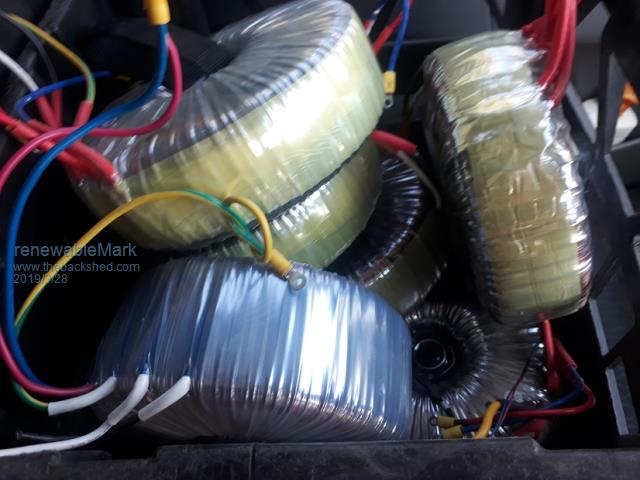

OK so.... torroids.
I have a double stacked pair of 3kw's. That has 128 turns on 4 secondaries, primary so far is 14 turns of 70mm2.
I do have plenty of that 70mm so can wind on as much that will fit, it wont be pretty though, reckon only 6 more will fit.
I can get some 25mm2, that should still carry 100 amps, or use 50mm2
No 2 torroid I have an unmolested 2kw aerosharp.
No 3 torroid I have an unmolested 2kw aerosharp.
No 4 Will pick up a 1kw aerosharp.

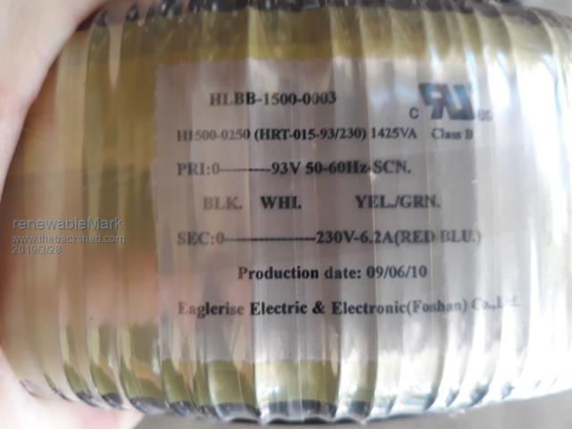

OK I'm not too great on calculating, so I'll need a bit of help with the torroids.
Batt volts is a 48v bank, my normal LV cut off for bank is 46.5, but it's never actually cut off in 6 months use, I think the lowest it's been under a heavy load was the low 47's.
No 1 toroid is already made with 2x3kw cores stuck together 128 turns of 4 layers secondary.
14 turns currently on primary.
So how many extra will I need on the primary?
No 2 torroid will be a 2kw core, I'll most likely rewind this from scratch, so what would be the optimal turns and number of layers for secondary and primary?
No3 & 4 I picked up a few smaller ones today.
Cheers Caveman Mark
Off grid eastern Melb
Posted: 09:45am 28 Mar 2019
Mark, lets do these one at a time.
If you design all of your transformers to have a 44.0 volt minimum, that will allow for a little bit of extra voltage margin for voltage drop in the mosfets and wiring.
With a 25 turn primary, the secondary voltage will be 44v x 128/25 = 225.28v
About 35mm squared wire should be about right for the primary.

Warp, that torroid is actually 127 turns on the sec, not 128, which doesn't work out as well @ 223.52v
I spose where they come out at the side I could add more wire and make another turn, or swap out the other torroid that is in the machine running the house, that one is 128.
Cheers Caveman Mark
Posted: 09:40pm 28 Mar 2019
It makes things a whole lot easier if we can design all of our transformers to have whole volts on all of the primaries and all of the secondaries.
When you strip off the existing primary, just add one extra turn to the secondary to get back to 25/128 and a 44.0v minimum voltage. It can be just one extra turn of big fat wire. That should not interfere too much with the primary that goes over it.
The other alternative would be 24/127 and make our minimum voltage 42.5v for the other three transformers.
Both solutions are workable.
