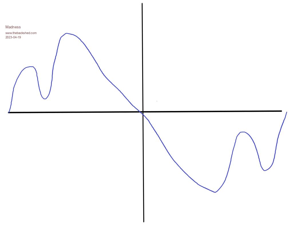

It has been a long time since I have been active here due to issues I have had and I won't bore anyone with the details.

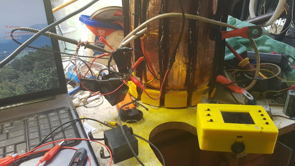

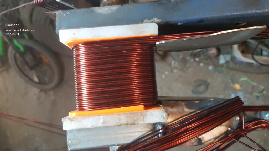

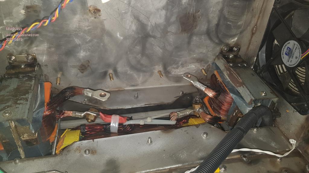

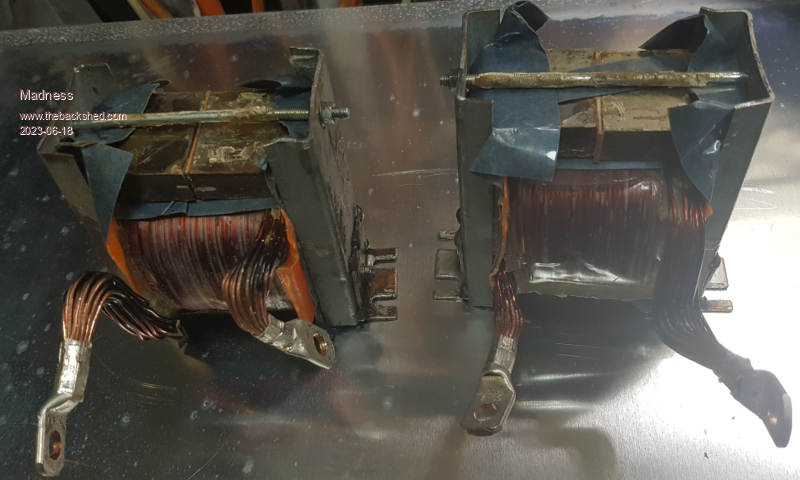

I have just built a new inverter with 3 Aerosharp Toroid Cores.
I have used the large choke cores from the Aerosharps to make these chokes. 12 Turns of 30 1.6mm wire which gives a total of 60mm2.
I have managed to shoehorn this into 2 Aerosharp cases with one choke on either end of the Toroid and power board output.

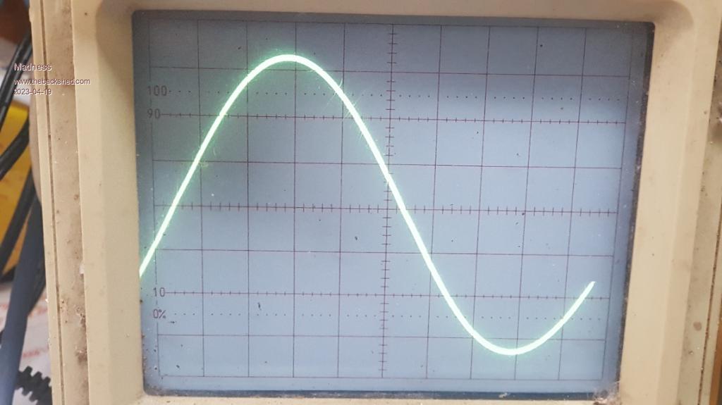

This runs perfectly as a standalone off-grid inverter it is almost completely silent and gives the best possible sinewave output.
There is no sign of any wobbles at zero crossing etc just at no load the peaks of the sine wave are slightly flattened.
In spite of it running so well I am having issues with back-feeding from a GTI. I have only tried one with a few hundred watts of power available so far. If there is no load on the inverter the GTI tries to connect but the sine wave has like another small sine wave following the path of the main sinewave like this. Please excuse my lack of artistic ability, it does this for about 1/2 of second and the GTI quits and retries.
It will run fine if the is more load on the inverter than the GTI is able to output. But if running like this and I reduce the load the inverter makes some oscillating groaning sounds for a second and the GTI quits. I am using the Murphy code for Nano1 uploaded in the last month.
Has anyone had success with back feeding? I am planning to work on syncing with a generator but if it won't backfeed then that won't do what I want.

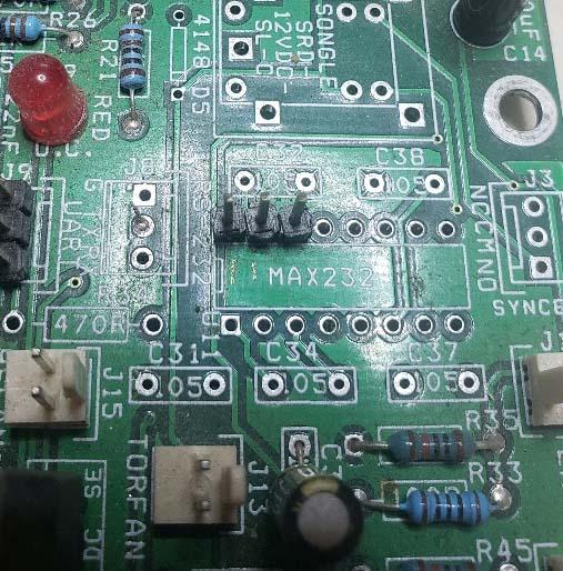

Also does anybody know what the hack is that is mentioned here Hack
"nano2 code oversees things and shows stuff on the LCD.
I have many variations of nano2 code that is for I2C LCD, serial LCD,
a AC curent sensor (that needs a simple hack on the nanoverter board)
and others."

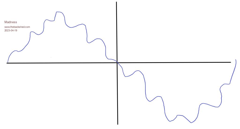

I had another look at the waveform when the GTI connects. This is a better drawing of it.
The image above is more like what happens after the GTI is connected with a load already on the inverter and then the load is turned off.
I have tried it with the V7 No Bessel version of the Nano1 code and it is the same.
Edited 2023-04-19 15:03 by Madness

So I think the distorted waveform seen above has origins from the electrical interaction of some parts of the system.
If the nanoverter was upsetting things, I would expect much slower changes,
not 4 or 5 dips in AC voltage per 50 Hz cycle.
How slow? Something like AC voltage varying up and down at 2 Hz or 3 Hz and maybe up to 5Hz.

On my 6KW (2 stack) nano inverter I have a choke in each primary leg.
One side has a 180uH choke, made from double large aerosharp chokes (made into an E core) with 18 turns of 40mm sq.
The other side has a 2 stack powdered iron toroidal choke, cores similar what KeepIS uses. (C8610125)
That one has 40uH, 7 turns of 25mm sq wire.
Without back charging (when the battery bank is full) that inverter is virtually silent now.
The microwave does still mess up the sine wave.
Fitting a 3 stack toroid & parts into a doubled Aerosharp case does look like a challenge, I'm surprised you persisted. I've given those ss boxes a miss long ago, have still some taking up space on the shed shelf though.
Its not that hard to weld up an angle frame and make your own enclosure to whatever dimensions you want. You can see how on my (tinker's) built.

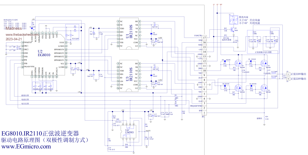

I said above I was going to try Unipolar on the EG8010, what I should have said is BIPOLAR, must be going mad.
The Bipolar modulation requires VFB from each side of the output but they only show it being used with a high voltage type inverter.
I have tried this but get a sine wave that looks like it has not had the SPWM filtered out but is much wider, I ran out of time on it today to get any further. I used the VFB circuit as per above on the toroid output. Previously I had just enabled Biploar with just the standard VFB we have been using forever on the EG8010, that gave a sinewave that had the top half looking normal but the bottom half was wobbly after zero crossing and the amplitude was reduced to about 2/3 of what is should be. I tried linking together both VFB and VFB 2 and got the same really wide sinewave as per above. Maybe something else is faulty causing that.
Poida is there possibly a different way in the code to produce the SPWM? I see here https://www.thebackshed.com/forum/ViewTopic.php?TID=9409&P=16#127475 you were working with different methods. If the Closed loop for the voltage control is basically the same as the EG8010 then am I right in thinking that the SPWM is the only possible factor assuming the hardware is functioning correctly? I have tried the standard EG8010 setup with the test set and the new inverter I have built and they run fine running normally and back feeding. They also run perfectly with the Nanoverter driving them and will work with a GTI but runs into problems when they try to backfeed.

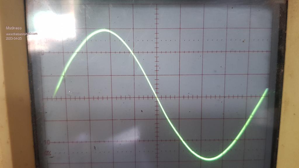

Turned out the really crazy waveform was caused by a bad connection on one side of the toroid secondary. But still no luck in getting the EG8010 to play nicely in what they call Bipolar mode.
I have been trying to find out if the type of SPWM modulation is what is preventing the Nanoverter from back feeding, but I have not found an answer as yet.

  Madness said  Also does anybody know what the hack is that is mentioned here Hack
and others."

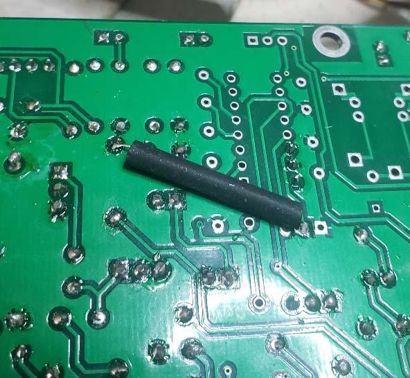

I can now help with this.
I wanted a "proper" AC current sensor to give AC current readings,
not the diode bridge + current transformer that was designed into the
nanoverter board. I spend a while trying to make it work and it
was poor, the Vf of the diodes made it very non-linear.
the hack:
first, remove R36 (2K2)
I fit a 3 pin 0.1" header to pins of the unused MAX232, pins 14,15,16
This gives me +5V, Gnd and unconnected for now.
I run a 2K resistor from the unused pin to R36 pin that goes to
the Nano analog input.
This now gives me a 3 pin header that I con connect various

I ended up getting the EG8010 to run in Bipolar but it is very heavy on the DC current. So I am giving up on trying that idea to test if that type of modulation is compatible with GTI back feeding.
Next step I will try is hacking the early  2X Sine code to run as Nano 1.

Just another sine-wave photo? Yes, but this is a sine-wave generated by the 2XSINE code above on a Nanoverter with a GTI Connected! It is running as smooth as silk, no growling, just connected and ran with no change to the sinewave at all. This is with no load just the GTI and oscilloscope probe connected to the inverter output. ATM it is cloudy and the GTI is only making around 50W ATM. I will let run all day and see how it goes. There is no way it would work like this with the V7 Nano1 modulation, I know that version runs really nicely but it does not want to play with a GTI.
To get the code above to work I had to change
u = 20000.0 * sin(t);
to
u = 23000.0 * sin(t);
This was to get the AC up from 200V to 230V, I am not sure if this is the best way to do this I hope Poida can verify if correct or not. It may need to go higher as I don't think there is any headroom for a load on the inverter as it is now.
Edit. I have now seen over 300W back-feeding and all is well.
