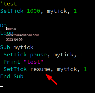

Posted: 07:50pm 08 Apr 2023
Found another error:
Keyword: colour defects
Posts: 11996
Posted: 09:37pm 08 Apr 2023
That is correct. Colouring only happens for defined commands and functions. Pause happens to be a valid command. Resume isn't
