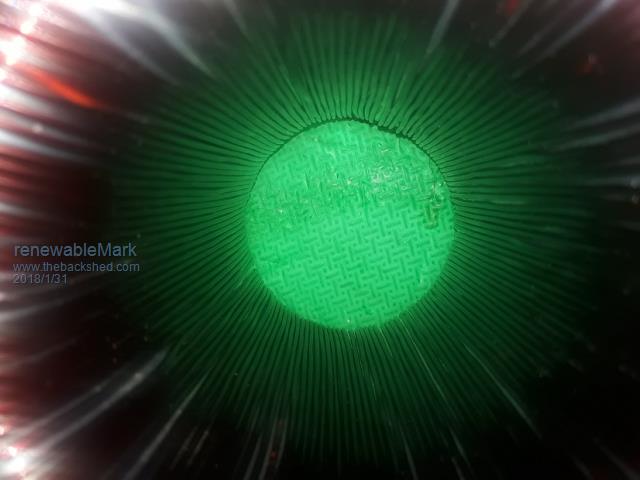

Don't sweat it Mark, there is going to be a ton of room in that hole.
This is going to be a very nice transformer, low flux density, low idling current, and just about the perfect balance of copper between primary and secondary.
If you can fit 16 primary turns in there, do it.
You may decide to remove a turn later on when you get into some serious testing.
But its a lot easier to pull a turn than to add one turn at a much later stage.

All the wires will fit in around the circumference don't worry. I won't look like it at first when you wind it on but it will as you work with it.
You can use the choke you have already.

renewableMark
Joined: 09/12/2017
Posts: 1679
Posted: 08:49am 31 Jan 2018
Well the 4th winding went on well, only just fit. It could possibly have slotted one or two more wires in the centre.
IF from the start you anticipated this, you could really really pull super hard and make it really taught and compressed in the centre to gain maybe one or two more mm in ID which would make a big difference when getting to the 4th winding.
Sorry to see you guys getting distressed about the primary winding, anyway when in doubt ask the designer (not to say that's always right, but a good starting point)
Cheers Mark
Time for a beer fellas.
Cheers Caveman Mark
Off grid eastern Melb
renewableMark
Joined: 09/12/2017
Posts: 1679
Posted: 09:15am 31 Jan 2018
Here is some inverter porn for the toroid pervert.
Some sections are just on 80mm others 77mm.
I'll do the volt phase test tomorrow and put on a test primary winding.Edited by renewableMark 2018-02-01
