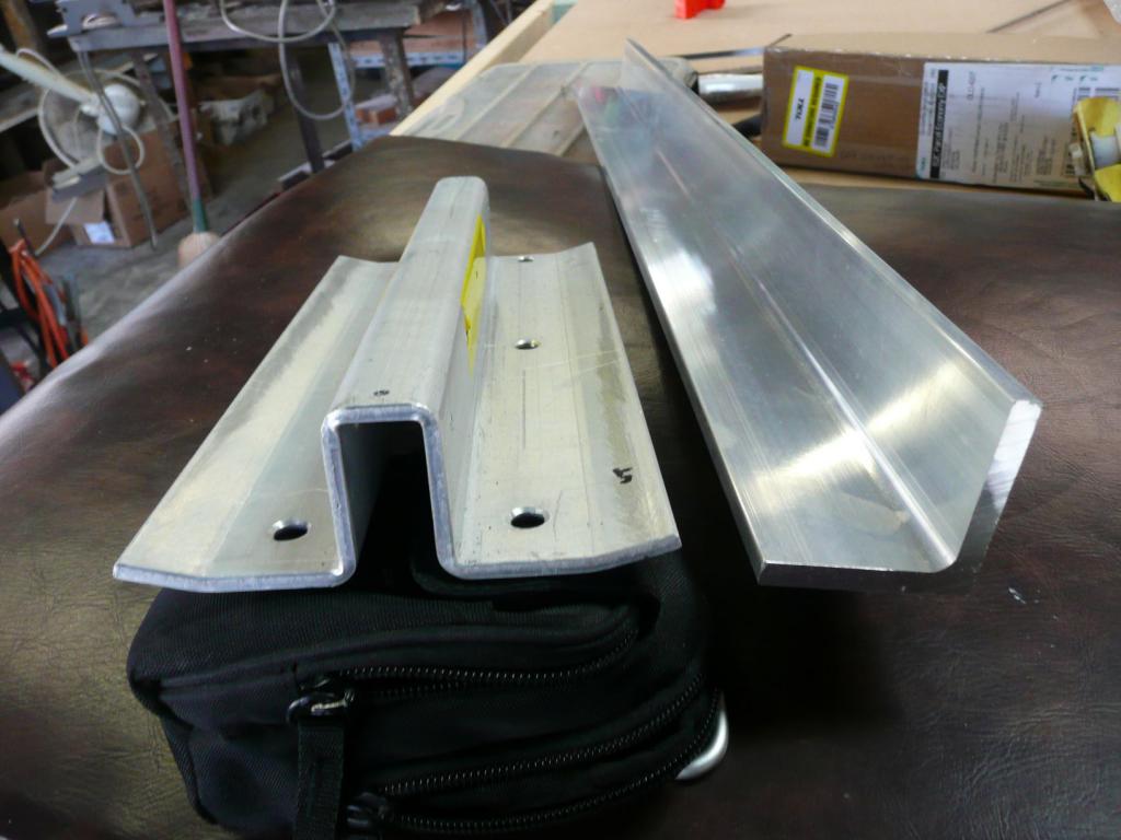

That length of Al was only $20, maybe get another and put it back to back like this.

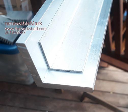

Or sit them inside each other, if doing it this way I'd buy a 50x50 to sit at the bottom.
This layout will be easier.
The inside and outside corners are nice and sharp, so they will fit together fine.

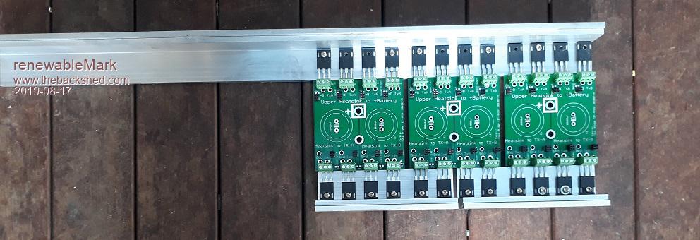

Reckon I'll get another length of 50x50x6mm to sit under the other one.
Bolt those two together, then they can bolt onto the finned heatsink.
That bigger surface should probably have a heat transfer helper.
What works better silicone sheet or the paste?

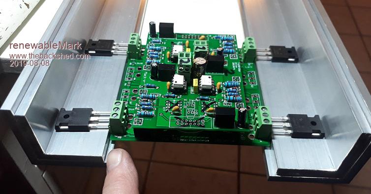

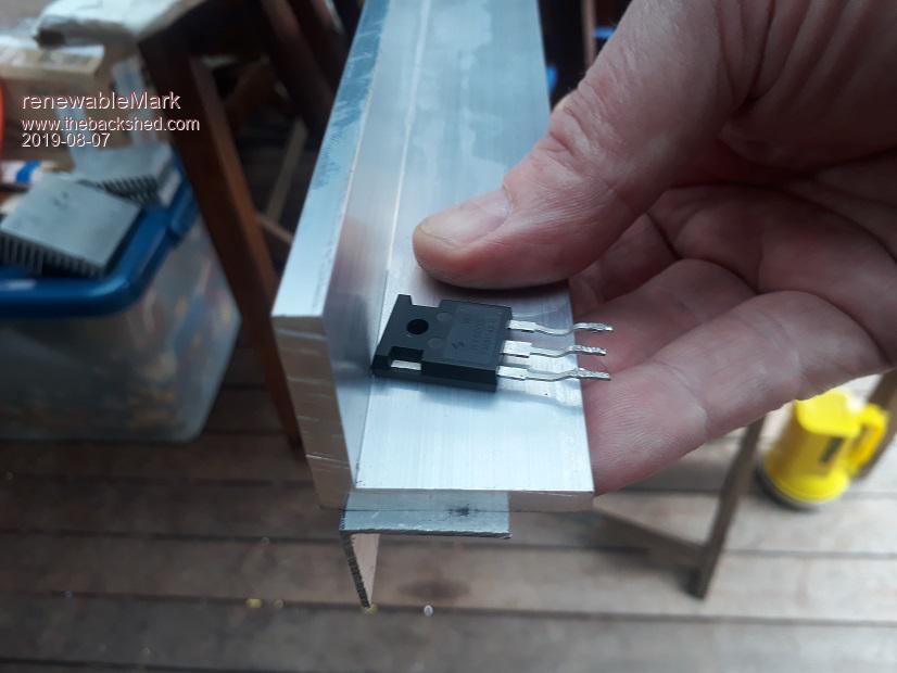

This is what I ended up with.
The 50mm sticks out just enough to be a threat to the terminals under the plug, so that will get put on the table saw and trim it back (where my finger is pointing)

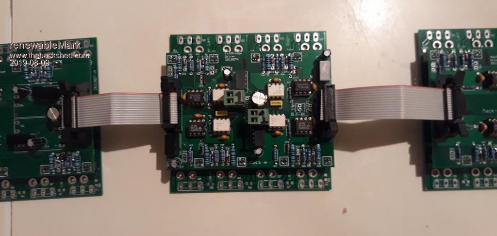

Hey Andrew, just checking that the orientation for the cables is correct.
Cheers Caveman Mark
Off grid eastern Melb
mackoffgrid
Joined: 13/03/2017
Posts: 460
Posted: 01:06pm 09 Aug 2019
Looks Good.
The notches of the PCB headers should all be the same way as well.
I see you've used IDC headers with ears. I always draw PCBs just using the "Boxed" headers because they take up less PCB space.
BTW, if you ever wish to probe the test points with your scope, I bought some cheap BNC leads on ebay, cut off the alligator clips and soldered on one of those 2 pin header sockets. Then if you haven't soldered in the test points, I just plug in a 2 way header pins into the lead and they seem to sit reliably into the PCB holes. The round pad of the test pins are always local gnd.

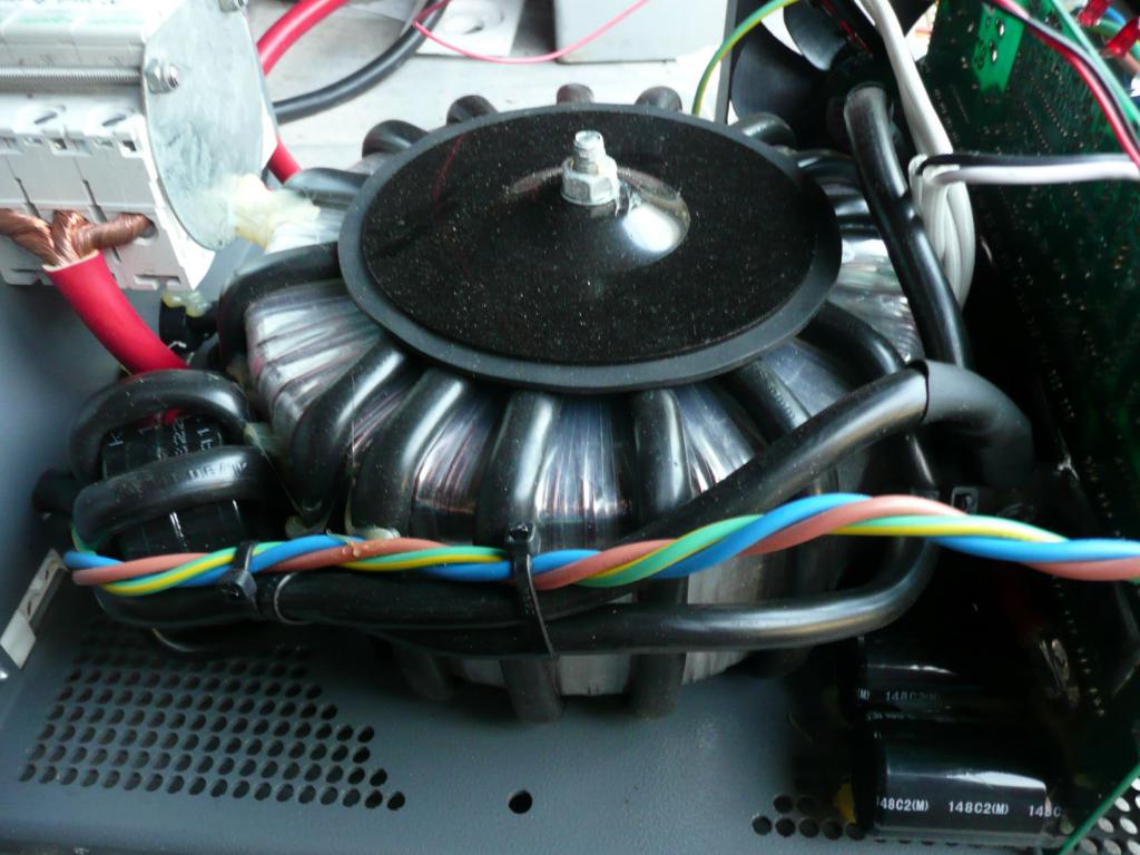

I said I would show some photos of the Latronics Heatsink.

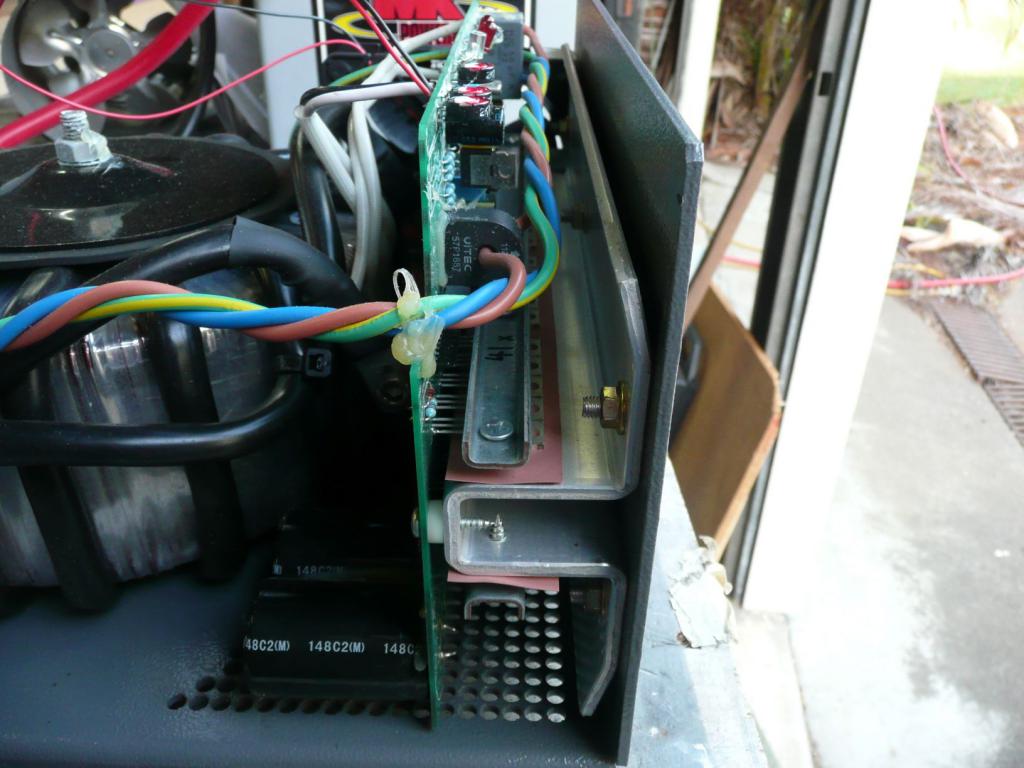

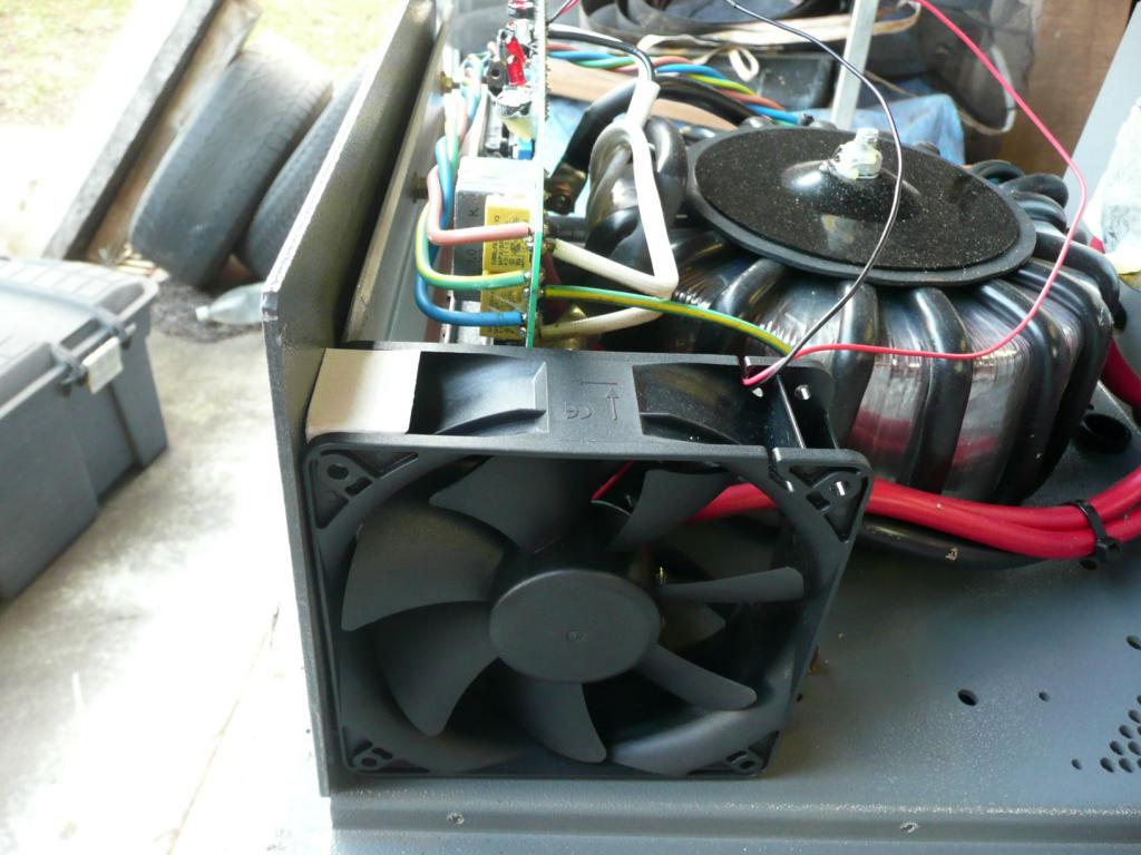

 Heatsinking of a 3kW 24v Latronics.
The unit works quite well and when the fan failed would easily trip on over-heat (electric kettle), but it did so gracefully.  The Fan is now replaced.  As a side note, they were buggers as they pop riveted the fan in, and necessitated that I bring the inverter back to Town - A fan should be field serviceable.  Even then the little aluminium brackets were difficult to re-use.  Luckily a simple little 3d printed part was printed and worked real well - so much I'm going to use it to hold the fan in the WarpVerter.
I took this photo of the Latronics heatsink.  The Al angle next to it is 50x50x6mm.
And inside the Box.
Very reliant on the Fan.
See the White 3d printed part holding the Fan.  A slot in the part fits over some webbing within the Fan.
Another glamour shot
And finally an action shot.  About 120W load.
Andrew

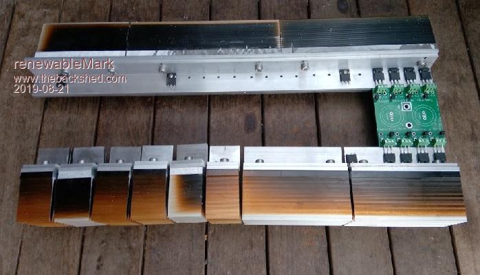

I finally got the heatsinks all done. The way I did these made it VERY fiddly lining everything up compare to an Oz/Madinverter.
Tapping the thread between two layers/thicknesses of angle was fiddly.
I ended up just tapping the bottom bit of angle and drilling out the upper one slightly bigger.
So the fet sits on top, goes through the top heatsink loosely, then threads into the bottom heatsink.
Glad that's out of the way.
Edited 2019-08-21 16:10 by renewableMark
Cheers Caveman Mark
Posted: 06:14am 21 Aug 2019
Its much better to put all the sweat and toil into initially building something really nice that is an absolute joy to work on.
And one of Murphy's laws states that:
"Anything that is accessible and able to be very easily replaced will never fail".
  Quote  I ended up just tapping the bottom bit of angle and drilling out the upper one slightly bigger.
That is actually better.
Heaving down on the screws will press the two pieces of angle together for best thermal contact right under the mosfet, where its most important.
If both pieces are tapped, there may be an absolute minimal gap remaining, which will act as a heat barrier, and that defeats the whole purpose.
De bur all the holes, as I am sure you already have, so the two angles are up close and intimate with each other, with nothing anywhere that might spread them apart.
Edited 2019-08-21 16:57 by Warpspeed

Yeah, that's what I found.
Even really tight clamping didn't help when tapping the threads of the two bits of angle, they always seemed to have a tiny gap which would never get snugged up.
So the solution was to drill out the upper one, that brings them nice and closely aligned together now.
The connection between those two bits of Aluminium angle will remain clean and I'll only put the heatsink compound between the angle and finned heatsinks.

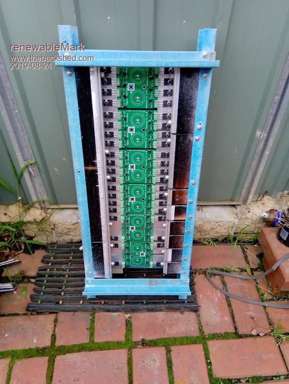

Posted: 06:08am 24 Aug 2019
Thanks Tony, I'll sing out and see if the time suits you.
Got a bit more done today.
Will mount the slides to the locker and the frame next.
Then number it all and pull it all apart to remove all the burrs and filings etc.
It feels very solid the way it is now.
On the reverse it will have some more bars going across to support the caps, might do the perspex sheet with the cap profiles cut out like Tony suggested.
Cheers Caveman Mark
Posted: 07:34am 24 Aug 2019
That blue fibreglass looks like very nice stuff to work with.
I can well believe its all ended up being very rigid.
A couple of heavy duty ball bearing slides, and you are set.
