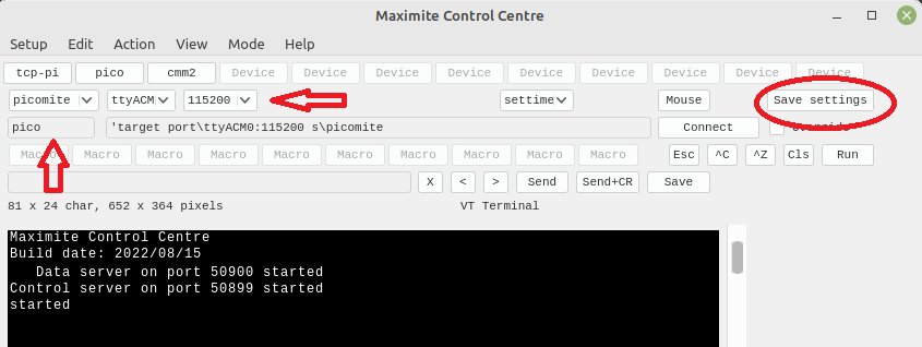

Hi Jim,
What is the envisioned way to "save" the MMCC config ?
I set up VGAmite, ttyACM0, 38400 then connect in MMCC. When I save this config, next power up it is not memorized.
Maybe it is the order in which I use MMEdit.
- I first start MMCC, config it, connect
- Then I start MMEdit, select picomite syntax, and open source file. Then upload and run.
Is this the preferred way of working ? (linux version)

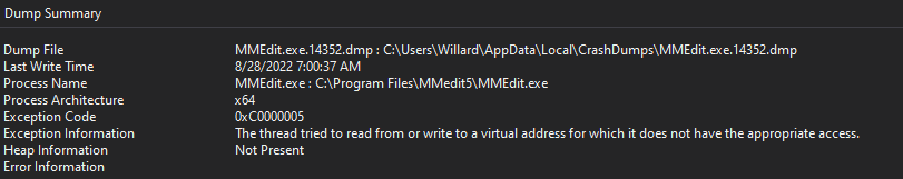

Returning to FM crash
MMCC.inf and video attached.
Latest version. Portable.
MMCC.zip
Video_2022-08-15_175953.zip

I do need to complete more of the help files.
You need to specify 3 things.
Type of device, com port, and port speed (or TCPIP address and port number)
If you want to save the settings for your device, you have to give it a name - in my case it's called 'pico'
Then 'save settings' and it will be added to the next available device in the top row.
The last connected device is remembered so there should be no need to set it again if you only have one device.

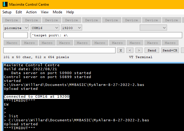

I've been having issues with the latest releases.
When I try to DEPLOY with F2, the MCC insists that my com port changed... (it didn't) and refuses to upload.  Falling back to a version I had from April works just fine.

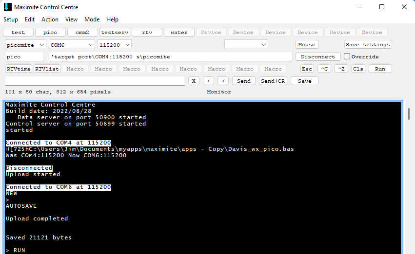

The code that decides to display the "port changed" message is simple:
If currentConnection <>"" And currentConnection <> newConnection
  MMdisconnect()
  notice("Port Changed!"+#LF$+"disconnecting first.",2000)
EndIf
Which means.
If the device is currently connected and the current connection specs are different to the new specs, then disconnect and show a warning.
After that, MMCC will reconnect using the new specs.
I will add a test for Windows users to cater for a change in case (COM to com) but that wouldn't stop a successful re-connection.
I will print more debug information to the terminal window which should help diagnose.
MMCC gets its port information from the first line of your code and if it is not specified there, it use the device specifications in MMCC (to the left of the "connect" button).
It would help if you can post a screen print of the MMCC after a fail. Something similar to this:
I have tried every combination I can think of looking for a bug but there is obviously a sequence I have not thought of.

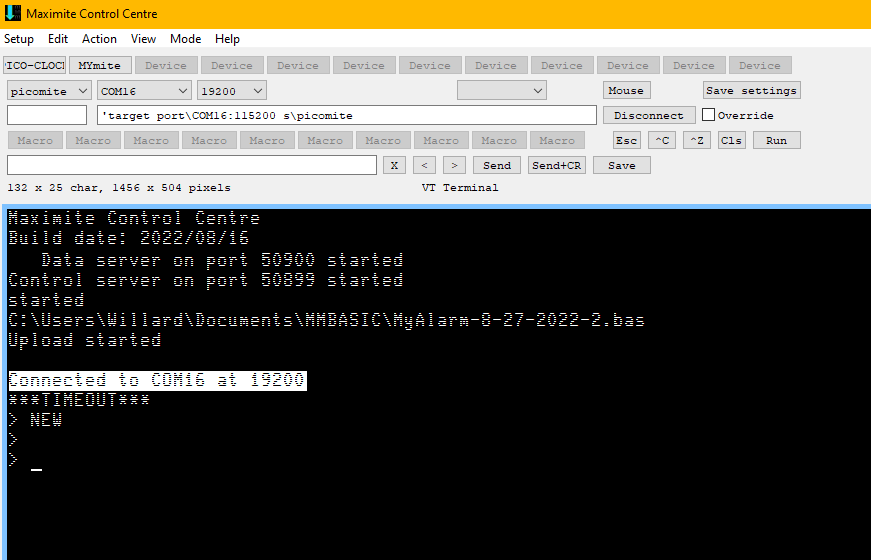

Posted: 11:13am 28 Aug 2022

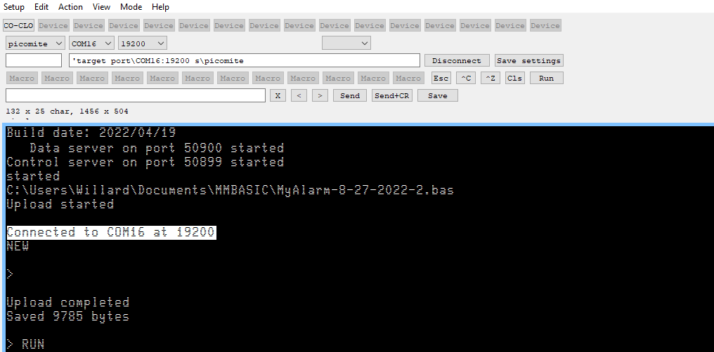

Well, as mentioned...   I get reasonably correct behavior from the earlier release.
So I then installed the 8/16 version again... and I get a slightly different behavior now.  It stopped complaining about CHANGED COM port on deploy... it now just times out.
Was able to reproduce this twice after shutting down MMEDIT and ControlCenter.
Also... If I do a fresh restart of MMEDIT 8/16, and load a program into the editor but then "just goofing" I chose to MANUALLY change the Syntax from default CMM2 to PICOMITE, the program will crash to desktop.
I'm not sure if I need to wipe out persistent settings or not, so maybe that's why I'm getting unusual results.  So, I'm going to do a complete wipe again and re-install.
So... complete removal... uninstall, remove multiple folders... re-install... same thing. TIMEOUT.
Using Teraterm to upload with Autosave works fine... I'm stumped.

You appear to have a port specification as the first line of your program. Can you share that first line with me?
If the first line of your program has (what looks like) a port specs, that has priority over the MMCC settings unless you have "override" ticked, in which sasses MMCC always wins.
When you were having problems with the "port changed" warnings, I suspect that you had different baud rates set in MMCC and your program first line.

Posted: 10:45am 29 Aug 2022
Goofing:  Doing something I didn't *need* to do... but doing it anyway.
And yes, my first line is:
'target port\COM16:19200 s\picomite
and I was relying on that... not what MMCC had a "saved" setting for, for example.
If I make sure that MMCC config and the first line match...
and then disconnect MMCC from Picomit and then reconnect to Picomite
I still get...
Upload started
***TIMEOUT***
...when I select DEPLOY
I'm not sure if I need to mention that I'm using the latest non-vga picomite beta.
I still get...
Upload started
***TIMEOUT***

In MMEDIT, press deploy...
> C:\Users\Willard\Documents\MMBASIC\MyAlarm-8-27-2022-2.bas
Uploading using:  'target port\COM16:115200 s\picomite
Upload started
***TIMEOUT***
I'm stumped...
Again... I can later startup a Teraterm session and do an Autosave upload just fine...
and this was all working a few weeks ago but I was using older releases..
To Be Honest: I'm starting to suspect my PICO is not OK.
CONCLUSION CONFIRMED: It's my PICO.  The PIMORONI PICO LIPO. Different enough to be a problem...

Assuming I follow you correctly.
A 'standard' picomite works OK for you with the latest MMEdit but your 'PIMORONI PICO LIPO' doesn't.
The PIMORONI PICO LIPO does work OK with the earlier version of MMEdit.
I don't have a PIMORONI PICO LIPO to test with so I am doing a lot of guessing.
Assuming you are using the 64bit version of MMEdit, please replace the MMCC.exe with the one in the attached zip and try the PIMORONI PICO LIPO.
I haven't tried to investigate your other issues when you were 'goofing around' because I still don't know what you did.
