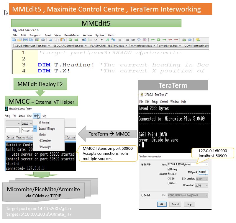

Here is a bit of a diagram I put together showing MMEdit, TeraTerm and MMCC interworking. I find it a very satisfactory setup, with MMEdit managing the code and using Teraterm as the terminal.

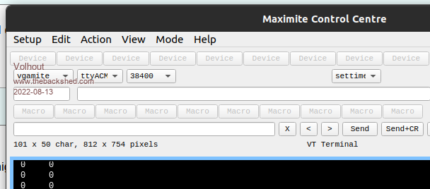

Does the vertical scroll bar move smoothly when dragging it? On my installation, the scroll bar doesn't always work until I resize the window. I will work on that problem.(only a problem on Linux I think)
When I drag the scroll bar, the scroll bar itself does not move at all. It stays in the same position (top of the edit window) but the text scrolls. Looks like the scroll bar is not "live". In the bottom of the window there is an indicator how many lines/characters the document is, that is only updated once you save of load a program, not while editing.

The attached zip contains MMEdit and MMCC, both compiled using the qt subsystem.
There might be a few places where I have missed something out but it should make MMEdit usable again.

Since there where only 2 files in the zip, I assumed these should replace the ones in the normal build, keeping the folder structure intact. So I made a copy of the folder that holds the GTK3 version of MMEdit, and replaced MMEdit and MMCC.

  Kabron said  File Manager crashed with OPTION LCDPANEL CONSOLE
The serial port is far too slow to use the file manager when OPTION LCDPANEL CONSOLE is set but MMCC should not lockup. I will fix that.

  Quote  If I launch FM from MCC started with saved settings or from MMEdit it collapses immediately with MCC.
Only If after starting MMC I reenter all serial settings manually and reconnect, then FM launched correctly.
No problems here.
Can you post a copy of your saved settings?
