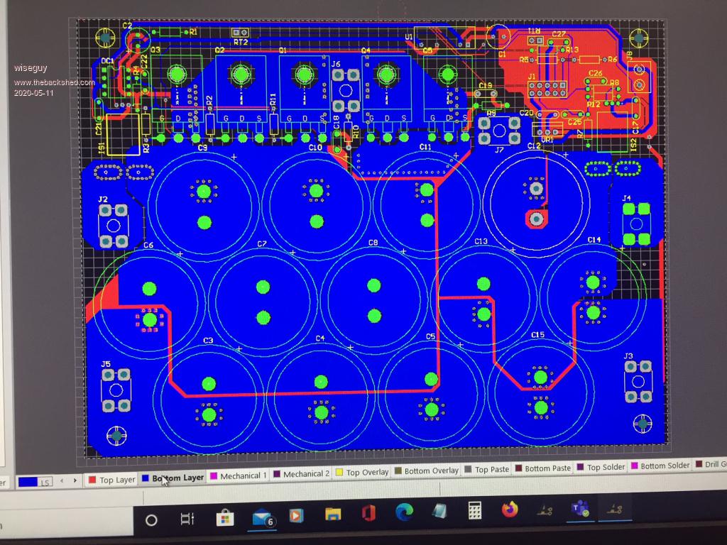

Hi,
Didn't have much time last weekend, my wife is teacher and having a hard time preparing all digital lessons + keeping me and our baby alive, now she's got additional work, because a few classes are given on the school itself... So now she's doing both, so extra work for me in the household and around the house.
About the power pcb V1.1, I noticed the current sensors are drawn on the bottom plane. But I soldered them on the top side. The wire routing is correct when they are soldered on the top side. Also uni-directional sensors could be used the way it is now, Pin 4 (+) is on the input, Pin 5 (-) is on the load side. I'm going to change the footprint to the topside.
The footprints of the screw connectors are also put on the topside now, as they were drawn on the bottom side.
I've changed hole sizes to 8mm instead 6mm to allow the use of those 4mm Allen Screws.
I've changed component values to the ones I've used.
What would happen when I use 1000uF caps? Don't worry you don't need to adapt the code for me, I'm happy @ this moment to regulate my input voltage with a fixed setting, it's very simple but with high overall efficiency.

I started to try to sketch the pcb and modifications....sheesh, and I see Nicks has been working on the original too, was trying to save the effort.
Here is the schematic and sketch if Nicks or anyone wants the database files to suck into easy eda just ask.
Schem.pdf
Sketches.pdf
I wanted 3 Fets for a job - you dont have to load the 3d one, the finished board size is 190mm x 140mm.
I also only used 4 caps for the output - I reckon that is plenty. Just noticed 2 little glitches where tracks join to ground plane, now fixed.
Input from solar on the left output to Bat on right, havent run the rule checker yet - still a bit left to do.
Edited 2020-05-11 19:22 by wiseguy

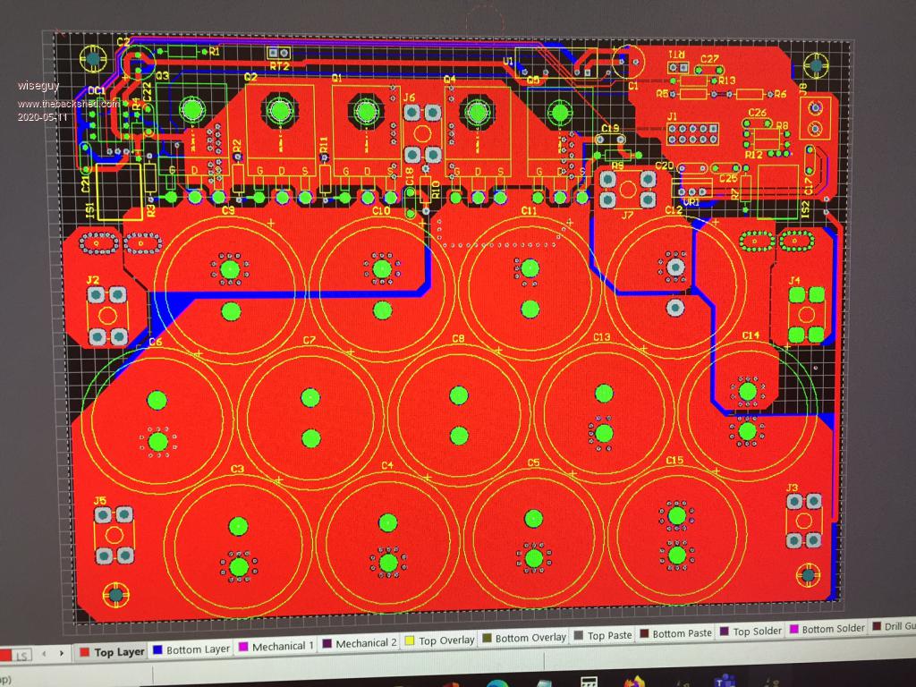

It looks a bit sexier in colour, here are 2 screenshots. I included the separate 12V connector Az asked for. The noisy and quiet grounds are tied together in the upper RHS where a 0.1" and 0.2" spaced pads are allowed for a ferrite bead if needed.
This was definitely more fun than sorting out my workshop.......

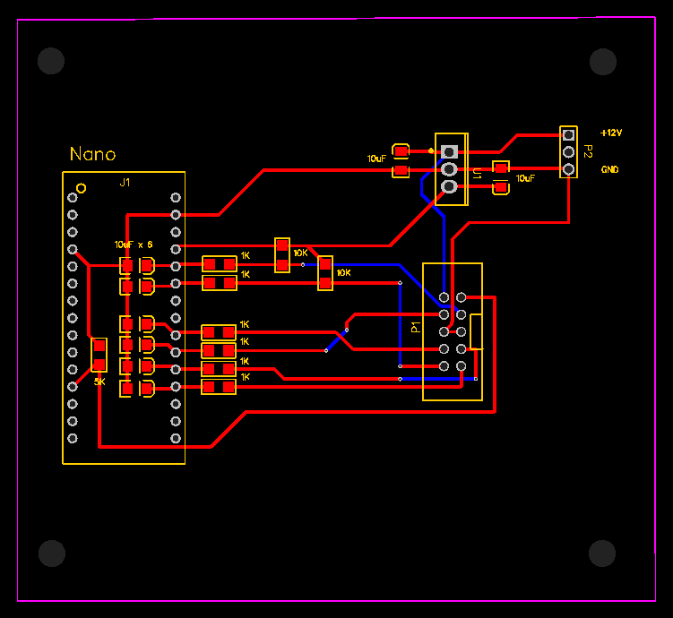

here is the first hack at the brainboard PCB.
I like the very short tracks from the low pass filter to the ADC pins.
All I want, really. The rest just needs to work well enough.

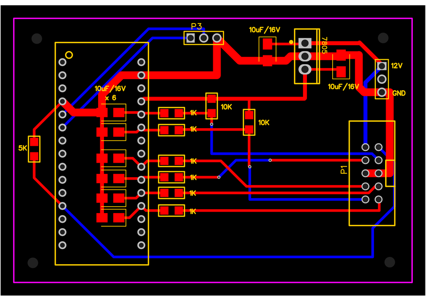

here is a better attempt.
The board is only 75mm x 50mm
$5 for 10, I think I will order them.
There is a connector for 2 user switches. Maybe only need one for EQ.
Just give it 12V referenced to battery ground and go.
Edited 2020-05-12 16:26 by poida

OK Take 2 the first scheme had a fet/diode issue so I added a relay instead.
Good effort Peter - layout scheme is electrically good.

Peter, before you order the PCBs - I will be sending you an email in a few minutes.
There are a few points to discuss first (ie providing) pulldowns on your PCB for the thermistor inputs if they are fed from 5V on the MPPT board ?  And a couple of other things.
