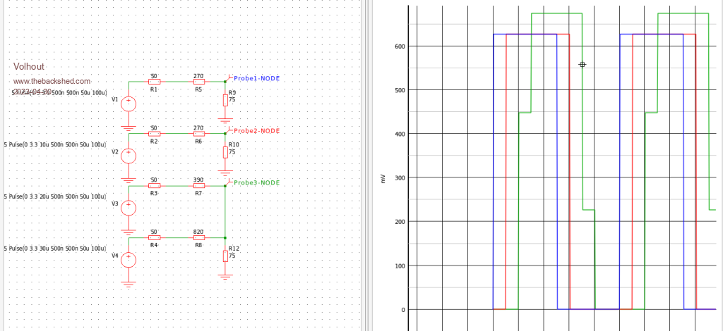

Posts: 6169
Posted: 07:02pm 29 Apr 2023
@phill, martin,
The green levels are actually 0, 1/3, 2/3, and 1 of 660mV.
The blue and red levels are slighly low. A 240 ohm resistor would have been better.
But 270 ohm is a standard value.

Posted: 01:18am 30 Apr 2023
This discussion about the signal levels and palette colours is valuable information.  Is an admin able to extract it out of this thread into one of it's own?  It's sort of polluting this thread for @matherp to resolve bugs prior to the lastest release.
@Volhout, are you able to repeat the analysis using the schematic published in Silicon Chip?  The resistor values are slightly different (220ohm) and there are a couple of diodes in there also.  It would be interesting to compare the results.
Mike
