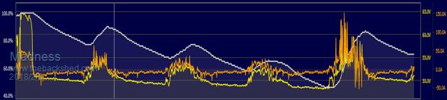

Mark you may find this interesting, Thursday, Friday and Saturday were dark rainy days and we only got enough charge to bring the battery back up 13, 10 and 9 % on each of those days. Yesterday (Sunday) was periods of rain, showers, and sun, the battery regained 43%. We normally drawdown around 20% each night from the 775AH battery the same as the one you are looking at. During this time at the lowest, the battery was down to 48.4V.
This was the biggest drawdown I have had, it has been down to the mid 60's a couple times and back to full charge the next or following day. The point of this post is that it is working as it should and I am very happy with the results of this secondhand forklift battery (that is refurbished with a 2 year warranty). In normal use these batteries are designed to draw down to 20% every day, this would result in a much shorter lifespan though.

Those charts are from my Midnite charge controllers that have an online monitoring website.

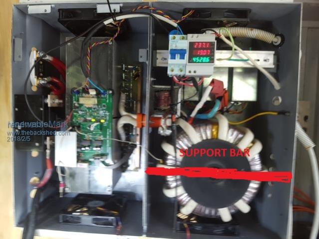

Posted: 08:26am 05 Feb 2018
Hi Mad, thanks for posting that layout pic, I replied here as I didn't want to hijack and mess another thread.
When you mount the toroid side on does it need a support? No one seems to do it, so I assume the answer is no, but it doesn't seem quite right.
The aero sharp is potted with epoxy, I assume people are reluctant to do this as it will affect cooling, I'm also concerned as to how the weight unevenly distributed with a few hot summers how it will affect the windings, both primary and secondary (without being potted).Edited by renewableMark 2018-02-06
Cheers Caveman Mark
Off grid eastern Melb
Madness
Joined: 08/10/2011
Posts: 2498
Posted: 09:58am 05 Feb 2018
Something you need to not forget, if you put a support bar or similar across there and bolt it all together you will create a single short circuit turn in the Toroid. That will result in lots of tears.
Apart from that it is simply not needed. I had to remove the original bolt and move it a little towards the centre of the case to allow room for everything. I got one of the epoxy inserts and ground off some of the more bumpy bits put a 10MM bolt through it and put one of those nuts about 50 MM long on it and tightened it down. The top half is another epoxy insert with a washer and bolt in it screwing into the long bolt. The Aerosharp cases are 2mm thick and are very rigid, there is no way that toroid is going anywhere.

Boppa
Joined: 08/11/2016
Posts: 816
Posted: 04:30pm 05 Feb 2018
If you needed extra support for some reason like a thin case, using a piece of plex or even a pvc conduit flattened out at the end would do
Just not anything conductive as that would be a shorted turn yeah lol
renewableMark
Joined: 09/12/2017
Posts: 1679
Posted: 09:14pm 05 Feb 2018
Thanks Boppa,
I'm going to use the Aero sharp cases, so apparently, nothing to worry about. When the new bolt goes in possibly put a steel strip on the back outside where the bolt head goes and weld that to spread the load and strengthen it up. And yeah maybe a thick bit of perspex on the front.
