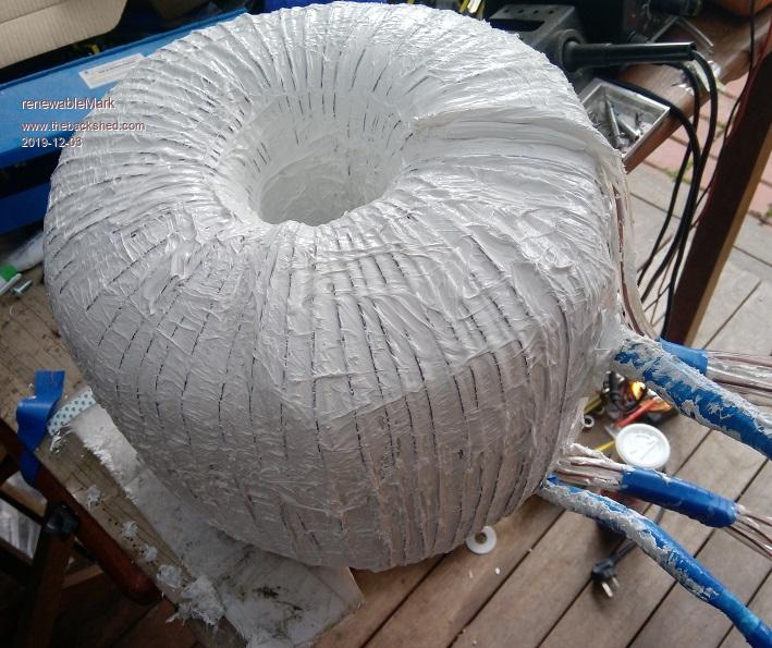

That will be fine Mark.
One pass through the hole counts as one full turn.
Whatever happens outside of the hole makes no difference at all.
As you work your way closer to the centre, overlapping layers have less and less effect, so its all good.
Probably the best thing to use for insulating individual wires is small diameter heat shrink tubing. Its thin, withstands high temperatures well, and makes excellent insulation.

Posted: 10:18am 03 Dec 2019
The third winding had to be done with a small solder spool.
Fourth one couldn't even be done with a spool, it had to go back on with a shuttle.
Very time consuming to get each turn on loosely, then hand smooth the wire and then pull it tight, then try and keep it tight while the next turn goes on, do that 128 times and it gets pretty tedious.
Fourth wind went around the core two times with a poly and mylar layer between which added time.
So this was a very time consuming transformer to make, reckon I could have done four normal ones in the same time. Hope it works well

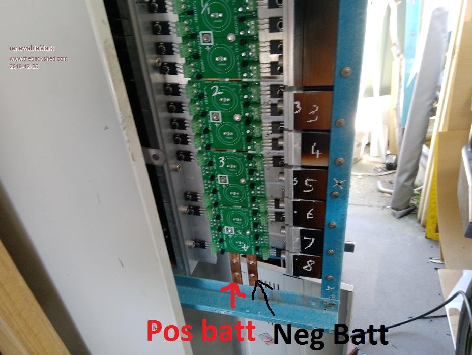

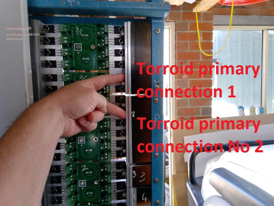

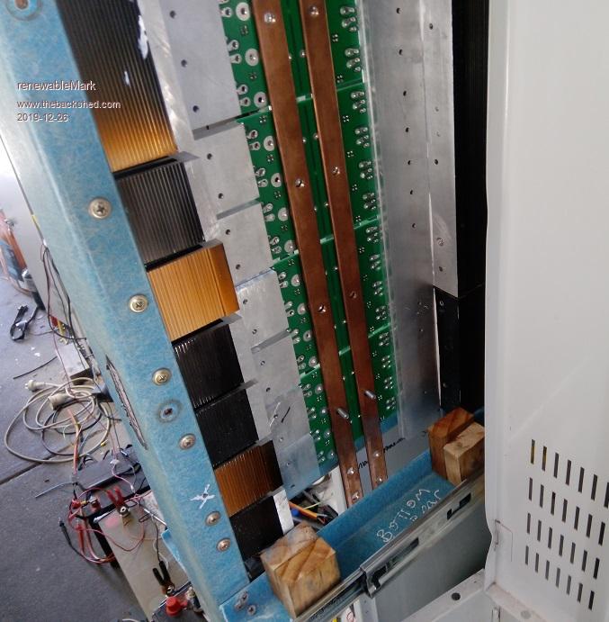

OK got some time up my sleeve now.
Just want to make sure of the connections before I start cutting cables.
So at the back will be these bus bars, caps will be fitted after testing.
Bus bar battery input connections here.
And then the primary connections from the torroid go to the two halves of the heatsinks on the right side.

mackoffgrid
Joined: 13/03/2017
Posts: 460
Posted: 06:19am 26 Dec 2019
Looks Good Mark
The connections you indicated are correct.
Andrew

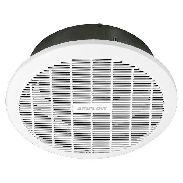

Posted: 10:57pm 26 Dec 2019
That should work well Mark.
A lower cost alternative might be an ordinary ceiling exhaust fan to blow some cold air into the lower half of your locker and stir things up a bit, combined with one or more strategic holes at the back to let the hot air out ? Bunnings have such a beast for about thirty bux.
It may be a bit noisy, especially when bolted to thin sheet metal, but I doubt if its ever going to come on. Not familiar with those tall tower fans which may be better anyway.
If you want to make some nice clean perfectly round three inch ventilation holes in your locker, I have a three inch sheet metal punch.

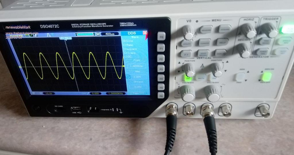

Posted: 06:48am 06 Mar 2020
Got the new scope, it has in built sig gen.
Have to work out how to use a digital one now.
Cheers Caveman Mark

Posted: 07:45am 06 Mar 2020
Poida, it's a 2ch the left 2 are gen output and sync trig.
I only need 1 channel to look at, that's enough to confuse me.
This is what I got
Cheers Caveman Mark
Off grid eastern Melb
Posted: 08:29am 06 Mar 2020
That is very good value, it has a lot of features that will probably take a fair while to become truly familiar with.
I have had my new CRO for a couple of months and have barely scratched the surface of what it can do. To be completely honest its all a bit daunting.
