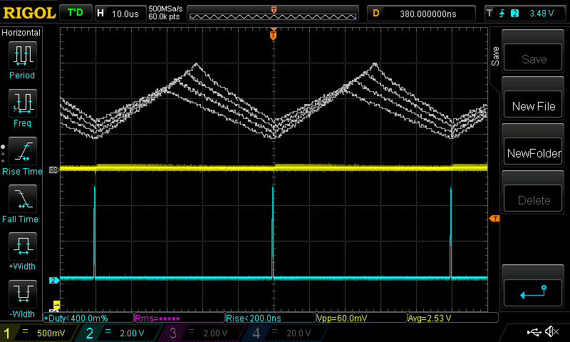

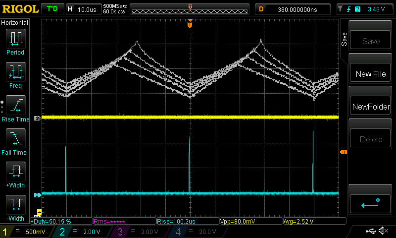

Below are 2 inductors, with power levels 1500,2000,2500 and 3000W
110V inout, 20kHz, approx 1 Ohm load
White traces are the 4 power levels.
Their scale is 25Amp/div, with zero current where R8 marker is located.
We can see how at 3000W things have not got out of control with potentially damaging current levels passing through the MOSFETs. Things seem to be OK to me
right up to 2500W which is the design limit. That both inductors are OK to 3000W indicates that there is some safety margin here.
The "good" one, about 36uH
This is the latest one I made using the $26 core and 1.6mm gap
The latest inductor measures 39.6uH using the LCD meter.
