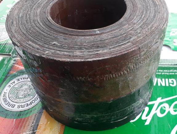

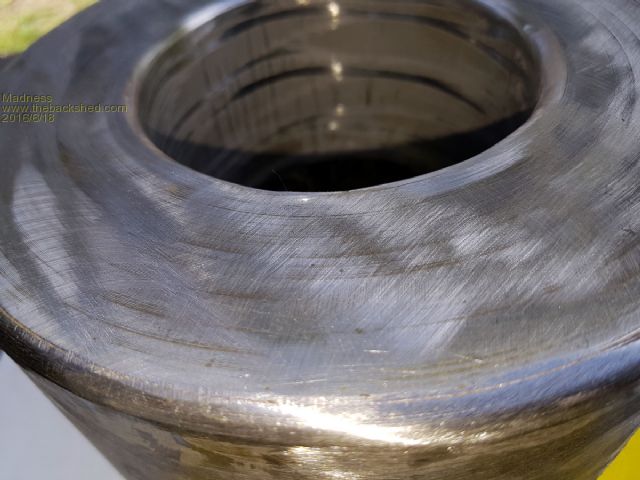

Does it make it much easier grinding the ends round?
I was contemplating putting another layer of cloth tape or two to soften the edge a bit.
Also what spools has everyone been using? Figured I'd get some dowel and mdf to make some up.
Cheers Caveman Mark
Off grid eastern Melb

Well, there seems to be two schools of the art of re winding toroid cores.
One uses small bobbin type spools (like you are planning) and wrap as much as possible wire on it. Of course, you are limited by the diameter of the available toroid hole (it gets smaller as you progress) and what length spool you can easily pass through.
Pro: you can pull the wire very tight with this method.
Con: you are limited how much wire fits on the spool, splicing wire mid turn is a nuisance IMO. You also further work harden the wire as you wind it tightly around the bobbin.
Other method, use a large spool (hand fishing cast reel, cut to open), works well with single core. A still larger reel required for double stack, about bicycle rim size. This holds more than enough wire at a large diameter for winding a double stack.
If this is used cleverly two in hand can be wound simultaneously, I did that successfully.
Only con I can think of: harder to pull the wire tight unless a wire puller is handy.
Suggest you get a cuppa or two and read all the posts on toroid rewinding. This may take some time but is, IMO, well worthwhile in the long run.
Lastly, YES its *much* easier to pull wire tight around a rounded edge.
Remember, the first idea coming into your mind is not always the easiest in the long run, your wire straightening method comes to mind

I ground the corners off with the angle grinder then used a flap sander thing in the drill to smooth it off and make it round.
If you don't round it then you have to get the wire to bend tightly on the sharp corners, a machine might wind it easily but doing it by hand it is easier with round corner and then there is less chance of short.

Had to work today, so not much progress.
Just fibreglassed the two halves together.
With all the different builds and the different progressions of the builds, it's a tad confusing deciding on a number of turns.
Core thickness is 53mm, two high it's 140mm =7420 /2800=2.65
240/2.65=90 turns
Now why does that sound wrong?
Edited by renewableMark 2018-01-21
