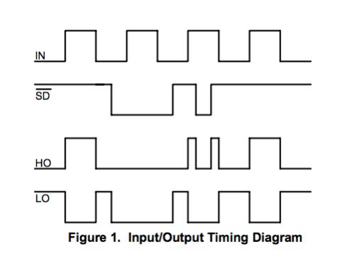

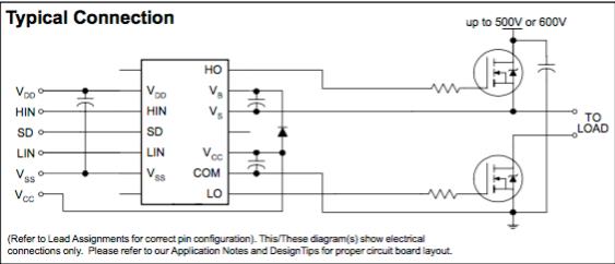

Warpspeed, are you sure about this?
The IR21844 is a 1/2 bridge driver as described by IR.
here is the design guide:
The two wires labelled "to load" are connected together and make up one of the two
terminals to which we connect the primary winding.
here is the logic diagram:
You can see the effect of Shutdown, when low, no outputs, when high, outputs are enabled depending on the state of IN pin.
When shutdown is not in effect, that is, pulled high,
LO and HO reflect the state of IN.
HO = IN
LO = compliment of IN (or NOT IN if you like)

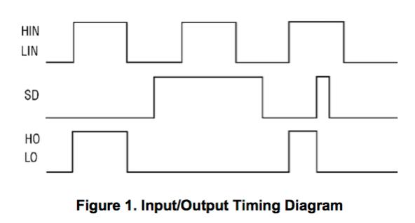

The IR 21844 is different to the IR2110S as used in the EG002 where
both HO and LO have independent inputs (HIN and LIN).
We need to provide dead time with these two signals, HIN and LIN
and drive one in opposite (logical NOT, or compliment) to the other.
here is the logic diagram for that part:
and the design guide:
Notice it has the two "to load" terminals as well.

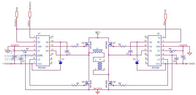

So, Tinyt, connect PWMA = pin 9, PWMB to pin 7 and do this:
and it will be the same as my prototype. I use only one choke, not two.

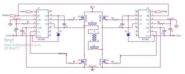

tinyt
Joined: 12/11/2017
Posts: 564
Posted: 04:34pm 17 Apr 2018
I hope I got it this time:
poida
Joined: 02/02/2017
Posts: 1501
Posted: 07:53am 18 Apr 2018
I like it. It is similar to what I have running on the bench.
When starting it up, only install one mosfet each leg, use a bench power supply
with current limit. When running my prototype with 27V DC supply into a 3000VA toriod
I only need 0.5A under zero load.
The finer points of the power bridge design I will leave to others, except to say that you probably need something like 4R gate drive resistor, 10K R from gate to ground and a small diode permitting fast switch off, parallel to the 4R resistor for all 4 switch legs.

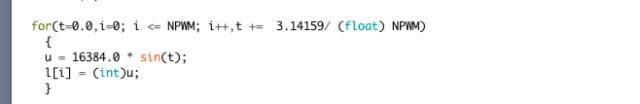

where it has
for(t=0.0,i=0; i <= NPWM; i++,t += 3.14159/ (float) NPWM)
u = 16384.0 * sin(t);
l = (int)u;
change it to
l = (int)u; // <- this line
It now compiles and runs correctly.

Ahh, something in the forum posting code is removing square brackets.
I included them in the text I wrote but those square brackets were removed.
so, to avoid any further issue I place a screen capture of the code.
So, backshed forum software, remove these square brackets!!!

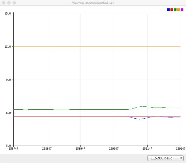

Oz, I use the Arduino program's "serial plotter" function frequently.
It's very good to see variable's changes over time.
put in setup()
Serial.begin(115200);
and put in loop()
Serial.print(ch0*10.0);
Serial.print(" ");
Serial.print(ch2*10.0);
Serial.print(" ");
Serial.print (vpwr/100.0);
Serial.println("0 12");
this will give a real time graph of the three variables
AC set point, AC output and PWM modulation
Because sending data out the serial port takes some uninterruptable time
the inverter runs a little unhappily.
When no serial data is sent out, the inverter runs smooth as silk.
the graph looks like this for my system:
Blue is AC output voltage
Red is AC voltage setpoint (from potentiometer)
Green is PWM modulation
The 0 and 12 set fixed minimum and maximum values for the plot, otherwise
it continually rescales and changes offsets.
The bump is due to me switching on a load, causing more PWM modulation and an error in the PID closed loop that was soon corrected.
Edited by poida 2018-04-19

I think you are getting the idea how I use this table.
I set up 2 timers.
TIMER2 is to call the TIMER2_OVF_vect Interrupt service routine 100 times a second. Each time this code is run, it toggles f50 variable which can be either 1 or zero, so it starts 0, goes to 1, back to 0, back to 1...
Each change happens at 100Hz.
F50 is used to decide if we use the sine table AS IS or altered.
TIMER1 is used to output the 20KkHz PWM with the desired duty cycle.
After setup() runs, TIMER1 is running with a zero duty cycle.
It keeps running forever. We can stick into a register a value that defines the duty cycle. In this case the register is OCR1.
OCR1 can be anything from 0 to PPWM (which is currently 800)
if we put 1 into OCR1, the duty cycle now becomes 1/800
put 400 into it and it's 400/800 or 0.5 or 50%
Depending on the value of f50, we put the current contents of the sine array into OCR1 or we put (800 - sine array) into OCR1.
This way we get a sine wave or (1 - sinewave), needed to produce a sine wave when we subtract the 50Hz square wave from it.
Each time TIMER1_OVF_vect code is run (at 20kHz) the counter we use to index the sine array is incremented. No need to check for overflow, it never will - the counter is reset to zero each time TIMER2 code is run.

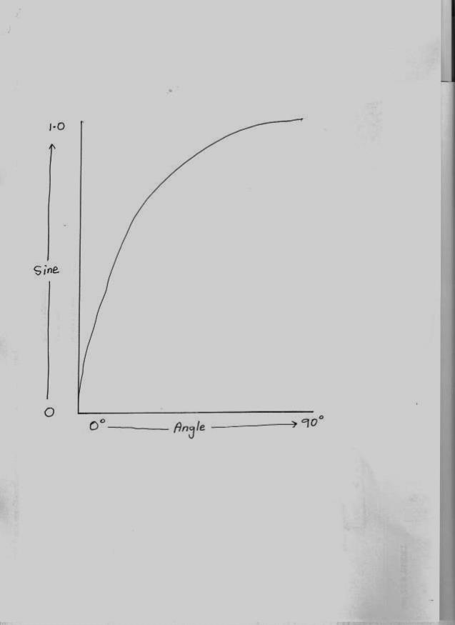

Being rather mathematically and software challenged myself, I have a question for the math junkies that hang out here...
Its pretty straightforward to find the sine of an angle, there are published tables and many on line calculators that do that directly to great precision.
But I want to do it in the opposite direction.
How do I find the sine angle that corresponds to a known magnitude ?

Warpspeed:
you want you use the C function
asin()
it returns the angle in radians of the arcsine of the supplied argument
Some environments don't have full math support. Then there are formulae that
give arcsine from combinations of arctan and simple math.
If your situation has the asin() function but you need it to run fast,
I would use a lookup table plus a little code to determine which quadrant you are in.
Start with a table 0 to 1.0 corresponding to 0 to 90 deg
j=0
for (th = 0.0; th < 1.0; th += 0.01)
j = j + 1
lookuptable(j) = asin(th)
code could look like:
v = sine of angle
float fast_asin(v)
if (v < -1.0 || v > 1.0)
return ERROR
if (v < 0)
return (- lookuptable(v * 100))
else
return (lookuptable(v * 100))
this code would need 2 floating point compares, one FP multiply one FP to int conversion and an array lookup.
Of course there is a problem for arcsin(), there are two different angles that give the same sin() for any span of 360 degrees.
