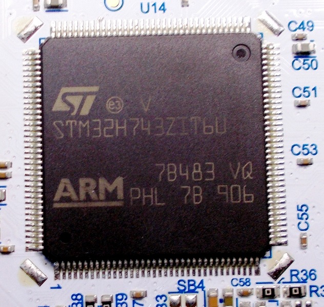

Can you check the version of the H743 on the Nucleo. Next to the ST logo on the chip there should be a letter V or Y

KeepIS
Joined: 13/10/2014
Posts: 2292
Posted: 12:08am 13 Jul 2019
Managed to get photo.
PS2 sockets for case mounting are getting harder to find, and If I'm going to attach something with a lead, then it may as well be a small android or win tablet with a terminal program.
I've found when I need to do any field testing or changes, once I get the USB port to initialises, I set CPU back to 400 MHz via the Keyboard and the Keyboard then initialises every time at reset or power up, once changes have been made I set the CPU back to 480 MHz.
