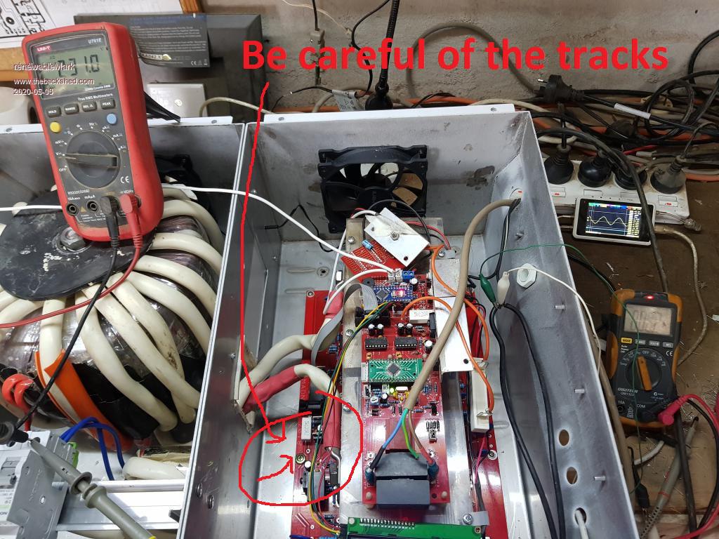

If I remember correctly, the combined window area of two Aerosharp cores produces a hole 70mm x 20mm.  In theory 14 turns of 10mm outside diameter round wire should fit through that, and it is possible, but only just. Twelve turns might be a more realistic expectation.
I found some old underground power cable, but it seems to be 7*1.5mm strands which only works out to around 13mm2. This has an outside dia of about 7.5mm, so I managed to get 2 lots of 9 turns into the core. But I dont think this will suffice :(.
Works well with it, though I still dont have a battery to test it properly and already managed to blow up a set of FET's when the input voltage sagged.
Allan

Try this type of transformer if you don't like the one you're using, that type is very touchy with the adjustment.
I think There are a few nib spares in my shed if you want one quicker than china post.
Also I can't see great detail from the pic, but just be careful of the tracks and your mounting screws.
Cheers Caveman Mark

Thanks Aaron and Mark. It got on the backburner again when I couldnt source a battery, but I plan now to test it out with the caravan batteries and some spare vehicle donations.
One problem I have not been able to solve is how to connect the battery in to the inverter. It was while searching for a solution that I came across the thread with the transformer problem mentioned. I also saw Marks thread about his caravan inverter in which he used some simple terminals thru a piece of plastic sheet. I was thinking about using some brass bolts/threaded rod through some insulated material and then ring terminals on either side, but threaded brass anything is like Unobtainium and as dear as poison.
Allan
Posted: 12:04am 03 May 2020
Steel bolts will work just fine bolted through some insulating material. That is what I am now using on my inverter after a plastic Anderson plug melted.
Use large flat washers either side of the insulating material, so you can really heave down on those bolts and get them really tight without everything sinking into your insulator.
What can happen is everything runs a bit warm and the insulating material can compress slightly over time, and the bolts become a bit loose.  That creates more heat and its all down hill from there....
Use high tensile bolts, big wide washers, and it will give you no trouble.
Mark is quite right about those screw heads being very close to the pcb tracks.
Check out flea-bay, you can buy 3mm nylon screws, 3mm nuts, washers, and plastic spacers.  It removes any doubts about something on the pcb shorting down to ground.

Posted: 09:32am 11 May 2020
I see in your pic you have fitted the std 2 caps (black ones at the end of the control board).
Ideally you need to tune the torroid for 75Hz and place the cap/s across the 240v output of the torroid, it will work on the control board, but it's better across the output of the torroid.
That's where those connectors in the link above become handy.

I have been thinking about how to make up something to 'tune' the torroid after seeing your discussion with Warp on another page. I had also been wondering what those 2 capacitors were for  on the MAD control board, and it never occurred to me to link the 2 thoughts  .
I finally got to drag the batteries out of the caravan and fire up a bit more load on the inverter. Managed to run my 2400W fan heater without any problem, though my battery connections caused a bit of input voltage sag the output was rock solid.
I only have 1 FET per leg ATM and there didnt appear to be any heating at that load, but I didnt run it very long for fear of a voltage dropout.
I also checked the idle load and it seems a bit high.
With the EG8010 disabled by switching pin6 (SPWMEM) low, I read 0.06A
With the whole system running, but no load connected I read 0.9A.
There is a bit of transformer "rattle" when the load is less than about 50W but is perfectly fine at 2400W, so I dont think its any problem.
I also notice a lot of high frequency noise pretty much everywhere I look and cant imagine how the EG8010 manages to maintain the output with such noisy feedback.
