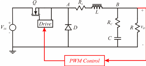

The failure mode is when the main switch turns ON, pulling the cathode of the diode up to Vin and pumping current into the inductor. There is a likelihood of some large amplitude ringing of this point in the circuit. This point (A in the below diagram) is the Source of the MOSFET. Sometimes the voltages of this ringing can exceed the MOSFET Vds rating.
The ringing is related to the diode reverse recovery process.

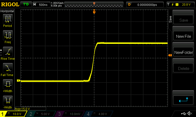

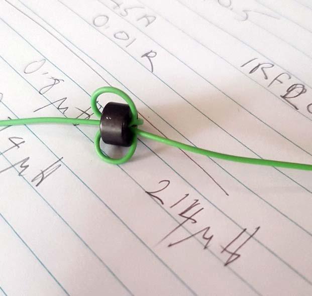

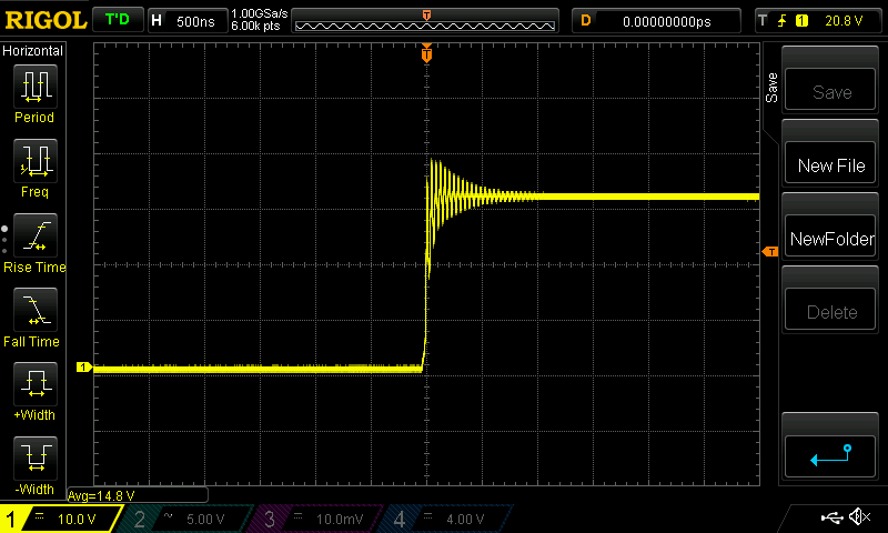

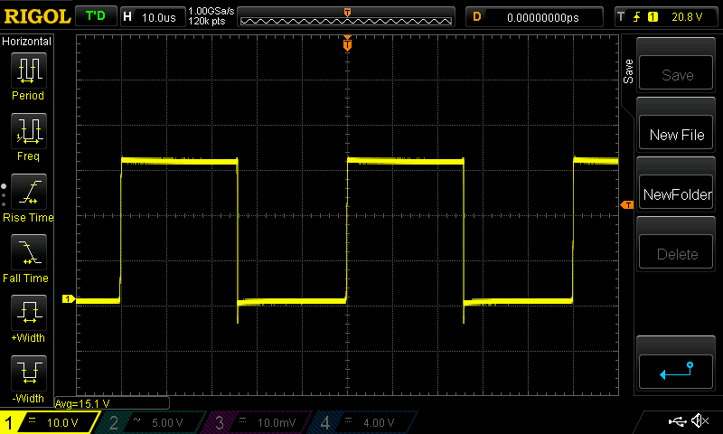

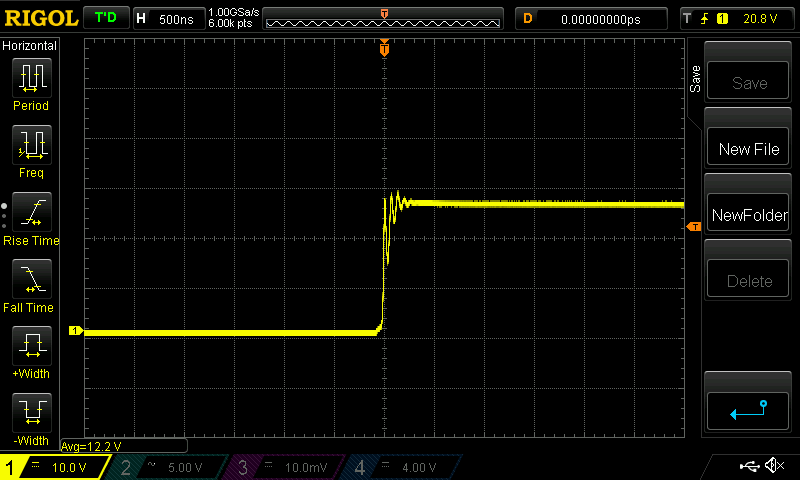

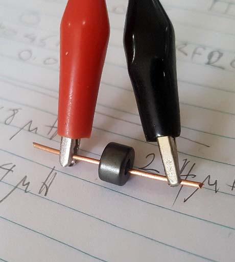

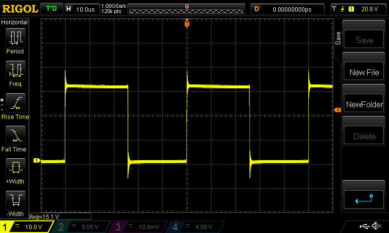

Below is the result of testing 3 situations, changing one thing only.
#1 is no ferrite bead on the Source pin of the MOSFET
#2 has a large ferrite bead
#3 has a rather smaller bead
I show the voltage at point A when running at 5A, 12V output with 30V input.
First is no ferrite bead.
and closer in time, showing the large amplitude ringing
now with the large ferrite bead
no ringing at all
and the much smaller bead
close up
I found that the amplitude of the ringing was proportional to the output current.
I wonder how big it would get when driving a 45A output? This is what the point of this post is all about.

I am firming in the choice of having these large ferrite beads on the Source pins of the MOSFET in the charge controller. Once the PCBs arrive I can test this idea in a larger power situation. Maybe the ringing will appear with much larger currents and voltages?
I planned on using OnSemi's FDH055N15A and the IRFP4321 in the two controllers I will build. These are rated at 150V. With an input of 110V, only 40V of ringing might be enough to over volt them. Maybe the ferrite bead will be enough.

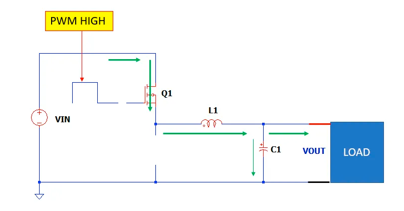

Let's see what the average current through the diode will be.
Most sources state the diode's I(ave) = (1-D)*I(out). One source for this equation is here
The charge controller's specs are 45A output, 90 - 100 V in, 55V out, 2475W output
The duty cycle is Vout/Vin so D = 0.5 approx.
I(ave) = (1-0.5) * 45 = 23 A
Using the HY4008 body diode, we have a Vf of 0.8V at 100A, with the gate tied to the source. The power loss of a diode (ignoring all but DC conduction losses) is due to the voltage drop, Vf. The power loss from the 23A average current will be 23V x 0.8A = 18 Watts
Where am I making mistakes?
The diode does not see only DC, there are current peaks and even then, the diode will still dissipate heat from the Vf x current relationship. Which has no square or cubed terms in it. Ignore also Vf dependency on temperature for now. We can go hard and determine the RMS current if you like but the resulting number will still be so small
as to be insignificant in my view.

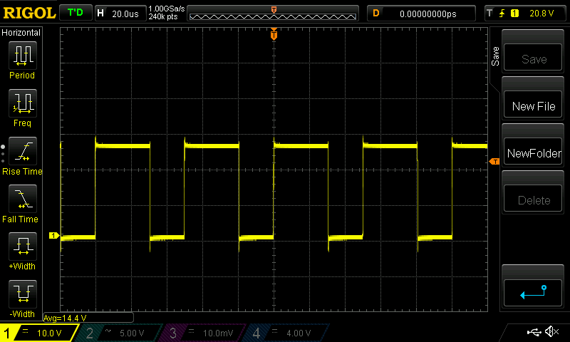

I think it's going to work out fine using the HY4008.
I will test beads on the diode cathode leg. Maybe tomorrow.
The beads are to be used to protect the MOSFETs from over voltage. I do not care if it costs a little power or makes a little heat.
A final note: Eventually the PCBs will arrive and then I build one using the HY5110 100V MOSFETS. This will be enough voltage headroom to do some high power testing.
The required 150V MOSFETS are awaiting air freight from UK to AUS. COVID19 will probably prevent me getting them for months.
Edited 2020-04-06 01:50 by poida

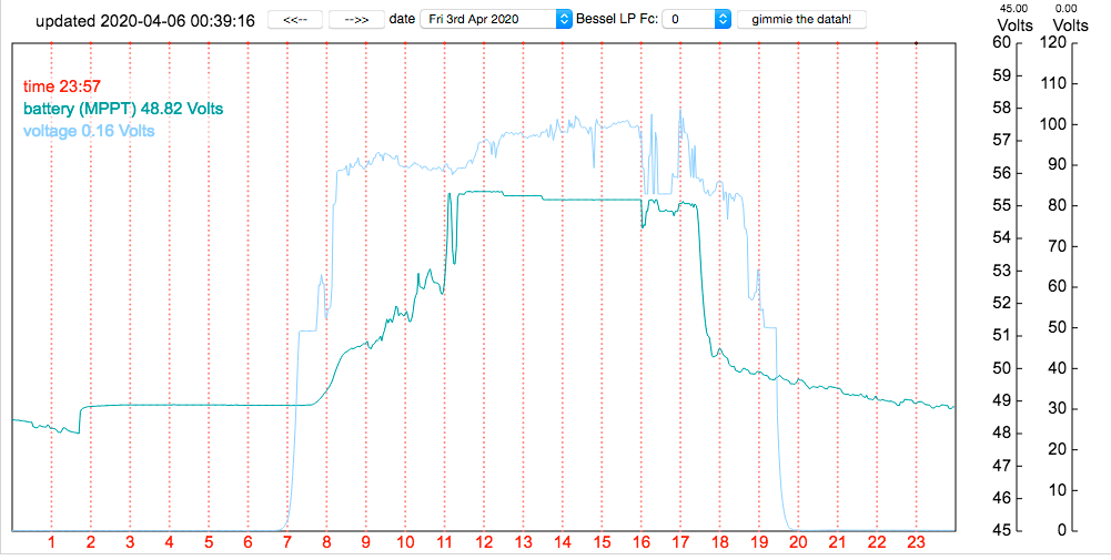

https://pdf1.alldatasheet.com/datasheet-pdf/view/1146879/HUAYI/HY5110A.html
I think it would require some caution about the max dc input voltage never exceeding the 100v limit. But otherwise a rather nice device.
We may need to think about having minimal loading on the solar panels after the battery is fully charged in a clear blue sky, and cloud edge effect momentarily creating some abnormally high high dc voltages.
We might be looking at a system using strings of two 24v panels in series, with max rated open circuit voltage about 42v to 45v per panel, and peak power voltage around 30v per panel. At full power it would be converting 60v solar to charge a 48v nominal battery, possibly at up to 56v.  That could be made to work very efficiently.
A system with strings of three series connected 24v panels will easily exceed the 100v maximum rating of the mosfets under no load conditions.
The estimated diode operating conditions sound pretty right to me, and diode power dissipation should be almost proportional to dc output current.

Looking at
it shows the current path when the MOSFET is switched ON. I then choose to switch OFF the MOSFET and leave it OFF due to Vin > design max.
I think we will eventually see the MOSFET Vds become (Vin - Vout) as a maximum value.
If Vin = 100V, Vout = 50V, Vds = 50V and so all is OK for a 100V MOSFET.
If Vin = 150V, Vds now is 100V and so needs some disconnect protection for the 100V device.
The disconnect process will occur under low current, because the CC firmware will have already stopped PWM. I think a series MOSFET is ideal for this and place it on the Vin DC negative input to permit CC DC ground relative gate drive.

Posted: 01:50am 06 Apr 2020
  Quote  If Vin = 100V, Vout = 50V, Vds = 50V and so all is OK for a 100V MOSFET.
Unfortunately that is not true.
It is certainly like that until the mosfet turns on for the very first time and puts some stored energy into the choke.
When the mosfet subsequently turns off, the stored energy in the choke causes the flywheel diode to conduct.
When that happens, the voltage at the junction of the diode and the mosfet source, gets pulled down to something like minus one volt, or one diode drop below ground.
There may then be about 101 theoretical volts between the mosfet source and drain.
So the mosfet absolutely must be rated for the full max dc input volts plus some suitable extra safety margin.
That then becomes pretty limiting as to the choice of suitable reasonable cost mosfets.
Edited 2020-04-06 12:10 by Warpspeed

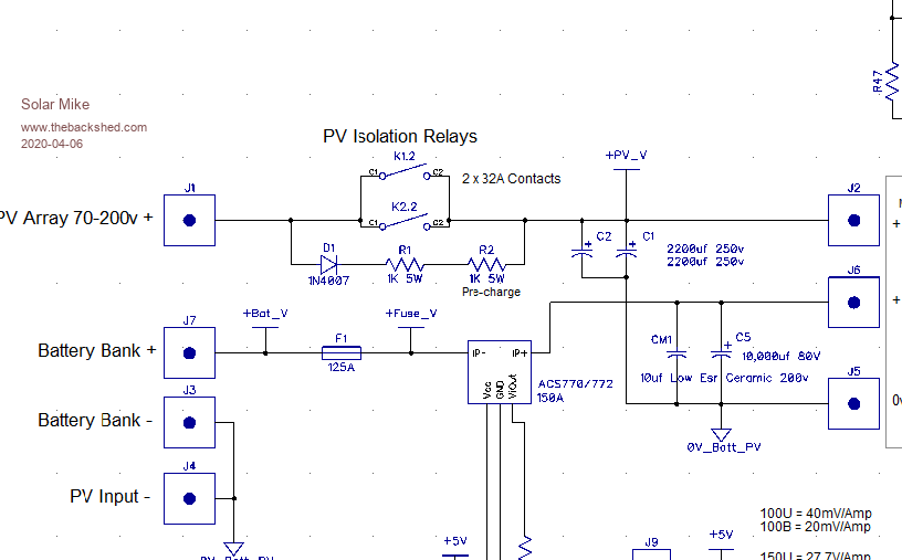

  poida said   ...Commercial CC have the capacity to disconnect either the input and/or the output when the input or the output voltages are exceeded. I suspect this is done by a series MOSFET, between Vin terminals and bulk caps, and another series MOSFET between Vout terminals and output filter caps. I doubt a relay is used since the high DC current will weld the contacts together.
Hi Poida, many of the top higher end mppt controllers use a relay as the disconnect between the PV panels and the battery bank, I would not recommend using a mosfet combination here due to the susceptibility of shorting out on high voltage spikes (eg lightning surges).
If you look at my posts for an Experimental Multiphase Mppt controller Here, near the end of Page2 are the PDF schematics, showing how I have implemented this feature.
Essentially the high current relay contacts have in parallel a couple of resistors that enable slow charging of the main caps, after the CPU has detected high enough voltage on these the relay is closed (no huge current surge) then mppt starts with gradual duty cycle increase. For disconnect eg at night, the mppt duty is set to nothing and the relay opened. The relay is never used to disconnect with power through it, would require an expensive vacuum relay for this purpose.
Mike

nickskethisniks:
the large ferrite bead is 7.8mm outside diameter x 3.1mm inside diameter x 4.8mm high.
Inductance is 214uH with 3 turns.
Here is how I tested it using the BK precision 879B LCR meter at 10kHz.
When I test it like this
I get 10.8uH at 10kHz
I hope this helps.
Solar Mike
Joined: 08/02/2015
Posts: 1255
Posted: 03:34am 06 Apr 2020
  poida said  Thanks Mike for the clue. What happens when the PV array supplies more than design voltage?
I use a TVS diodes on the input PV to limit any voltages (by shorting out and blowing input fuse) that would exceed the max design spec, eg bulk caps may be 80v, 100v, 160v 200v, 250v etc, mosfets common max = 80, 100, 150, 200, 250 volts. You want to use devices with a min of 20% voltage margin over expected limits for reliability.
It is always better with a new design to get it running at a lower voltage, then measure the various higher voltage spikes etc, add additional RC suppression if required, then scale these spikes up for the final working voltage, so you then know what mosfets spec to use for long term reliability.
Mike
