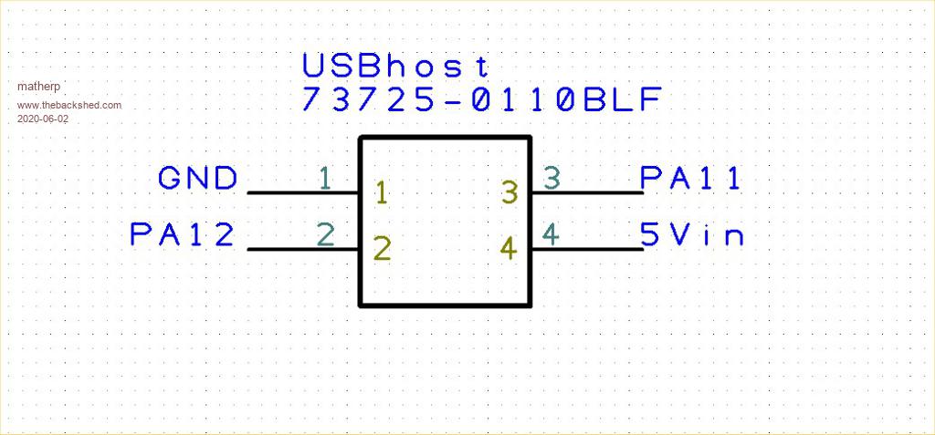

Don't know if this has been mentioned, but the Circuit in the constructors pack shows the USB A (CON 2) connector with PA12 and PA11 transposed. I'm mucking around in the workshop with a wave board and had to transpose the connections to get the Keyboard to work. IE PA11 is next to the 5v pin. PA12 is next to the ground pin.
Mike.
Posts: 11930
Posted: 10:50am 02 Jun 2020
Mike - thanks for the report. The schematic in the construction pack is incorrect, PA11  is next to 5V
Edited 2020-06-02 20:54 by matherp

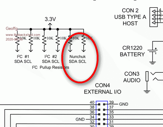

  Quote  Sorry to be a pain but the construction pack schematic does not show the 10K pullup resistors on the Nunchuk lines to the connector.

The construction pack schematic still does not show the 10K pullup resistors on the Nunchuk lines to the connector. The manual mentions that they are available as PINs 43 and 44, maybe that could be shown on the schematic also?

Posts: 3368
Posted: 12:22am 06 Jun 2020
The pullups are shown on the schematic... however I will agree that they are not obvious:
___________________________________________________________________________
Thanks for the references to "Using the I/O pins".  I have removed them and updated the download.
  Quote  Also there is no Electrical Characteristics section to describe the capabilities of the I/O pins, power supply and so on.
Quite right (maybe later).
