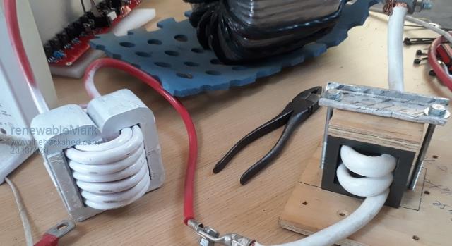

I want to start on the chokes,
  renewableMark said
Here is a pic of mine while it was all being tested prior to going in a case.
The steel one on the left is made from two 3kw aerosharps glued together.
You can't see from the angle but the one on the right has two sets of the E70 cores under that clamp.
<edited><editID>renewableMark</editID><editDate>43611.3835185185</editDate></edited>
So i started to pull the 2 large chokes aparts from the old inverters.
Do they both have an air gap. What do you use for the gap.
Also is this part the correct one for the right one.
E70 Core
What size wire did you use for the one on the right.
Andy
Posted: 04:37pm 01 Oct 2020
Andy,
The choke on the left used the original Aerosharp air gaps, which was about 1mm.
Its really difficult to measure exactly, because the two steel U halves are epoxied together.
Just use them as they are.
Cut away all the original wire, then just add the twelve turns of new wire.
Twelve turns of 20mm Sq fitted the slot perfectly, and produced 178uH, and from memory it started to go into saturation at around 135 amps.
The choke on the right is something Mark already had, so he just connected both in series.
It will work perfectly well with just the steel cored choke on the left.
So try it with that first, it will have more than sufficient inductance.

Yeah, you don't need the ferrite one that's on the right.
It has 70mm welding wire with the outside orange stripped off BTW.
Your link for the ferrite is the correct one, but you don't need it.
Those aerosharp cores give off nasty splinters that flake off, so wear really good leather gloves.
As Warp said, the chokes already have a spacer there, just use that as it's what was used when Warp did the saturation tests on it.
We know using two as is with 12 turns works well, so just copy that.
When finished paint it so loose flakes don't come off (they'll conduct) and murhys law, they will end up where you don't want them.
The one in the pic has two layers of 25mm2 cable, it's not 20mm2, so be clear on that when you order.

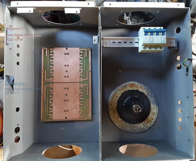

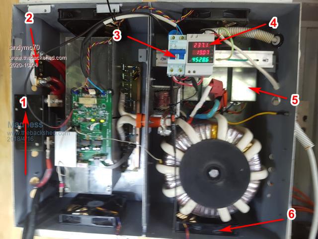

So i have found the following internal pictures just wondering a few components.

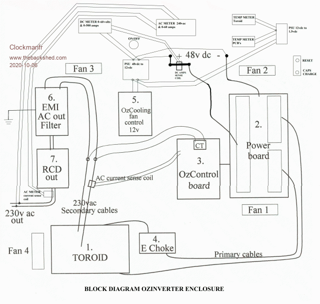

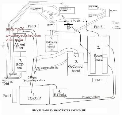

Also i have add an image that i can not read correctly when enlarged to see the overall system. I am trying to get a better understanding of how its all put together.
1. I do know what it is?
2. I think is a current shunt.
3. I think this is circuit breaker, what size do people recommend. Also do you just run cable straight to the electrical panel.[I mean you get an electrician to do all this].
4. I do know what it is?
5. I do know what it is?
6. Fan what size do you recommend, is bigger better. I was looking at 140mm 12v.
Also what/how have you setup the front panels of the inverters. If you have picture  that would be great.
Here is the schematic that i can not read when i enlarge it.
Also i am wondering how you remove the old toriod holder shown here on the left hand side.
Andy

1 is a switch
2 is a fuse
3 is a 63A AC circuit breaker
That is my original build, 1 and 2 have since been replaced with a 80A DC breaker. 80A Does seem on the light side but it has never tripped with normal and heavy use. The reason for using 80A is it will trip faster if you have a major failure. I had quite few of those in the early days and with a 200A fuse the circuit board was always badly damaged if things went wrong. With a 80A breaker MOSFETs can fail and trip the breaker before tracks get blown off the PCB. As mentioned above that was in the early days before using Totem Pole drivers. My Inverter has now run for over 3 years without a hiccup using EG8010 chip.
I use 140MM fans they can run up to 100% especially when back charging at 100A for a few hours. I would not use anything smaller. Most of the time the fans are not running and natural convection is sufficient even here in Qld.
The AC output from the Inverter in mine goes through the 63A breaker to a 63A Breaker/Change over switch in the AC switch board. I have done this to allow having a second inverter wired up ready to be turned on. The change over will only allow one Inverter to be connected.
The Toroid holder in the photo above is not in it's original position, I ground off the original and welded in a new bolt where I needed it. There is about 5MM clearance between the Toroid and the fan.
Clockmanfr
Joined: 23/10/2015
Location: France
Posts: 437
Posted: 05:54pm 05 Oct 2020
Try this .....
or this .....
BlkEnclosure1.pdf

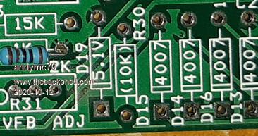

I have a couple of questions for the nanoboard.
R30 Bom says 6.8k 1/4w, where as PCB is 10k shown in pic.
Also R21 is 470 on BOM and 1k on PCB.
Also i am wondering which is positive the square or circle for the diodes and caps.

Posted: 01:35am 13 Oct 2020
  andymc70 said  hello
Andy
D5, D14 etc. pictured there has the band marked on the silkscreen and so just line up the diodes to match the band.
The line is negative for the caps. Just check a couple and see if the pin next to the line marking is connected to ground. Nearly all caps are negative to ground. The two charge pump caps C1 and C7 are not connected to ground via either pin.
R21 is just setting the current for the over current trigger LED
so anything that lights the LED with a 5V supply will do.
470R and 5V will be 10.6 mA and a good match for most LEDs

open the switch and let it float to 5V.
11.94V is really about as close to 12V as you can get.
All things will work fine.
12V is used to drive the fans and feed the 5V regulator that then drives both nanos and other things.
The 15V supply is used for the gate drive ICs, ultimately driving the gates 0 and 15V
which is a good amount of gate drive voltage.
I used 3 x 1N4007 diodes in series to give me the 12V (or near enough) in place of a
12V regulator. These 3 voltages are not super critical.
(and your DVM might be a bit out too...who knows)

  poida said  I used 3 x 1N4007 diodes in series to give me the 12V (or near enough) in place of a
I am assuming your using the diodes to drop the voltage, so around 1 volt each diode. If this is correct, just wondering why a voltage divider is not used? Also what is a DVM?
Andy
Andy
A DVM is a digital voltmeter.
A voltage divider would not work in this application.
the 15V -> 12V needs to supply enough current to drive one or both fans plus the logic
and the LCD. I would guess at least 1 Amp at 15V when both fans are howling.
