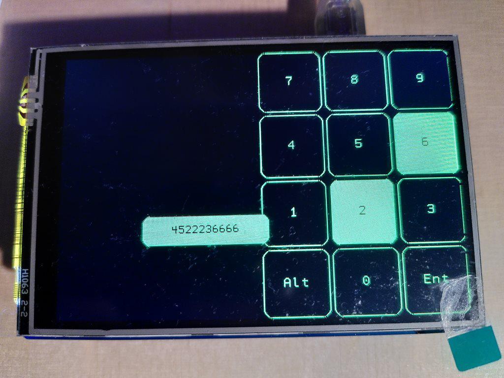

hi guys,
PicoMite is a brilliant project! Thank you so much for this, I love it.
I have the waveshare Pico-ResTouch-LCD-3.5 up and running with reading this forum.
Unfortunately I can't get the GUI controls to run.
Here is the history from the terminal, I hope you can help me:
PicoMite MMBasic Version 5.07.01b6
Copyright 2011-2021 Geoff Graham
Copyright 2016-2021 Peter Mather
> option list
OPTION SDCARD GP22
OPTION LCDPANEL ILI9488W, RLANDSCAPE,GP8,GP15,GP9,GP13
OPTION TOUCH GP16,GP17
GUI CALIBRATE 0, 218, 3963, 1269, -835
> GUI CHECKBOX #10, "Test", 100, 100, 50, rgb(BLUE)
Error : No memory allocated for GUI controls
> OPTION MEMORY 20, 79*1024
Error : Syntax
>option memory 20 (RESET!) <<<<<<<<<<<<<<<<<<<<<< !!!
> option list
OPTION SDCARD GP22
OPTION MEMORY 20, 140, 0
Any idea? The manual doesn't explain it any better ...

See OPTION GUI CONTROLS in the manual, it sets the number of GUI controls you want to use.
F4 H7FotSF4xGT
homa
Joined: 05/11/2021
Posts: 693
Posted: 09:56pm 07 Nov 2021
Oh thank you so much for pointing that out,
I have not found this command in the manual: PicoMite_User_Manual_MMBasic Ver 5.07.00b21.pdf
There I was probably not up to date.
Now I have the new version:
PicoMite_User_Manual_MMBasic Ver 5.07.00.pdf
Now it works!

The two GUI elements TextBox and NumberBox still seem to be bugy.
Sometimes the keys remain inverted.
Also there seems to be no possibility to limit the text length, or the text length is only partially displayed [This is an example...] But the content is: "This is an example text and unfortunately too long for the box!"
How can I make sure that only integer values can be entered in the NumberBox? Best still with a value range, e.g. 0-127.
Posts: 3368
Posted: 07:42am 09 Nov 2021
  homa said  Sometimes the keys remain inverted.
Peter?  This sounds like one for you.
  homa said  Also there seems to be no possibility to limit the text length, or the text length is only partially displayed
No, there is no way to limit the length of the entered text.  However, you can trap the key up interrupt and rewrite the text (ie, truncate it) to suit your application.
  homa said  How can I make sure that only integer values can be entered in the NumberBox? Best still with a value range, e.g. 0-127.
Same as before.  Trap the key up interrupt and rewrite the number as an integer with the limits that you need.
Geoff
Posts: 11870
Posted: 07:55am 09 Nov 2021
  Quote  Sometimes the keys remain inverted.
Please provide demo code and instructions as to what to do to create the issue

I must be missing something ... what the hell is that item bottom right of both pictures, that looks like sticky tape attached to the (touch) screen?
led
Miss you George
Tinine
Joined: 30/03/2016
Posts: 1646
Posted: 09:35am 09 Nov 2021
  led-bloon said  I must be missing something ... what the hell is that item bottom right of both pictures, that looks like sticky tape attached to the (touch) screen?
led
It's the screen protector tear-off. Just hasn't removed it.
