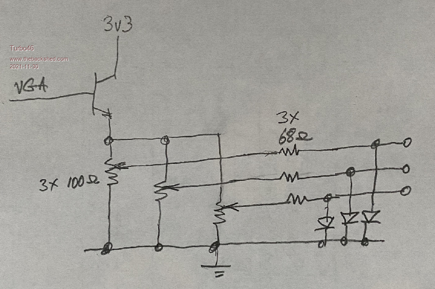

@Grogster, This would be my first pass at a circuit for VGA. Untested and I don't have an easy way to test it.
But I really think it's all a bit OTT and unnecessary. I think Volhout's suggestion is all that's needed, perhaps allow for different value resistors in place of the links to adjust the colour if it's needed.

  Turbo46 said  @Grogster, This would be my first pass at a circuit for VGA. Untested and I don't have an easy way to test it.
be wary: 2.7v into 33 ohm (3x 100 ohm in parallel) equals 80mA of current consumption JUST for the one-transistor video driver!

80mA and more through the monitor inputs. The PN100 is good for 500mA and 625mW so that should be OK. Minimum gain is 80 so only about 1mA base current needed. I did look at that because I was concerned about the load and dissipation.
Bill
Edit: I still think it's OTT.
Edit2: 80mA+ has implications for the power supply though.

The diodes can be omitted as all the monitors I have tried don't mind a bit of overdrive. Up to 1.5 V seems ok. A 270 ohm series resistor will ensure it stays under 0.8V for 3.3V supply.
With (270 + 75 ohms) x 3 at 3.3V = 29mA so the emitter follower may not be needed for this. The MX270 in the ASCII terminal did need it.
To make it easy to customize colours provide 2 x 3 pin female headers to plug the resistors into. (or 3 x 2 pin if the resistors stand vertical)

PS While I think my circuit above would work, the pots would only be effective for about half the adjustment because anything above half way would be clipped by the diodes.

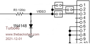

My preferred version of the VGA output.
A modified copy of the mono maximite circuit. The links allow selection of one or more colours and for those who want to fiddle, vertically mounted resistors could replace the links to produce any colour they want.
If a larger CMM1/2 box was used the board could include a 'sea of holes' to cater for those who want to add all manner of weird and wonderful things.

  Turbo46 said  Maybe use the same rear connector as the CMM2 so that PI cobblers can be used to connect to the external world.
Emphasis mine
See @bigmik, I didn't invent the term cobblers for these adapters, even one of your fellow countrymen is using it.
Is there an issue that some cobblers tie the ground lines together and if they are not also grounds on the 'mite then you are in trouble - or have I invented that.
