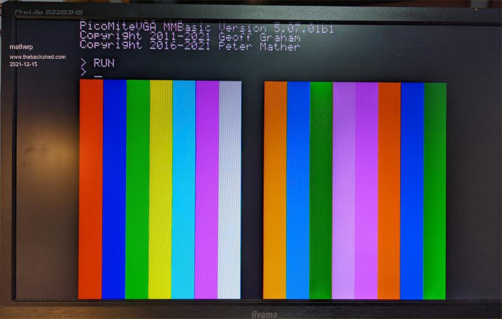

Coming soon RGB121:
OPTION COLOUR VGA ON/OFF
Edited 2021-12-15 04:56 by matherp

Posts: 12042
Posted: 10:51pm 14 Dec 2021
  Quote  Scrolls and looks beautifully flicker-free on my 320x240 display, obviously won't be quite as good on 480x320 but the suggestion that it isn't adequate for use as a console just seems to be wrong. Definitely going to be good enough for my handheld Text Adventure games-console.
It is do-able on ILI9341 but too small to be sensibly usable, not possible on 480x320 because you can't read the framebuffer. Code open source so knock yourselves out or just use an ArmmiteF4 where everything works. Not every port needs or should support everything. The nonVGA Picomite will NEVER support console functionality developed by me - end of

rather than having 2-bits of green, a more 'traditional' approach would be for 1-bit each of R, G and B, and 1-bit of intensity. ie, RGBG.
this would require no software change, just a small quantity of hardware so the I bit clipped each of R, G and B levels in half when asserted.
rob   :-)
Posts: 6191
Posted: 07:28am 15 Dec 2021
Actually Robert,
That does not make any difference for what Peter is doing. He is sending 4 bits wide video data, and you can wire it up whatever way you like. They are simply 16 colors (15 and black) and if you wire them RGGB or ARGB, that s up to you. Yes, green may be yellow, but that can easily be solved by a set of 16 defines that match your hardware. Another solution you can choose is to use the 4 bits for 16 level greyscale. In that case you may be forced to tune a bit, or the editor (in colorcode ON) may give cluttered results.
When you do not connect the second G pin, you have the 8 colors of a CMM1.
Smart, and very configurable.

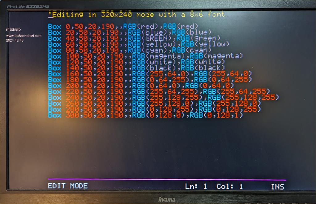

Posted: 08:30am 15 Dec 2021
I'm interested in where the RAM is coming from for these versions of VGA. It would appear to me that 4-bit video requires a frame buffer 4 times the size of that used for 1-bit video. If mono reduced user RAM from 80k to 64k that's a difference of 16k so I'd expect a further reduction of 48k for the other 3 bits, bringing us to 16k of user RAM when VGA is in colour mode.
TBH I don't understand why user RAM only dropped from 80k to 64k with a 640x480x1 frame buffer. I can only assume tha removal of other stuff freed up some RAM that was being used for MMBasic's fast access routines. If that's the case then the resulting user RAM in colour may be even less.
Assuming they do support simple graphics and therefore use a frame buffer, that is. :)
>>confused<<

Posts: 12042
Posted: 08:40am 15 Dec 2021
  Quote  I'm interested in where the RAM is coming from for these versions of VGA
640*480*1/8 == 320*240*4/8 == 38400 > (80K-64K)*2
Posts: 9229
Posted: 08:51am 15 Dec 2021
So you  get either 640x480 mono or 320x240 colour, it's a swap? That would make sense to me.
