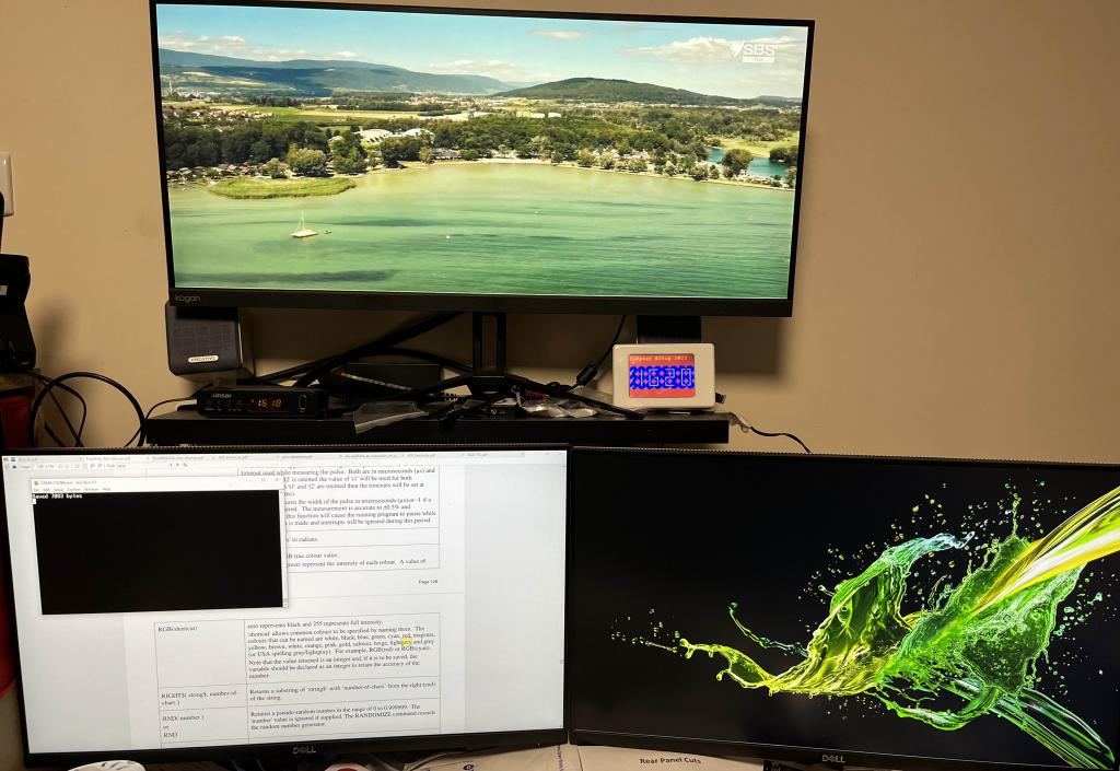

Hi Bleep, All,
The only line I added was RTC GETTIME
Spent half an hour playing with colours to end up near your default colour scheme
Beautiful job.
Here is a picture of near where its final resting place will be.

Hi bigmik,
What type is the display you are using?
Tony

Posts: 2981
Posted: 04:09am 03 Aug 2022
Hi Tony, All,
  morgs67 said  Hi bigmik,
Tony
Assuming you mean the TFT module, and not my 3 monitors, I am using an ILI9488 3.5" 14pin SPI module.

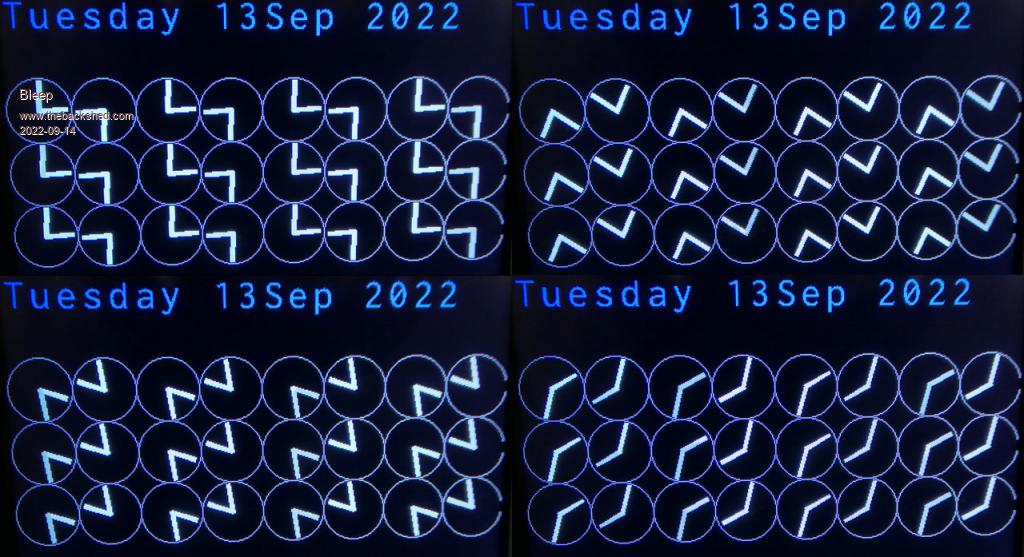

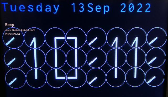

I have now added some extra animations during time transitions, apart from the normal transitioning from one time to the next, every 6 minutes it will go off into a world of its own for a minute, before returning to displaying the time, there are about 25 of these digressions, so it'll take a while to go through them all.
I have also improved visibility by making the hands slightly fatter, I've also adjusted the way the digit '1' is displayed, so that the number layout looks better, when a '1' is on the display.
As before there are two versions, clockclock24 is stand alone, 3clockclock24 is intended to be used with the other clock programs I uploaded 03Aug.
As before you will need to adjust to your preferred colours.
Otherwise should all be good. :-) hopefully.

A few pictures for the new number layout and some of the various animations.
This shows the new layout when a '1' digit is being displayed.
Some shots of the clocks in mid animation.
Regards Kevin.
