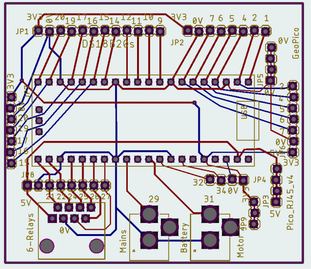

Well, Tom, I did just yesterday order version 4 of the PCB I'm calling GeoPico (because it started off being the controller for Paul_L's geothermal system, and might just make it there someday):
I'm not really into VGA (have only built Mick's mini version so far), but the PCBs are so cheap, why not. If anyone in the U.S. wants one of Mick's new offering, I figure I'll have 3 of the 5 to spare, maybe 4 of them.
