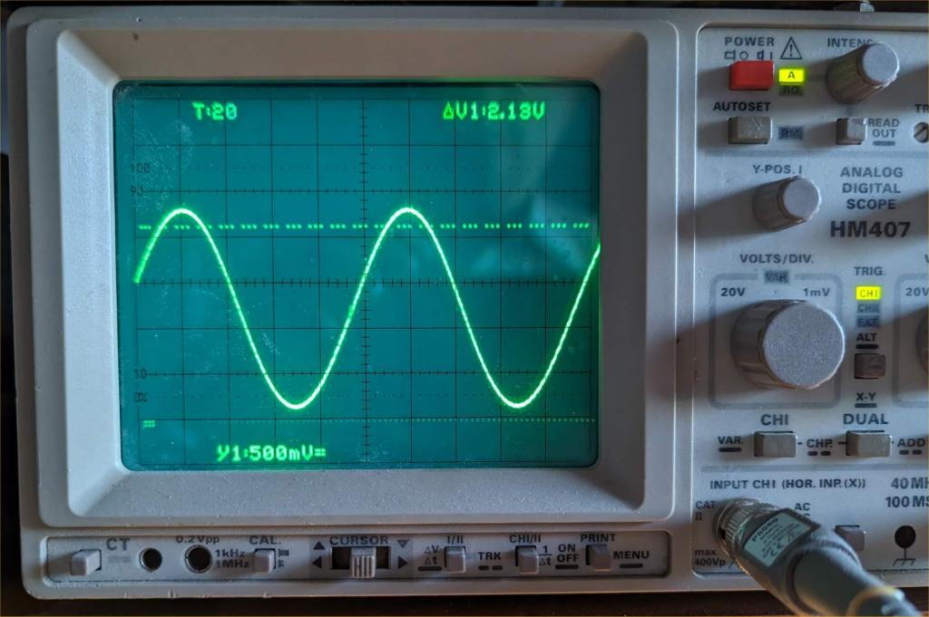

Posts: 12183
Posted: 01:19pm 25 Mar 2023
Here is a circuit tested in the silicon - none of this LT spice nonsense. Measurement is across an 8ohm load
No clipping.
Nice sinewave
Tested from 30Hz to 10000Hz
Edited 2023-03-25 23:22 by matherp

Posts: 12183
Posted: 01:48pm 25 Mar 2023
I'm not very knowledgeable on analogue electronics. However, the one thing I do know is that audio amplifier modules are likely to be unsuitable. We need amplification of current not voltage. Most audio amplifiers have voltage gains of 20 or even greater whereas we need a gain of not more than 5V/3.3V to avoid clipping and a horrible sound.

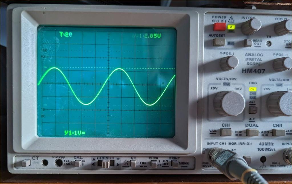

Posts: 12183
Posted: 04:09pm 25 Mar 2023
Circuit works nicely with 8ohm across the speaker/1000uF cap - still lovely clean sine wave and music plays as expected and all DC gone

Posts: 12183
Posted: 04:52pm 25 Mar 2023
  Quote  Nice analog scope….
Thanks. Hameg HM407 Analog with digital storage as well
  Quote  are you planning to include the "p" and "n" (white noise) options for the play sound function in the next release of PicoMite MMbasic?
Yes
  Quote  Did you measure the output into a speaker or a resistor? the 1.4v offset in the output is probably not going to go well with a speaker voice coil, they normally don't like anything more than a few mV, hence the reason for coupling capacitors in single supply amps (unless BTL)
Now fixed as per Mixtel's change so no more DC offset and waveform across speaker just as good (1000Hz)
Note change of bias resistors - now 12K to GND and 15K to 5V
Check out the recording in the post above

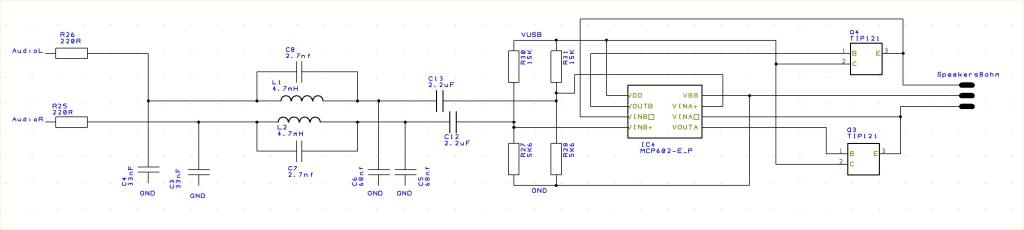

mozzie
Joined: 15/06/2020
Posts: 508
Posted: 05:07pm 25 Mar 2023
Sounds good Peter
Considering the audio output from the Pico is virtually identical to a Class "D" amplifier (at lower frequency) I still think for direct drive of a speaker we are better off simply buffering it for more current drive and applying a little filtering before the speaker, this means no biasing and the transistors are always on or off so no heat generation. This is ok for the LO-FI side anyway.
This is the bridge version of the one above, although its starting to get more complicated than an integrated amp
It does a very good job with steam sound effects and tones, I'll have to sort out some music to try to see how it does.
Sadly all these years of tinkering with audio hasn't made me a very good programmer..

Posts: 9329
Posted: 05:21pm 25 Mar 2023
But the inductor alone is almost the size of the LM4871...
And I ordered 10off LM4871 for 3.04 UKP including postage.
Don't you just hate silicon sometimes?
