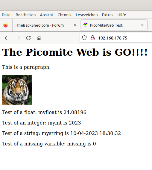

andreas
Joined: 07/12/2020
Posts: 226
Posted: 04:45pm 10 Apr 2023
Hello,
last easter days I played with WebMite and wanted to see the web-demo running showing the tiger, but I did'n succeed. I saw the webpage and the values, but not the tiger. The firefox browser was constantly spinning as if the transfer had not finished.
I modified the demo a little and found that the lion picture "small" needs a "/" as prefix to show up correctly, stop the transfer etc. Now it runs as expected.
And here is the modified program:
' HTTP Host
Dim buff%(512)
Dim myfloat!=24.081960
Dim myint%=2023
Dim mystring$="The Picomite Web is GO!!!!"
WEB ntp 2 ' Germany = +2 hours summer time
 poll
Sub poll
Local p%, t%
For a%=1 To MM.Info(max connections)
 LongString clear buff%()
 WEB tcp read a%,buff%()
 p%=LInStr(buff%(),"GET")
 t%=LInStr(buff%(),"HTTP")
 If (p%<>0) And (t%<>0) And (t%>p%) Then
   s$=LGetStr$(buff%(),p%,t%-p%+4)
   Print "String is ",s$
 EndIf
 If (p%<>0) And LInStr(buff%(),"/small") Then
   Print "sending picture"
   On ERROR SKIP 1
   WEB Transmit FILE a%,"small.jpg","image/jpeg"
 ElseIf (p%<>0) And LInStr(buff%(),"favicon") Then
   Print "sending icon"
   On ERROR SKIP 1
   WEB Transmit FILE a%,"favicon.ico","image/vnd.microsoft.icon"
 ElseIf (p%<>0) And Instr(s$,"HTTP") Then
   Print "sending page"
   On ERROR SKIP 1
   WEB Transmit page a%,"test4.html"
 EndIf
Next a%
End Sub
Many thanks for WebMite!!! Hope to get the manual soon
-andreas

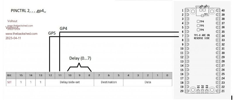

Posts: 6169
Posted: 09:47am 11 Apr 2023
Peter,
Something is not Okay with the PIO assemble when using a mix of DELAY and SIDE SET (unless I am mistaken).
PIO assemble 1,".program NES"
PIO assemble 1,".side_set 2 opt"
PIO assemble 1,".line 0"
PIO assemble 1,"PUSH [&b01,7]" -> 2 side set pins should be &b01 and delay 7 (&b111)
PIO assemble 1,".end program list"
This should assemble to 100 01111 0000 0000 = &h8F00
                           ssddd
                     s=side set, d=delay
But it assembles to     100 00001 0000 0000 = &h8100
                           ???ss
(delay field is filled with side set information, and side set field is empty)
This seems also valid for other instructions that use side set. I also tried without the "opt" parameter, but that does not change.

Posts: 11996
Posted: 10:32am 11 Apr 2023
Your syntax is wrong twice
First you can't have "opt" and 2 sideset and 3 delay = 6 bits!
Without the opt the syntax as per the RP2040 datasheet should be:
PUSH side 1 [7]
At the moment side does not accept & construct - will add in next beta

Posts: 6169
Posted: 11:53am 11 Apr 2023
@Peter,
Thanks, will use this in de text
You cannot use &h or &b in side set.
Not a major issue...
