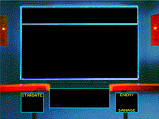

Posts: 6227
Posted: 11:10am 21 Jul 2023
MaxiTrek quick update:
The differences between CMM1 and pico are huge. I was far to optimistic.
- sprite commands
- the use of PWM and TONE and PLAY MOD on the audio
- missing CLR$()
- screen resolution CMM1 MODE 4 is not pico MODE 2
almost every line needs adaptations
this will take considerable time...
EDIT: especially the CLR$() where you embed the color into the text string is a nice function.
a$=CLR$(2,1)"Hello"CLR$(3,1)" Boys"
The color is embedded into the string itself...
Edited 2023-07-21 21:21 by Volhout

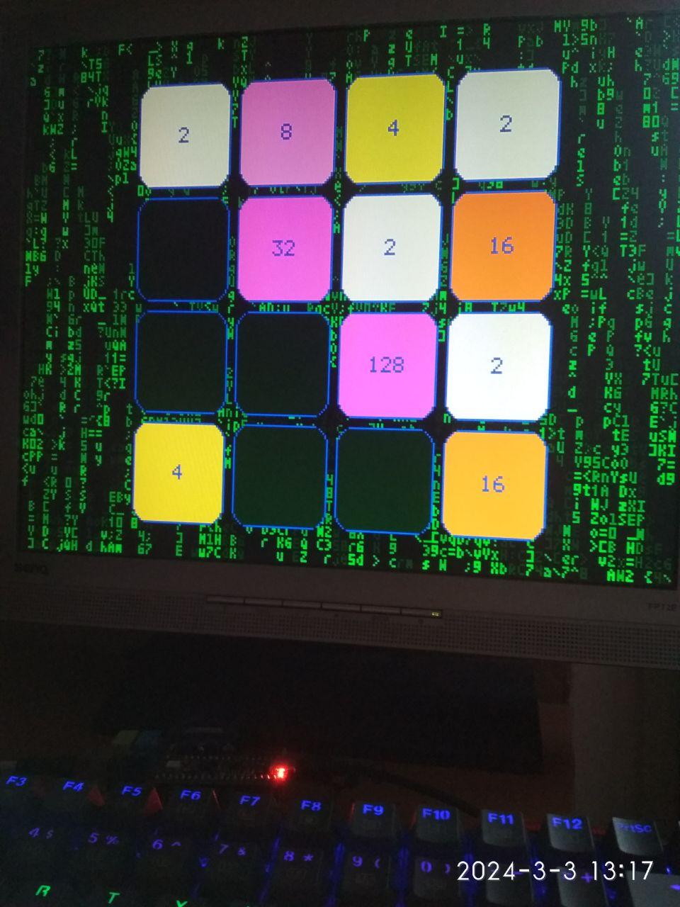

Joined: 01/10/2023
Location: Ukraine
Posts: 625
Posted: 11:26am 03 Mar 2024
Game "2048" on top of the current Matrix
2048.zip
Posts: 6227
Posted: 12:47pm 03 Mar 2024
Very nice,
Looks extremely polished. And works good. Had a few rounds of 256 and one of 512. Enjoyable to play.
Only one (minor) remark. The readability of the messages at end of game is not very good (orange color text on the green "matrix" background). Maybe some color changes or a frame around text could help.
Edited 2024-03-04 17:46 by Volhout

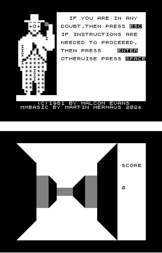

Posted: 01:33pm 09 Mar 2024
  Volhout said  Hi Martin,
The later you have to do anyway.
Aaaaahhhh, you also changed the video resolution. You are planning to go all the way.
Allow me to send you the code as far as I am. It is partly playable. (start picotrek.bas).
Picotrek.bas runs, I am working still on Picogame.bas. You need VGA version 50708b9 (MOD playback) to run it.
maxitrek_pico_WIP.zip
took a look and found that it would be the best, to keep the game in its 240x216 resolution. To keep it, all screen coordinates has an offset to be added (40 for x and 12 for y values) to keep it in center.
Screen than could look like this:
every
BOXES and LINES
the Line x1,y1,x2,2,col,b or bf commands have to be changet to Box commands,
(x2 and y2 are also coordinates, so they have to be recalculated to W and H)
or let a sub do this
Sub bxf(x1,y1,x2,y2,co)
 Local integer ox=40,oy=12,w=x2-x1,h=y2-y1
 Box ox+x1,oy+y1,w,h,,co,co
End Sub
Sub bx(x1,y1,x2,y2,co)
End Sub

so replace every
Line (x1,y1)-(x2,y2),col,bf with bxf x1,y1,x2,y2,col
and every
Line (x1,y1)-(x2,y2),col,b with bx x1,y1,x2,y2,col
Syntax of Lines has to be cahnged
from Line (x1,y1)-(x2,y2)[,col]
to  Line x1,y1,x2,y2[,col]
Starfield set the integer var "maxstar=10" at start of the Program
Colornubers of the Maximite has to be  be translatet to the first 8 Colors of Picomite
colors:
 '--Colorscheme accordung to Spritecolors
 Data RGB(BLUE),RGB(GREEN),RGB(CYAN),RGB(RED)
 Data RGB(MAGENTA),RGB(YELLOW),RGB(WHITE),RGB(MYRTLE)
 Data RGB(COBALT) ,RGB(MIDGREEN),RGB(CERULEAN),RGB(RUST)
 Data RGB(FUCHSIA),RGB(BROWN),RGB(LILAC)
more to come (if you still want to port the Game to PicoMiteVGA)
sprites are cutted to PicoFriendly Sprite format
PICOTREK-resources.zip

One of the first games I bought for my ZX81 back then.
Who would have thought that I would be reprogramming it almost 43 years later
3D Monster Maze PicoMite VGA and others
Edited 2024-04-28 12:00 by Martin H.
