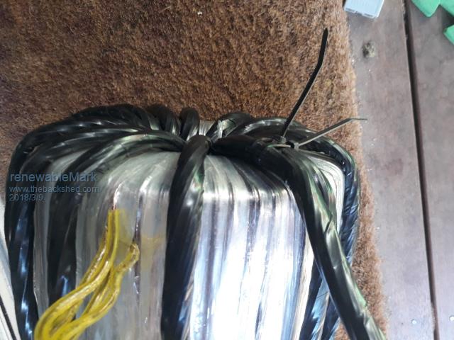

It's very hard to see in the photos, but the more levering I did the more the wires flattened out and made it worse, so just got to that point and thought as long as the ends are flat and a super big washer gets mounted flat and square then that will do. It will still fit a bolt with some conduit.
Reckon if the wire got twisted a lot tighter it would have held it's shape better, the way mine was it just seem to flatten out too easy, I reckon that's where I went wrong.

Looking at Marks fine effort I had an idea that somebody who has not yet wound the primary on could try out;
Multi strand power cables seem to have an inner layer of an odd number of wires wrapped around a central wire.
This then has another layer of wires wrapped around but in the opposite direction. I suppose this is to keep the lot firm and round when bending around corners.
So, my idea: Make a plywood disk with a central hole of the individual wire (strand) diameter. Around this, spaced away a little for rigidity, a circle of the number of holes that would fit tightly next to one another around the center strand. (number depends on wire diameter).
Procedure: feed center strand through center hole and outer strands to each hole, then tie up to a firm post. The rest of the wires are stretched out in a straight line from the other side of this plywood disk.
Then walk backwards while rotating the disk, this should neatly wrap all the outer wires around the center one.
When the inner core is complete make another plywood disk with this core's central hole size and the required outer strand hole ring. Repeat the above but rotating the disk the opposite way.
Now, I have not tried this yet, it should work theoretically. As there is plenty of left over 1.8mm wire around here I might give it a go for a short cable just for fun and to prove a point.

I'm thinking Klaus that would be a complicated operation even with a very expensive machine, trying that at home seems overly tedious.
Good luck mate.
Reckon I'll fork out for welding cable on the next one.
Cheers Caveman Mark
Off grid eastern Melb

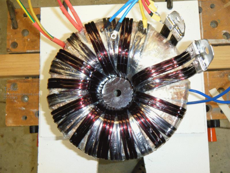

Mark, you can do better than welding cable! Look at this picture of my double stack toroid and notice the center hole size. That's a total of 90 mm sq BTW for the primary, something you will *never* manage with round cable.
That square wire (3x5mm) I got for scrap price as a leftover of an order from a local firm that makes this kind of wire to any size you want - if you order 200kg. For leftovers you take whatever they have at the time.
Apparently there are two companies in Australia making this, one here in Perth and the other in the eastern states somewhere - maybe near you. I found out about them from a local motor re-winder.

Circles have magical mathematical properties.
If you take one central wire (as pointed out above by Klaus) six more wires will fit very neatly around the central wire. Making a seven stranded cable.
Now if you place more wires around that, you will find that the next layer will have six more wires than the previous layer. So we have 1 + 6 + 12 making a nineteen stranded cable.
Another added layer will again amazingly have six more wires than the layer underneath. So the next size up will be 1 + 6 + 12 + 18 making a thirty seven stranded cable. And it just keeps on going.....
But it also works the other way too.
If you are winding layers on a toroid, each layer will theoretically have space only for six less turns than the previous layer. It never quite works out exactly, because its very hard to fit turns tightly together when hand winding, and if you add insulation between layers that upsets things too.
But as a rough rule of thumb when toroid winding, you might assume that if you can just fit for example 160 turns on the first layer, you might be lucky to fit 154 on the next layer, and 148 on a third layer.
So to be safe you might decide to make all three layers say 145 or 146 turns.
The first layer will have a big gap, the next layer about half that gap, and a third layer will just about have no gap, in this example.
Of course in practice there should be no huge gap, you spread the turns of the first layers. So you mark out the circumference (in this example) into maybe 146 divisions and work to that...
If you know the wire diameter and the toroid hole size, and number of layers, you can come pretty close to anticipating what will fit.
Rectangular wire is especially nice to work with, it bends much more readily than round wire for the same copper area, and its much more space efficient. Any large transformer winding business will probably have some in stock.Edited by Warpspeed 2018-03-11

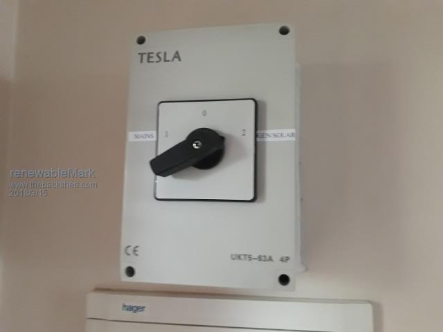

On another matter I got the changeover switch fitted. Spoke to battery fellas today and will order that.

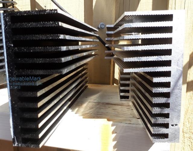

Finally got around to cutting the heatsinks, jeez that made a mess! Tiny al filings all over the courtyard, I reckon there was that much aluminium flying around the airport picked me up as a low flying plane!
Tinker, not wrong about full mask, ended up using my welding helmet and full overalls.
Have to drill the heatsinks now then ready for testing.

You do get a very nice finish with the correct blade.

Should have warned you about the blizzard of ally chips.
The noise can be quite memorable as well.
I do that sort of thing way out in the middle of the lawn these days.
I think you said you used a Bunnings blade ? what was it exactly, it seems to leave a very nice cut.

Mark nothing wrong with starting with 4 FETs you can do an initial check with no toriod. Just leave the big caps off and run through a resistor, the 2 you used in parallel to test RDS on work fine. You should get a good sinewave out with no load, it may be slightly in a triangle shape, that is okay. While running through the resistor you can't put more than maybe 50 W load on it. Once you have a sinewave you could try bypassing the resistor and run a 1200W load for a quick test. The sinewave will be more triangular due to no caps. Once you have confirmed the first 4 are good then start adding more MOSFETs. It is a bit time consuming but best to be patient. Keep an eye on the DC current, should be 50W or less with no load, any more and you need to find out why.
Those heatsinks look like you bought them. I have used blades made for timber as well but the proper Aluminium ones are much better.Edited by Madness 2018-03-19

Thanks fellas, it was an aluminium Irwin blade 254mm?, used the Lanox, boy does that make a difference big time!
