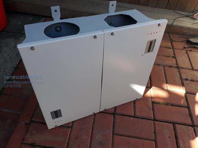

OK well since this needs to go in the case next, I started to get that ready.
Covers trimmed to fit in the middle, I'll get a rubber trim strip to fill the gap in the middle.
Has anyone got any bright ideas how to conceal/use the cutouts for the old LCD displays?
Cheers Caveman Mark
Off grid eastern Melb
Madness
Joined: 08/10/2011
Posts: 2498
Posted: 08:49am 28 Mar 2018
A power point is a good fit for those holes, maybe the other one could be used if you are planning to add a LCD CRO screen permanently. I found once you have confirmed everything fits okay it is probably easier to assemble it where it is going to live. But first you need to get the electronics finished and tested. I know Tinker would assemble everything and then test it but I am not that game.
Posted: 10:19am 28 Mar 2018
My old PJ conversion inverter was fitted into one of these Aerosharp boxes.
I found it a pain to fit anything to the lid (which I did) as the wires have to be long enough and movable to remove that lid. I ended up using special marine offset hinges to take care of the lid but still had the moving wires when opening it.
Yes, you *will* open it a few times while in the testing (for cooling) stage.
But, if you mount sockets/ switches etc on a secondary panel so they poke thru that opening in the lid, everything remains in place when you take the lid off.
Have a look at the pictures on the last pages of my inverter build. I made the whole enclosure but the controls poking thru panel cutouts principle was the same.
I am just in the process of connecting the control panel of my latest inverter. It should be finished soon and if it works I'll post more pics on this forum.
