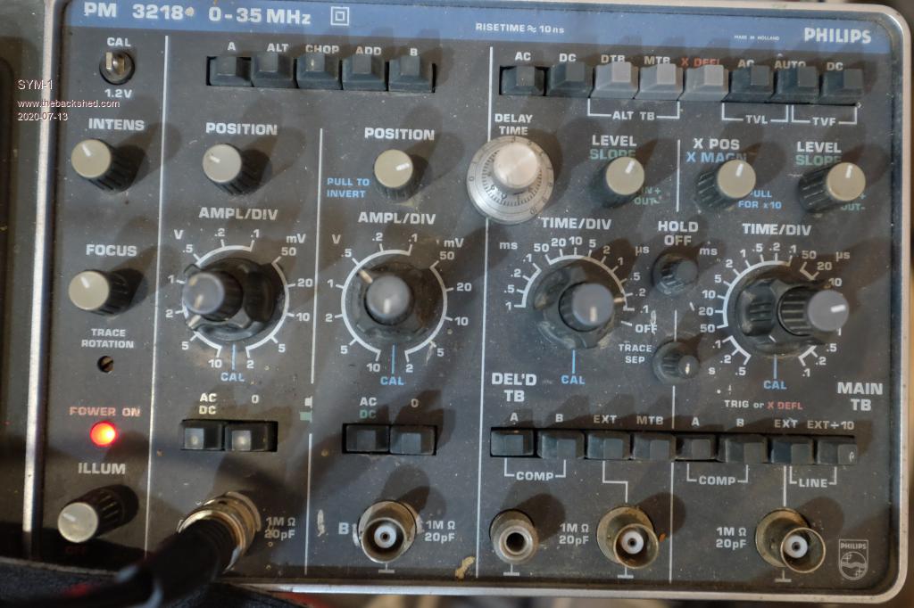

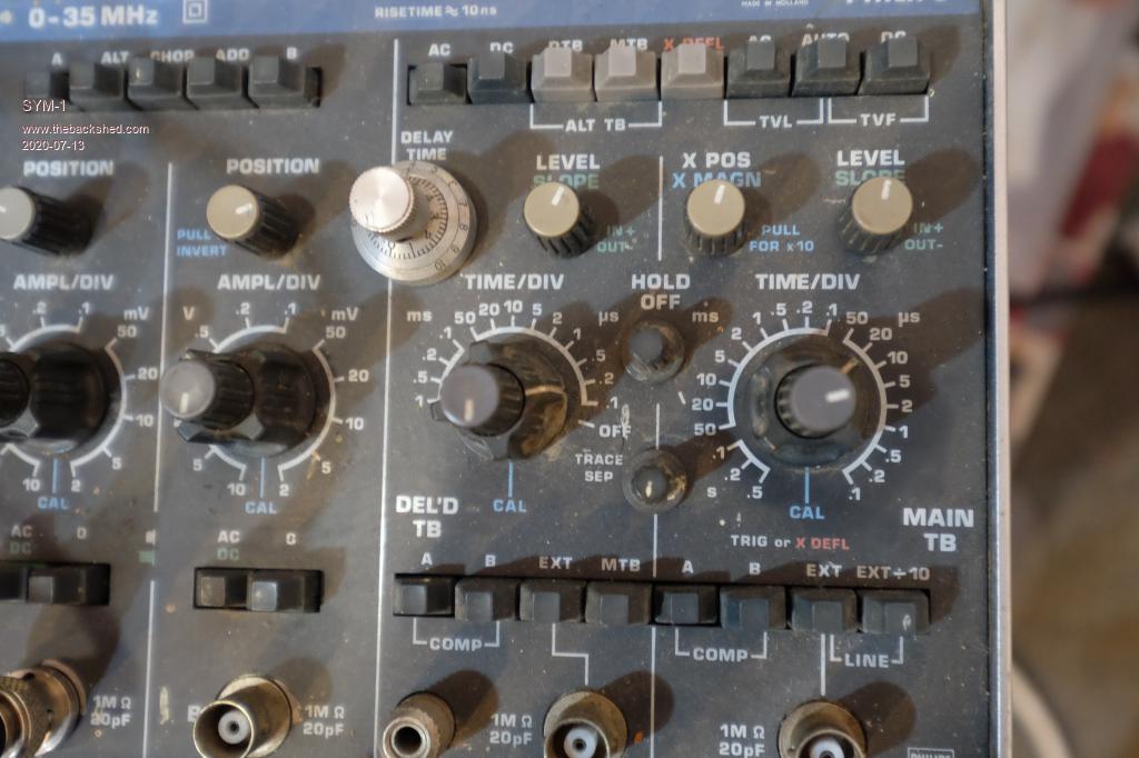

I have been working on measuring my inductance using the dv/dt method.
I have a T520-2 core.  Well two stacked cores.  They have 100 turns.
I performed my test running into a resistive load of 0.75Ohms.  Now to calculate the inductance I needed:
Input Voltage = 72.8V
Output Voltage = 17.4V
uS rise time = 42uS
Current Swing on output = 5.2A (4V/0.75Ohm)
((72.8 - 17.4)Volts*42uS/1,000,000/5.2Amps = 447.8 E-06 or 447uH
Now if this is true - I should be able to drop the number of turns down to 30 and use some 6mm tape or something similar to get the voltage drop down.
I guess the current swing will go up in proportion.  I wonder how much the current swing effects the maximum power output of the panels.
4V swing (5.2A)
20 uS per div
5V per div

Posted: 06:15am 13 Jul 2020
If you reduce the turns from 100 to 30, that is x 0.3 turns.
Inductance will change by 0.3 x 0.3 = .09
447uH will become 40.23uH
With a voltage difference across the choke of of 55.4v (72.8v - 17.4v) and an "on" time of 42uS the peak to peak ripple will now be 57.8 amps.
Why would you want to do that ?
