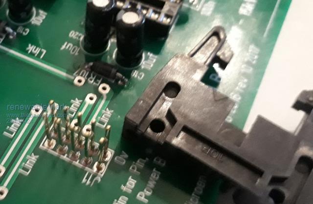

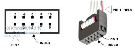

The index point on the plug is in the center.
When you make the plug, lay out the plug /s on the bench, so that the location/index protrusion is in the same orientation for both.... not facing each other. If it is on the left for plug one, then it must be on the left for plug 2 as well. Lay the cable on them.... note orientation and clamp them.
There are different gauge ribbons, make sure they are partnered to the correct plug... else crowding can occur, and shorts occur.
The real test is plugging them into their respective sockets, and measuring the resistance from pin one to pin one two to two etc.
This will prove that all paths are coherent, and going to the correct number pin.
If any are iffy, then noise will kill the unit. Because the boards are premade, paint by number, this is the only likely culprit I can think of. I have made a lot of these, and they all start up fine, only adjustment is current and voltage, and it just works... and do not seem to fail under all normal condition folks seem to throw at them over here.

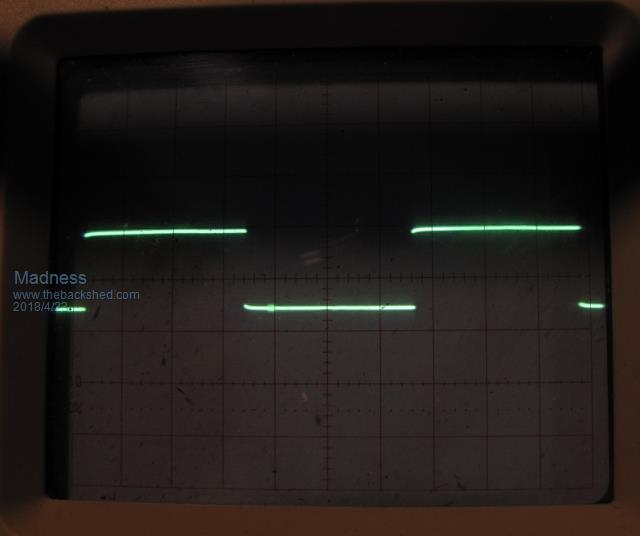

Soldering the EG8010 is not too hard if you use SMD flux, first thing though get it exactly right with just one leg. Once that first one is correct do another on the opposite side so it is fixed in EXACTLY the right position. Once you start doing more it is near impossible to correct later. I find with the flux on all the pad you need as little solder as possible on our iron just touch the pad with the solder and the flux does the rest for you. If you get too much on solder wick takes it off.Edited by Madness 2018-04-23

soldered up another 8010 chip, cro tested that all looks good.

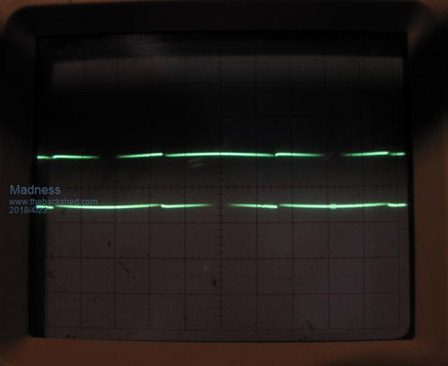

Mark I have been at the point of throwing the whole lot in the bin a few times. After a few hours I went back to it, I was not going to be beaten by a few MOSFETS especially when Oztules and others could get it working. I even seriously considered asking Oztules if I could get on a plane and visit him with the f'n thing.
I would look at the gates of your MOSFETs with the CRO and see what you are getting there, you should see the same as you did coming out of the EG8010 and the IR2110's.
Try it with the Toroid disconnected as well and see what you get on each of the smaller heatsinks. This is what you should see.

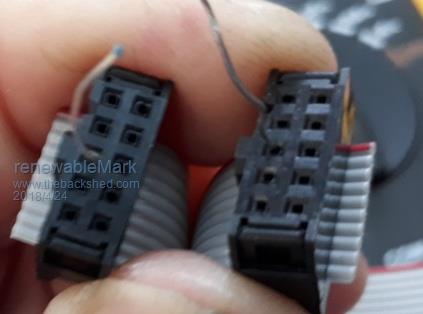

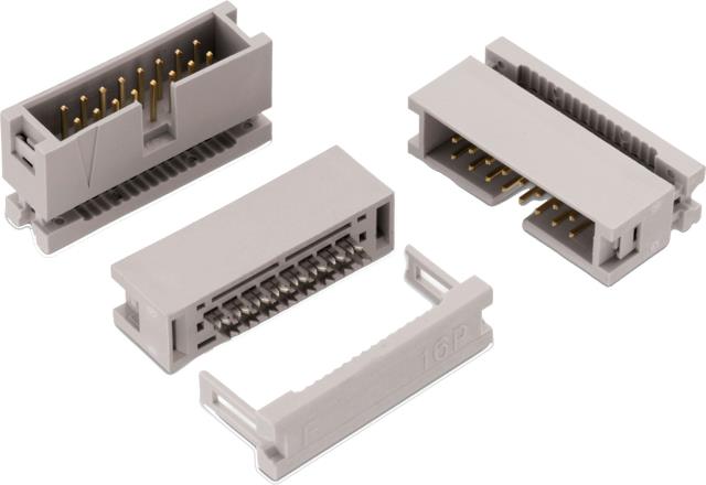

Klaus has this exactly right.
Ribbon cables are an instrument of the Devil.
If you must use a ribbon cable approach it with much fear and caution and expect to have trouble. Every time you plug and unplug one you are stressing what is probably a horrible crappy joint between the ribbon and the connector.
Insulation displacement joints are supposed to force a SOLID conductor between two tapered jaws where the wire is then supposed to be immovably and permanently wedged solid. Rather like a sliding type of crimp joint. Extreme constant applied pressure produces a quite good metal to metal electrical connection.
Only a complete idiot would try to use this conductor wedging technique with a readily crushable multistranded wire. Think about it.
If ribbon cables used single solid conductors they would not be as flexible, but at least the insulation displacement joints might stand a faint chance of working properly.
If you can get the proper professional tooling to do it, its probably just barely acceptable if the whole mess is installed inside a piece of equipment and then never disturbed.
Unfortunately for our typical home brew application, its never going to be left in peace but plugged, unplugged, and mercilessly stretched and flexed time after time.
If you are really stuck, use pin headers and header plugs, and solder each individual wire, then cover each soldered joint with small bore heat shrink to limit flexing right at the soldered joint.
Solder the male pins to the board, they never give trouble, its the females that can sometimes cause problems after many long years in a very dirty environment, so fit the females to the cable end if possible where they are more easily replaced.
I don't expect anyone here to believe any of this.
End of rant.

Tony, that's prone to making mistakes by connecting the wrong lead to the wrong pin, but at least when you push it down you would feel some resistance hopefully indicating a good contact.
You can actually pull the plastic part off the IDC plug leaving the pins neatly aligned on the board.
In my case, I don't think that's the problem, but I hear you, if the replacement boards weren't so cheap I would persevere and probably try that.
You do seem to get confidence in a connection when you can feel it go on tight.
I did a resistance check on the cable by itself and pin to pin on each board, everything was fine, so that's not my issue here

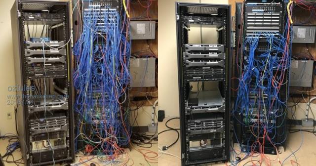

I do take your point Warp, and there is sense in it too...
But life without ribbon connectors can get like this very quickly when you have data lines or a lot of interconnects
or this:
Imagine the insides of a tower, with 40 wires to the ide HD, and another 40 to the CD drive and yet another to the second disk... 120 wires drifting around the place.... and need to be fitted. The alternatives are difficult to perceive.
So it seems to me to be the best bad alternative, rather than just a case of bean counting. It is simple repeatable idiot proof manufacturing..... and that makes it cheap.... I need idiot proof, so maybe thats why I am drawn to it.
Don't withdraw just because we differ on opinion.... thats a good thing. Folks need your expertise more than mine, as you have a lifetime of electronic experience that I don't have. That does not mean I have to agree with every aspect of your beliefs.
In this particular case, it is easy to reverse the header connection....only once.
After that you get it right every time. Longevity is another matter, but in this case we just need to get it to work.... then it can be tidied up any way we want...... but to get a working example is the first priority. Once that is achieved,we get experience, and then can move on to point to point if we so chose.
Because you understand what you are building ( because you designed it anyway ), it is easy to point to point, or break it down into smaller plugs and sockets as tinker has done, but as a first step, repeatable is best, and that means a paint by numbers board/s, and a blind wiring scheme ( ribbons)
Prototyping can look like this,
But, can you imagine manufacturing in this form?
......oztules

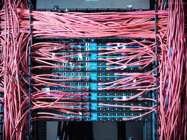

Posted: 11:44pm 23 Apr 2018
Oz, the largest single piece of equipment I was ever personally responsible for designing was a control desk used for theater stage automation. The one I designed was called "State 3" and just that control desk all by itself was worth over a million dollars just for the bare control desk. A whole turn key installation was several million depending on how large the project. We installed the very first one in the State Theatre in Melbourne, hence the name. And another in the Sydney Opera House, plus other complete installations in Indonesia, China, The Juilliard Theatre in New York, and Covent Garden Theater in London. That was all around 1996.
After I left the company my successors designed the later "4" and "5" versions.
Here is the picture of the most recent "5" version control desk.
http://www.lynx.com/bytecrafts-state-v-theatre-automation-system/
My version used a couple of large card cages, and the whole beast was stuffed full with ribbon cables up to 100 conductors wide. I even successfully ran RGB video in quite long ribbon cables after some very careful impedance matching and testing. So ribbon cables do work, and are a very practical solution, but only if the ribbon connectors are very carefully assembled, and more importantly that they are not frequently moved around once installed.
For the "build it on the kitchen table" type of hobbyist, there are much more suitable alternatives available, especially when the number of conductors is not that large.
