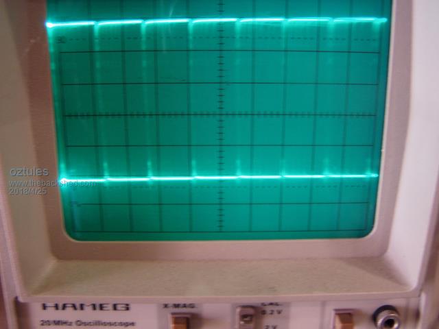

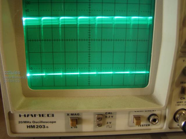

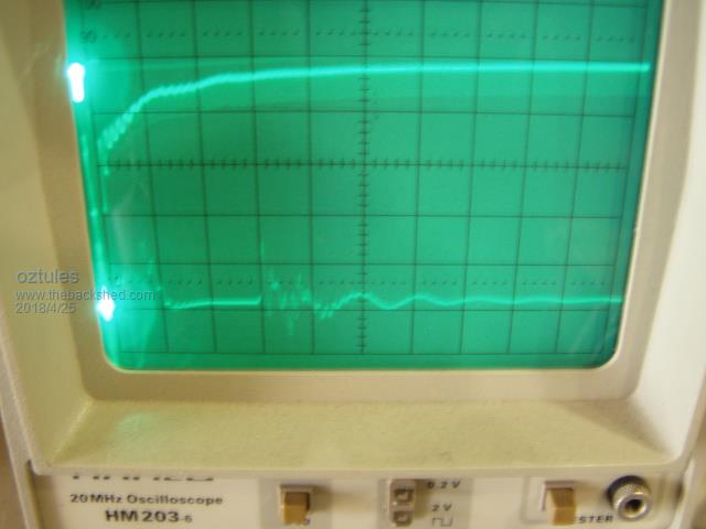

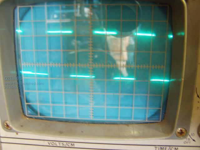

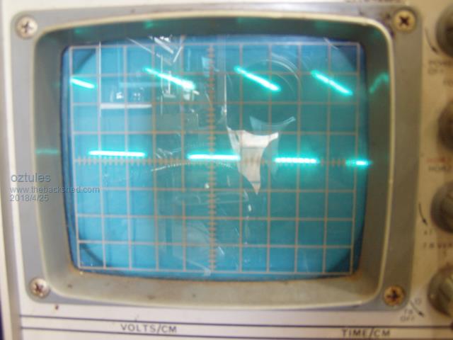

The top chip looks ok, the bottom one I can't even get remotely close to that definition... mine looks like this for the high side 50hz... note the sag back to 12v (5v/div)... looks silly, but makes no material difference.

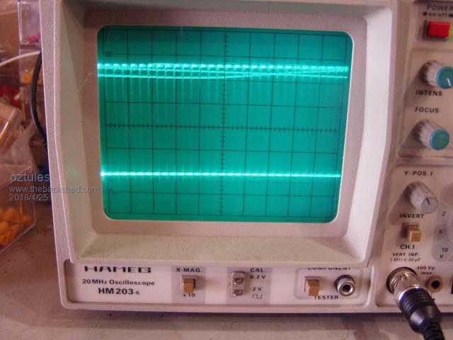

Now we get to the spwm
first slow and it looks like this
and quicker like this
faster again..
and again
and again... why am I doing this...
because I think you have the very start of the wave form showing up, and it may be a very small time unit. On my older one I did not see this, but the Hameg does show it up some.
So... compare those slides to either spwm signal, and see if yours comes out the same as you increase the scan frequency

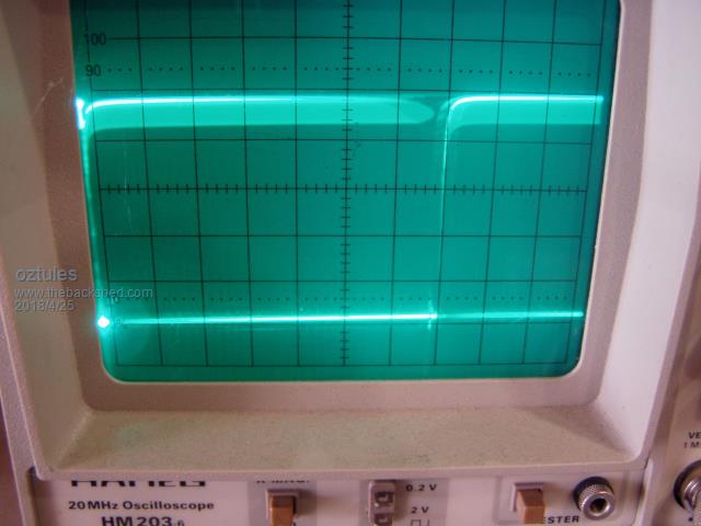

oh and the 50hz low side is like this
photo's of the phosphor screens have a lot of fuzz about then... so try to ignore some of it
........oztules

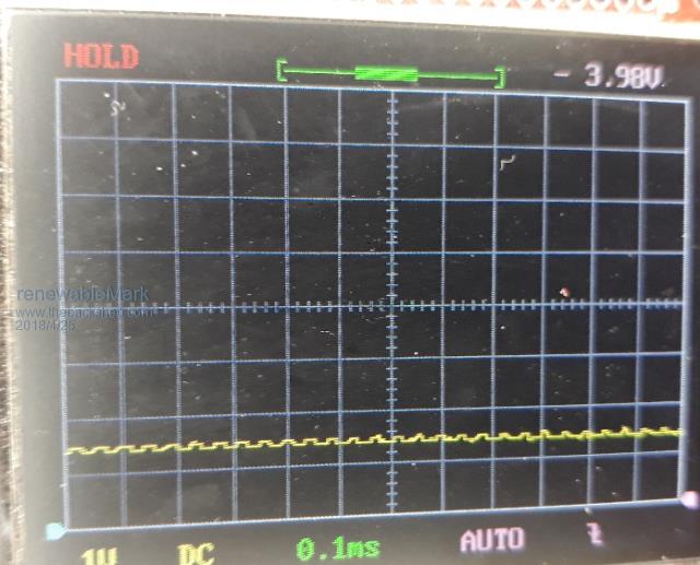

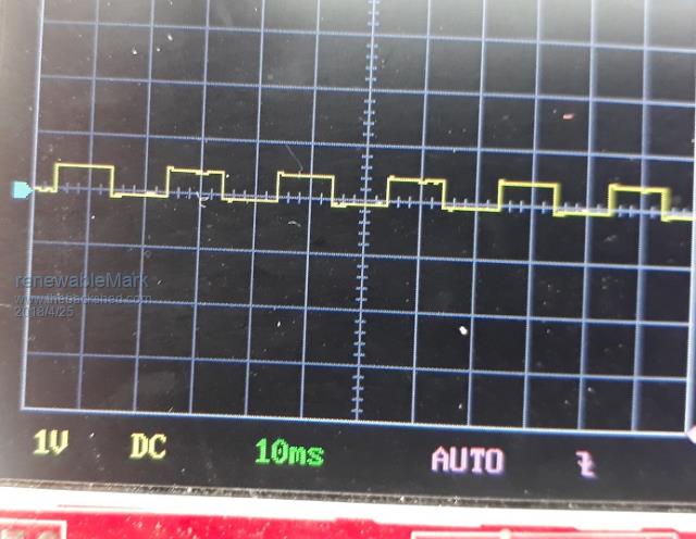

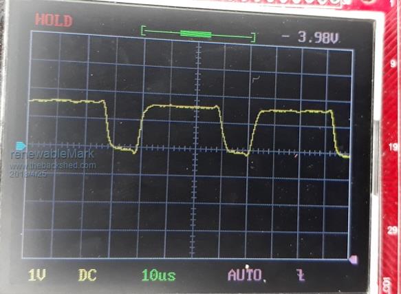

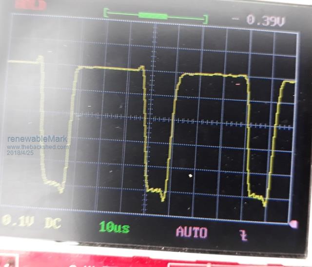

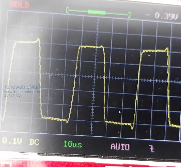

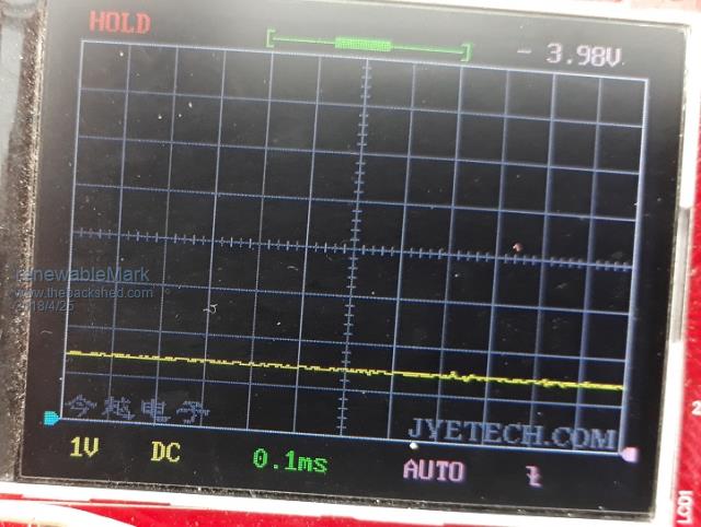

Looks like I'll need a better scope.

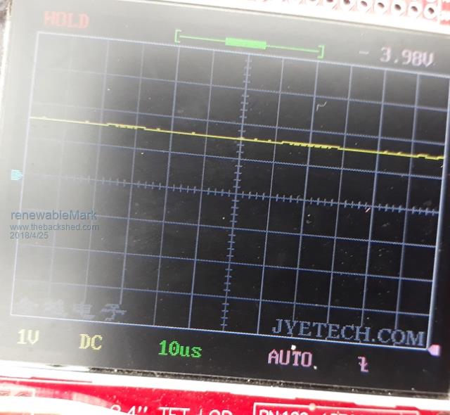

Pin 10 top with 2110
Top pin 12 with 2110
Bottom pin 10 with 2110
Bottom pin 12 with 2110
Top pin 1 with 2110
Top pin 6 with 2110
Bottom pin 1 with 2110
Bottom pin 6 with 2110
Cheers Caveman Mark

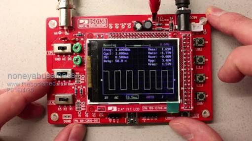

Mark, if your oscilloscope is new,select the " time base ( 10us etc.)" , press and hold the " ok " button.. it will show you the frequency and amplitude in real time. ..
Snippet from instructions. ..
I think it works !!
noneyabussiness
Joined: 31/07/2017
Posts: 527
Posted: 08:08am 25 Apr 2018
Itll come up with something like this. ..so it will tell you 23khz and 50hz if solid
I think it works !!

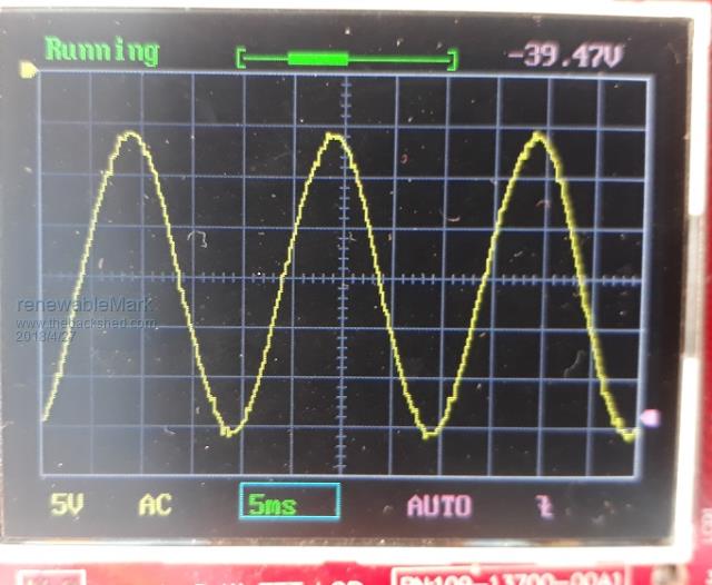

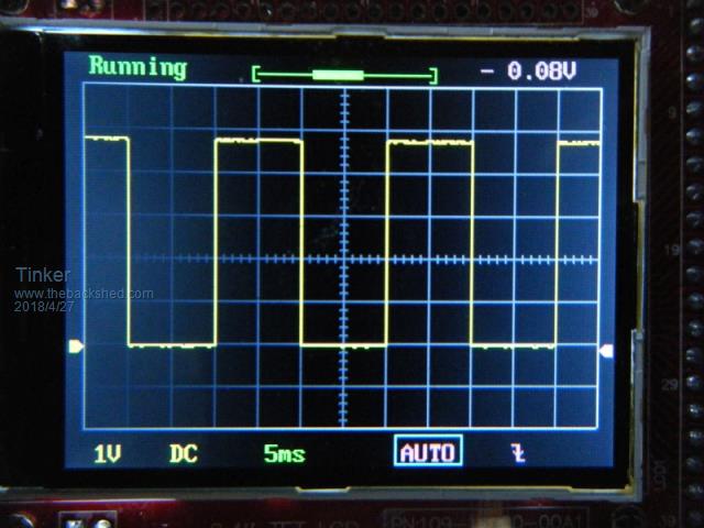

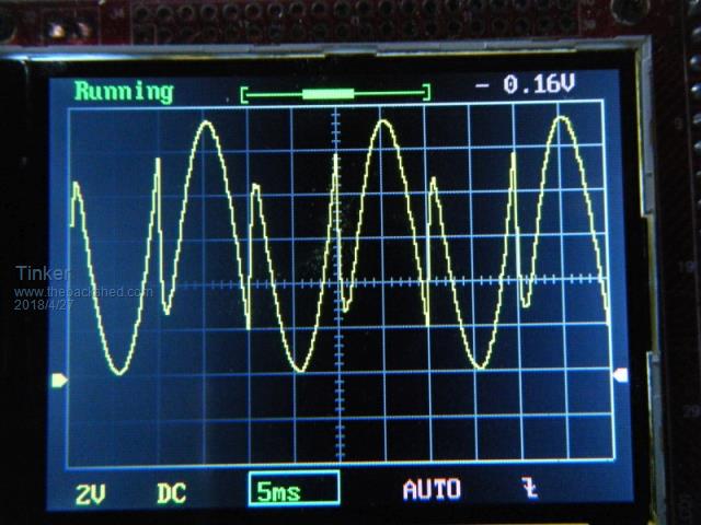

Posted: 10:00am 27 Apr 2018

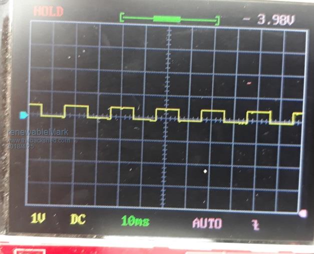

Mark, no need to get a new oscilloscope, that little one is perfectly OK with the right probe.
Here are two pics I took today, I was testing a spare control board for my inverter. The 8010 was set running free by feeding 12VDC where normally the little tranny's secondary connects.
Output 8010, low side:
Output 8010, high side (used special probe):
Its just a little handheld camera which I set for macro to get a good close up of that little screen.
Oztules, if you are reading this, the little cheap digital oscilloscope puts the pics of your CRO .
