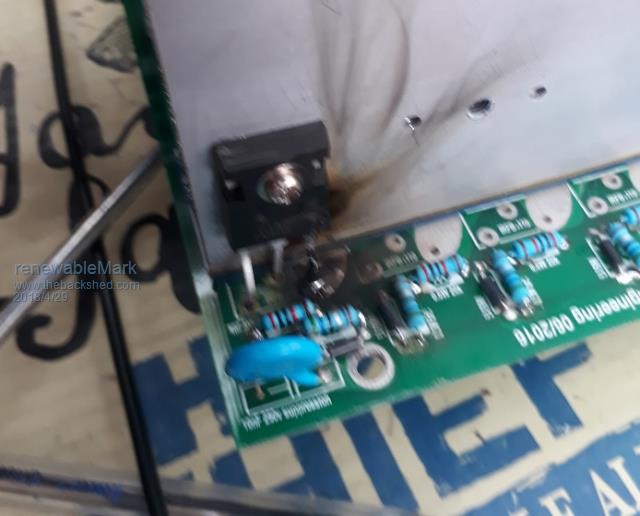

1200 watts current draw at 228 v(rms):
1200 / 228 = 5.26 A(rms)
Peak current draw: 5.26 x 1.414 = 7.44A
Using the magic ratio of 9:1, 7.44 x 9 = 67 amps peak battery draw.
If the 20Ah battery cannot supply this, the expected 48 Vdc input voltage will become low, the inverter will be starved.
Maybe the mosfet drive voltage became low and Rdson went up and overheated the mosfet silicon, causing the high speed avalanche failure. Just my opinion.Edited by tinyt 2018-04-30

Yes, I think you are right mate.
I spoke to Mad and he said the same thing.
I remember OZ writing about a similar catastrophic failure which was his only one where the battery got Waaaaaay down and it sounds like it did the same thing.

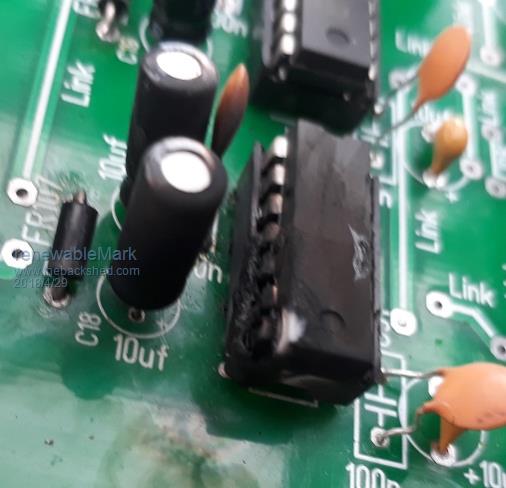

Anyway, I just finished rebuilding it, new diodes and resistors, fets, control board got caps mono, electrolytic and FR107's.
Need to get some 14 pin sockets from a reputable local supplier, the ebay china sourced ones look a tad flimsy, not sure if they were a problem, but may as well see if there is something a tad better made.
So I just need the sockets and wait for the new 2110's to arrive, then I can test again.
This time I'll hook it up to the forklift battery.

Looking at the pictures, if re-using the PCB, inspect it and make sure there are no burned-open copper traces and scrape off any carbonized fiberglass.Edited by tinyt 2018-04-30
renewableMark
Joined: 09/12/2017
Posts: 1679
Posted: 08:47pm 29 Apr 2018
  tinyt said   Looking at the pictures, if re-using the PCB, inspect it and make sure there are no burned-open copper traces and scrape off any carbonized fiberglass.
Yeah, thanks mate, already done, carbon conducts too!

OK tested again top 2110 pins 10 and 12 give square wave, pin 1 nothing, does that indicate a possible faulty 8010?
Cheers Caveman Mark
Off grid eastern Melb
Madness
Joined: 08/10/2011
Posts: 2498
Posted: 09:20am 30 Apr 2018
10 & 12 are the inputs to the IR2110 coming from the EG8010 so that would indicate the 8010 is working.

Hmmm control board was a lot more rooted than I first thought.
Popped 2 sets of 2110's attempting to get it going.
Zener diodes tip35's various caps were rooted.
I'm pretty sure it will be ok when new chips arrive.
Been tempted to buy a scope like this but will only use it once or twice.
If you ever have a big fry up I suggest to just do a complete rebuild of the board.
I'm still not 100% sure it's right. Most parts replaced, seems to test voltages through ok.
Right two pins of fets measure 7-8mohm with ribbon cable not connected, but 3.5m ohm when it is connected, that is with 2110 and 8010 board removed.
I'm feeling that's not right, I'm suspecting I'll have to replace everything I haven't since the big fry. Feels like banging my head against a wall considering new boards are coming.
Desoldering and burning components messes up a board, thes ones are looking pretty worse for wear now.Edited by renewableMark 2018-05-02
