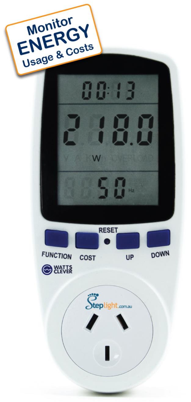

Just for fun I took an Inspire 1.5Kw transformer which has on it only the inner primary winding. That is rated for 135 volts and has 135 turns.
Hooked that up to a variac and one of those e-bay energy monitors that plugs into a power point with a three pin socket on the front to plug in whatever you are measuring.
This energy monitor stopped working below 120v so I could not go lower than that.
120v 7.6 watts
130v 9.1 watts
140v 11.5 watts
150v 14.8 watts
160v 20.1 watts
170v 29.2 watts
180v 56.8 watts
If we take 140v as baseline and call that 100% voltage.
And we take 11.5 watts as baseline idling power and call that 100% power.
If we decrease the voltage by 14% down to 120v.
The idling power drops by 33% to 7.6 watts
If we increase the voltage by 14% up to 160v
The idling power goes up by 74% to 20.1 watts
As you can see its far from linear, and the curve gets very quickly steeper in the increasing direction.
Also note, the gain or drop in power is much more than the change in voltage.
The exact results you get may be slightly different, but the overall characteristic will be pretty much the same.
A few extra turns will drop the idling power by far more than you may be expecting.

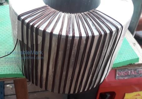

Thanks Warpspeed,
the cautious side of me tells me to stick to Oz's 114, but I do like the low idle current.
Now aiming for 150, if the spool runs out at 140 I'll leave it there.
Here it is so far.
Cheers Caveman Mark
Off grid eastern Melb

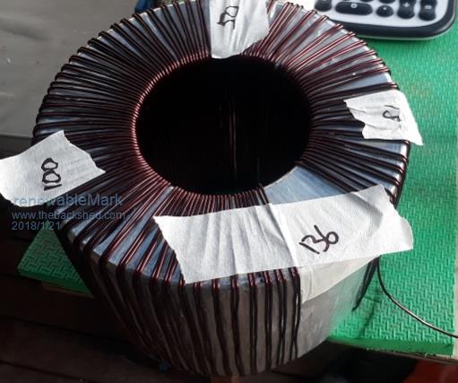

Posted: 09:00am 21 Jan 2018
Well I got to 136, there is a big gap now left.
I'm 50/50 whether to solder and push on or epoxy and slide those around.
the extra 14 will fit ok to get to 150.
Bit worried if I decide to stop here I may not be able to slide them around evenly.Edited by renewableMark 2018-01-22
Cheers Caveman Mark
Posted: 09:18am 21 Jan 2018
You could probably fit on a few extra turns, but leave some gap there.
The toroid hole is now very slightly smaller, and the circumference less, which means slightly less room for the next layer which must have the same number of turns.
Its not much difference, but if you completely fill the first layer, you may not have sufficient room for the same number of turns on the second and third layers.
One further thought, you could run that winding up to 230 volts and know even at this early stage what your idling power is likely to be.Edited by Warpspeed 2018-01-22

I have a couple of these e-bay plug in energy monitors, ideal for toroid testing, you get voltage and direct watts readout.
