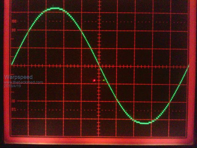

Posted: 06:18am 19 Apr 2018
I did it with pencil and paper, but the results are the same. About one bit time steps between 1005 and 1020 which is fine.
Time resolution of 256 bits (per quadrant) is 1K bits for one full cycle.
With 256K x 8 ROM that gives me 256 different lookup tables.
This is the actual inverter output waveform it produces on an oscilloscope, at 100v per division. There are 81 steps peak to peak.
This is not a simulation or any kind of trick. Its the actual mains waveform driving things in my home right now. The inverter I am using right now has only one lookup table and cannot regulate the output voltage. The dc input must be regulated.
The next inverter will have a large number of different lookup tables (256) that will switch very fast right at the zero crossings where the output is always at zero volts. So every new cycle will be corrected in voltage every 20mS. Should respond super fast to load changes.
Edited by Warpspeed 2018-04-20

Posted: 08:58am 19 Apr 2018
Warpspeed:
this waveform is looking good from a THD viewpoint.
The steps resulting from the discrete digital nature adds up to 1 or 2%
probably less.
This is near enough for jazz.

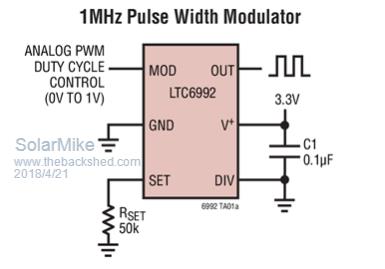

Posted: 01:17am 21 Apr 2018
I will throw this idea into the ring for a very simple SPWM inverter driver control stage:
Linear make a precision Voltage Controlled Pulse Width Modulator LTC6992 , it can be easily set to 20Khz output and with an analog 0-1 volt input to produce 5-95% SPWM output. The analog input can be a 50HZ sine wave osc (couple of op amps) with variable gain, variable gain is part of negative feedback loop from the 230Vac output sample to alter the modulation depth for a constant output voltage.
Only issues I see is the the single 20KHZ SPWM output must be fed to both H-Bridge sides, this will increase the losses slightly and the frequency is dependent on the accuracy of the 50Hz sine generator.
The SPWM signal could be fed into the H-Bridge drive cct earlier in this blog.
Mike

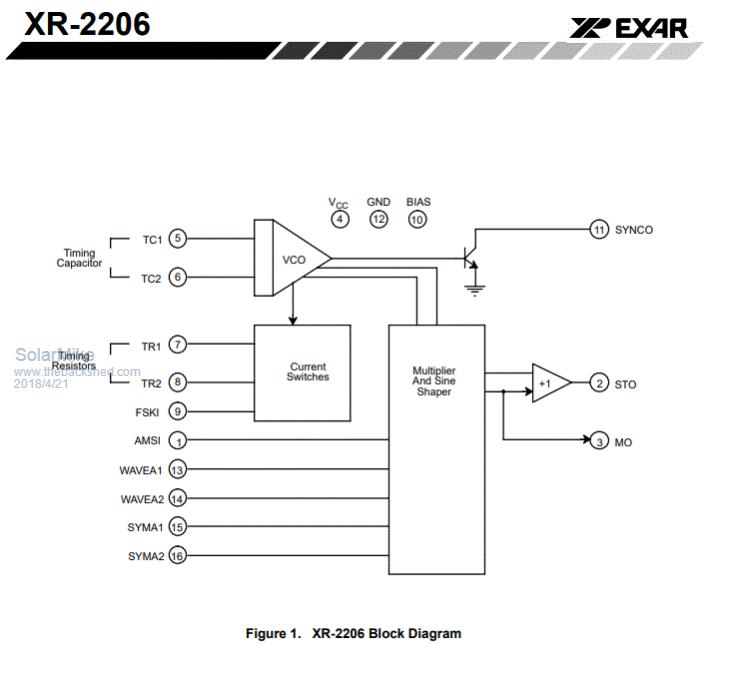

Posted: 02:00am 21 Apr 2018
  Solar Mike said
Excellent suggestion there Mike.
Variable gain drive could be produced very easily from an analog multiplier chip such as an AD663.
A function generator chip such as an XR2206 can produce some quite good constant amplitude sine waves.
If you really prefer to have unipolar drive to the bridge, the 50Hz sinewave source could go into a voltage comparator to provide a 50Hz square wave timed to the sinewave zero crossings. That could then drive one side of the bridge directly.
The other side of the bridge needs to have the phase of the PWM inverted each half cycle, and that can be done digitally with an exclusive OR gate.
An interesting idea.

Posted: 11:03am 21 Apr 2018
Yes that chip looks the part, its amplitude output level can also be varied over a 55db range via its AMSI dc voltage input on pin1, so a separate voltage controlled gain chip isn't required, think I will get one and try it out.
On another subject the TIP41/42 totem pole buffers for driving multiple parallel mosfets can be better replaced by the Zetex ZXGD3005E6 25V 10A gate driver chip, they are in a SOT26 package and cost about 50c each, place one directly at the gate of each mosfet, PDF
Mike

Posted: 12:49am 22 Apr 2018
Intersil make the ICL8038 which is a very similar chip with similar features, but I believe its not exactly the same and from memory has slightly different pin outs. I have no idea which might be better or more suitable. Probably either will work perfectly well for a project like this.
Just had a look in my parts drawer, I still have five of those Exar beasts, and all with 1986 date stamps !
Golly, it must be over thirty years since I last looked at them. So as you will understand, I am a bit rusty about remembering all the exact details and specifications.
But its certainly an interesting approach, and likely a fairly original too, and well worth experimenting with.
That amplitude adjusting pin allows soft starting, and voltage regulation, and making it a part of a phase locked loop locked to either a crystal or to the grid would be quite easy to do as well.

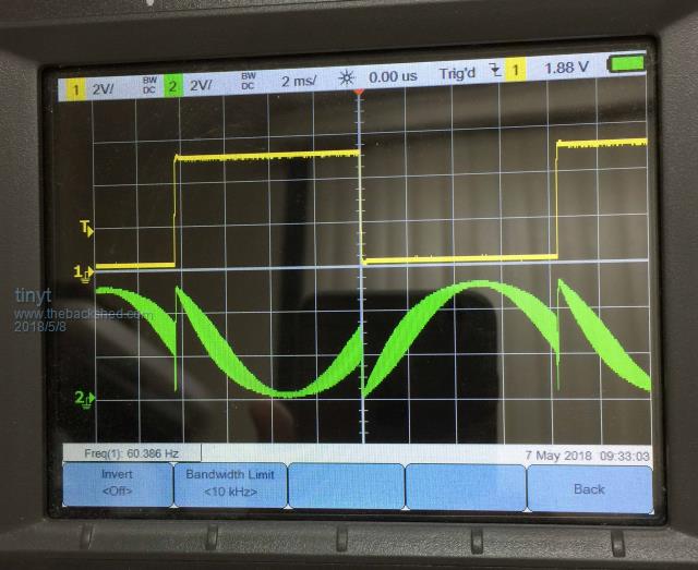

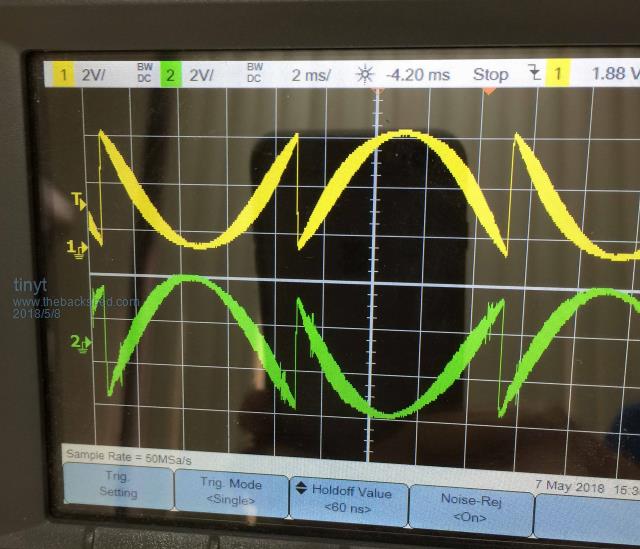

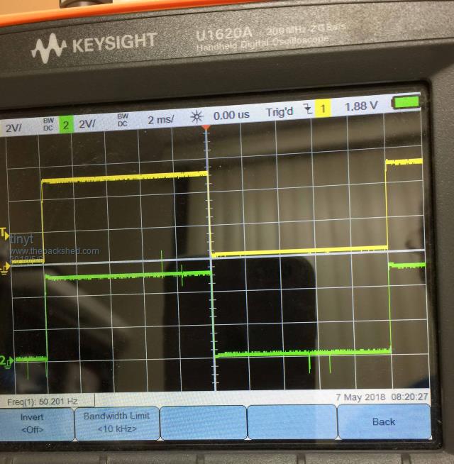

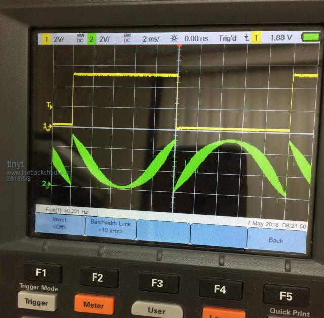

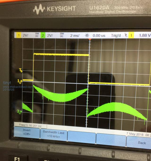

Posted: 04:29pm 07 May 2018
Finally got Poida's code loaded on a NANO using an old STK500. I like the STK500 because it self powers the chip. But it couldn't drive the chip Reset down to zero. Found out that the NANO has a Reset pull-up of 1K compared to the 10K of the UNO's and MEGA's. So I just remove the 1K from the NANO.
This one is after power on:
This one is immediately after the start button is pressed, SPWM is ramping up:
This one is when ramping is finished:
When I changed TCNT2=100; to TCNT2=120;, the scope shows Freq(1) = 57 Hz. Changing it to TCNT2=126; made the scope Freq(1) = 60 Hz. The SPWM waveform is a little messed up with this change.
It is not my 'scope by the way, I just borrowed it.
Making this change also makes the SPWM good again.
#define PPWM (133333 / NPWM) // might need some fine adjustment?.
Edited by tinyt 2018-05-09

Posted: 10:44pm 07 May 2018
  Warpspeed said   Can you do bipolar PWM ?
That should produce a cleaner final output from the inverter, as there should then be minimal harmonic energy at multiples of 50Hz.
Hard switching one side of the bridge at 50Hz, is a terrible idea and gives the transformer a really big sudden fright every zero crossing.
Its the very strong odd harmonics of 50Hz that are likely causing some people grief with waveform kinks after each zero crossing, and wobbles on the waveform due to stray transformer resonances.
Two nice clean out of phase PWM drives to the bridge should only generate harmonics above the PWM switching frequency which are much more easily removed.
Not sure how bipolar PWM looks. But I blindly modified the code as follow:
//pinMode(9, OUTPUT);
sbi(DDRB,DDB1);
sbi(DDRB,DDB2); // ADD-MOD: enable the complement SPWM output pin
{OCR1A = c;OCR1B = c;} // one 1/2 wave or other of 60Hz output MOD: for complementary SPWM
else
{OCR1A = PPWM - c;OCR1B = PPWM - c;} // MOD: for complementary SPWM
pcount++;
And this is what I got.
This is the best capture of OCR1B output. Most of the time it is distorted. Maybe too much code path/delay or incorrect code modification.
