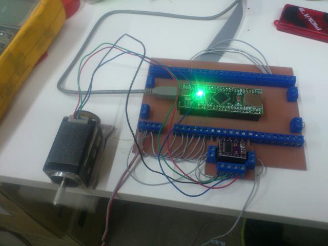

  Quote  Const mStep=48, mDirection=50, mEnable=54
Const MinSpeed = 320, MaxSpeed = 160000 ' 320=6RPM, 160000=3000RPM
Const SetRPM=2900
dim CurSpeed, SetSpeed as integer
SetPin 50, dout
SetPin 51, dout
SetPin 52, dout
SetPin 53, dout
SetPin 54, dout
Pin(mDirection)=High
Pin(mEnable)=High
Port (51,3)= &B001 '<<-- 1/16 Step
SetSpeed = (SetRPM/60)*200*16
do
pwm 1, MinSpeed, 25
pause 100
for i = MinSpeed to MaxSpeed Step 10
pwm 1, i, 25
if i => SetSpeed then exit for
next i
CurSpeed = i
pause 5000
for i = CurSpeed to MinSpeed step - 10
pwm 1, i, 25
next i
loop
I didn't even bother to hook up the DSO to check the pulses because it ran so sweet out of the box, there was no need.
Notice in the code that my set RPM is 2900?
I have the stepper ramping up and down between 6 and 2900RPM and in 100+ cycles, it hasn't skipped a beat. (Actual speed is 2901 RPM - the fastest I've driven a stepper)
There's no sign of the 1250Hz problem - if it's there, the motor cruises through it with no problems.
I even set the STEP between 1 and 50 without any problems.
I suspect I could push the motor parameters a little more and still get away with it (...and I might, just for the fun of it ).
Thanks Geoff, that's a brilliant piece of work

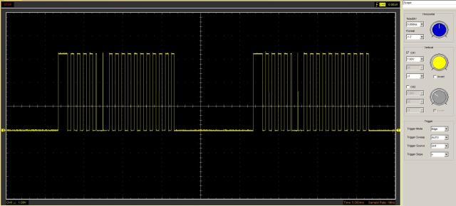

I knocked up some code this morning for testing (complete with my notes)
print "1250Hz Range"
'Notes:
'BaseHz=1246; Good signal > Motor growly, but probably magnet click. 19 Good Pulses
'BaseHz=1247; Good signal > Motor growly, but probably magnet click. 19 Good Pulses
'BaseHz=1248; Signal Chopped > Wide 1st Pulse, 10 good pulse, 1 slightly narrower pulse, 1 spike, 4 good pulse | Regular Pattern
'BaseHz=1249; Signal Chopped > Wide 1st pulse, 4 good pulse, 1 narrower pulse, 1 spike, 11 good pulses | Regular Pattern
'BaseHz=1250; Good Signal > Motor Growly (Magnet click?), 20 good pulses.
'BaseHz=1251; Good Signal > Motor Growly (Magnet click?), 20 good pulses.
BaseHz=1249
for j = 1 to 500
for i = BaseHz to (BaseHz+2)
pwm 1, i, 50
pause 5
next i
pwm 1, stop
pause 10
next j
pwm 1, stop
pause 1000
print "1250Hz"
pwm 1, (baseHz+1), 50
pause 10000
pwm 1, stop
(Edit: Ooops, I hit the post button too soon)
It only comes in to play and is noticable AT the 1249 to 1251 range. That's also an unlikely scenario to ramp up from 1249 to 1251 as minimum speed set to maximum speed set. Speeds will pass through that range, but only on the way to a faster speed.
If you're happy to fix it Geoff, I'm happy to test it - but for my purposes it does what it should

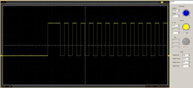

Here's the waveform with BaseHz set to 1249
Azure
Joined: 09/11/2017
Posts: 446
Posted: 11:32pm 06 Aug 2018
I am not sure what that first long pulse is from, it should be the same as the ones after it.
At 1249Hz the pulses are about 0.8ms, so there are about 5 pulses before it changes to 1250Hz which is right where the second glitch is. Then 1250 to 1251 looks smooth (5 more pulses each with a clean tranistion.

  Quote  I am not sure what that first long pulse is from, it should be the same as the ones after it.
Agreed... I presume it's how the register is first loaded and the way the PWM is initialised.
Run this code,
BaseHz=1000'1249
for j = 1 to 500
for i = BaseHz to 1300'(BaseHz+20)
pwm 1, i, 50
pause 5
next i
pwm 1, stop
pause 10
next j
pwm 1, stop
pause 1000
... and you get this...
When it periodically shows up, it's always a wide pulse on the first cycle (similarly at the other end, there's often a narrow pulse on the last one - presumably that's depending on when the PWM is turned off).
The set frequency is perfect from the falling edge of the wide pulse to the next falling edge.
Not a big deal for my situation, but could be an issue trying to control servos when they need a precise mark/space.
