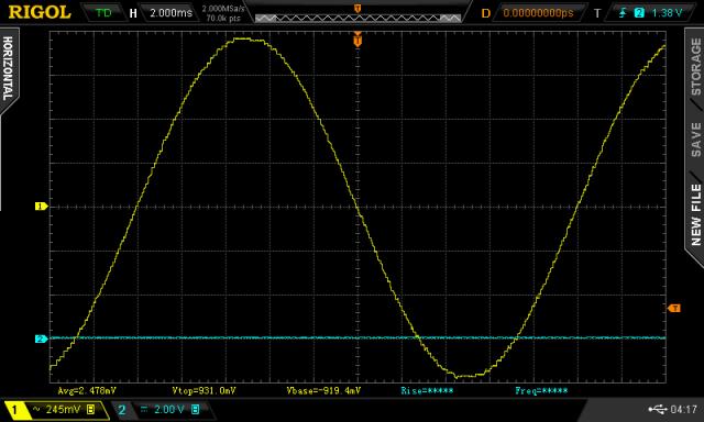

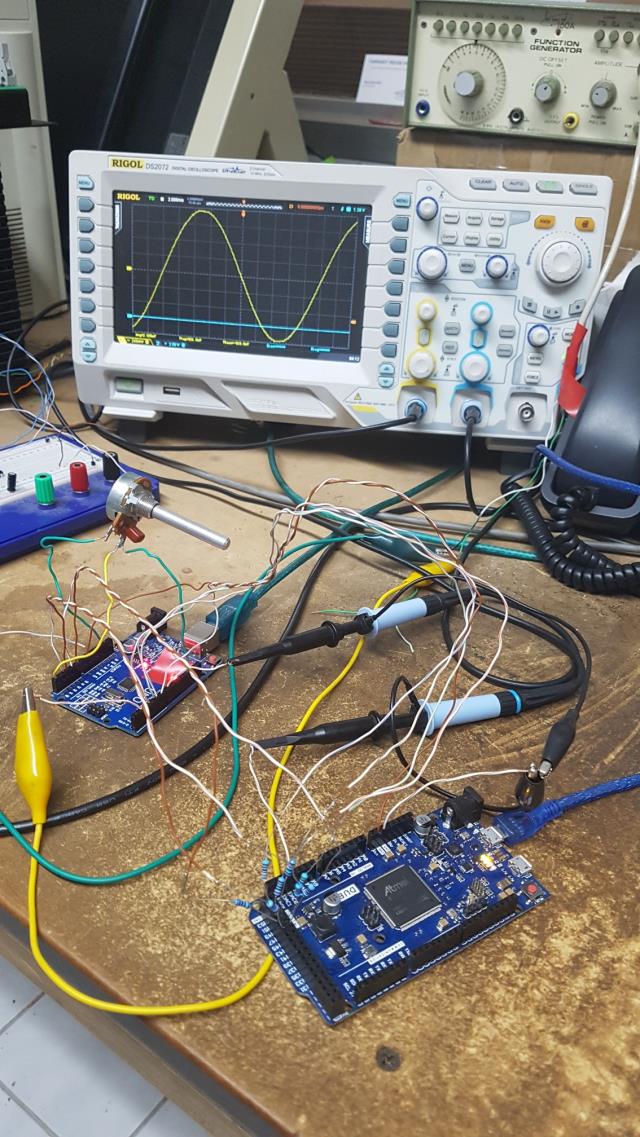

Mack:
Like you I used the Arduino Due to simulate the 4 transformer inverter.
here is the code, and I just put any inverter output into any of PORTC inputs
in any order. (eyesight is no longer useful when tracing thin wires)
I used 5K or whatever resistors to limit current when overdriving the Due inputs
to 5V.
void setup()
noInterrupts();
analogWrite(DAC0,0);
pinMode(44,INPUT);
pinMode(45,INPUT);
pinMode(46,INPUT);
pinMode(47,INPUT);
pinMode(48,INPUT);
pinMode(49,INPUT);
pinMode(50,INPUT);
pinMode(51,INPUT); // PORTC
dacc_set_channel_selection(DACC_INTERFACE, 0);
void loop()
uint32_t p;
uint8_t b;
int v;
while(1)
p = REG_PIOC_PDSR;
b = p >> 12;
v = 0;
if (b & 0x02) v += 27;
if (b & 0x01) v -= 27;
if (b & 0x08) v += 9;
if (b & 0x04) v -= 9;
if (b & 0x80) v += 3;
if (b & 0x40) v -= 3;
if (b & 0x20) v += 1;
if (b & 0x10) v -= 1;
v += 40;
dacc_write_conversion_data(DACC_INTERFACE, v * 45);
It gives the expected stepped sine wave shape.

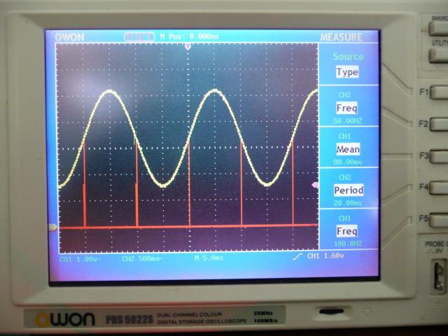

I've done a DUE based step Inverter Simulator:
You feed in the 8 non-inverted outputs of the Step Inverter (of any kind, whether it be an eprom based or micro based) and it scans it at a 10uSec sample rate. The input is translated into a voltage > 12bit value and is written to the DUE's DAC in real time. The image below is of my Eprom based board, but it could just as easily be the new micro based prototype.
The DAC of the DUE seems a bit noisy, and my DSO was syncing to small ~100khz transitions rather than the big picture so I made D27 go high whenever the input, 8 lines were all zero. The DSO liked to sync on that.
As Tony has told me, the good thing is you can vary the battery voltage, and watch how it changes. Etc.
There will be an option for grabbing a frame of data and transmit the data over the SerialUSB in CSV format.
Andrew
mackoffgrid
Joined: 13/03/2017
Posts: 460
Posted: 01:22am 03 Apr 2019
Poida: talk about timing
Your Scope displays a much nicer image than mine.
I came at it from a different direction than you did. I started out intending to display a plot on an LCD, so implementing grabbing frames of data to export to serial and display. I decided I couldn't be bothered by the LCD and implemented the DAC.
I like the simplicity of yours and it shows more simply, how the inverter works.

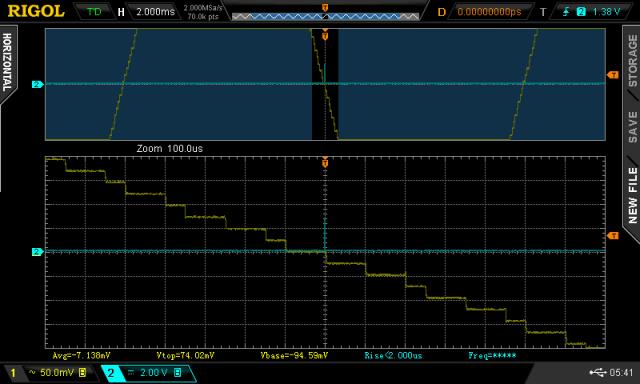

poida
Joined: 02/02/2017
Posts: 1510
Posted: 01:58am 03 Apr 2019
I usually find the DSO of mine shows cleanest traces when I choose "High Res"
from the Acquire menu. This averages many samples together and then displays that one average value on the screen at each pixel's time value.
Eg maybe 640 pixels wide, time base is 2ms/div, 10 divs screen width
So a pixel might be about (2ms x 10)/640 = 31us each. The DSO might be sampling at 2M samples/sec, so each pixel is the average of 62 samples. This crushes noise.
Your DSO, OWON PDS5022S, does not have this high res mode. You do have 2 things to help. First, I would enable the HF reject on the trigger, under "Coupling" in "edge trigger menu". And I would use under Acquire menu, the Average function, maybe 4 or 16 averages. This should clean things up.
DSOs have shown to the great unwashed masses how much noise is present within a scope's front end. (just short ch1 with small wire and see the trace still appear "noisy".)
CRT scopes don't show it to human eyes very well due to each trace is showing the new noise, never overlapping the previous trace's noise. CRT traces look cleaner. Only 'cos we can't see the noise. It's there...
Maybe just for you and me, here is a closeup of the zero crossing, clearly showing the steps as it approximates the sine function at various times.
Posted: 04:03am 03 Apr 2019
Its really interesting to scroll through several lookup tables.
The difference between two adjacent tables might be only about half a percent in overall amplitude.
But the time lumpiness visible in the individual step timing, changes radically from table to table when viewed up really close in fine detail.
If you can make a total harmonic distortion measurement of your waveform, you might be surprised how low it is.Edited by Warpspeed 2019-04-04

mackoffgrid
Joined: 13/03/2017
Posts: 460
Posted: 11:53am 03 Apr 2019
Poida: Yes, the Owon is no RIGOL and you drive that Rigol like it's a car My old Owon is over 10 years old now and has proven to be a very good purchase, but it wasn't meant to be my Scope but that's another story. I used to have a really nice 4ch DSO, back some decades ago, and lately I'm finding myself really missing a good 4ch DSO.
I've seen the sinewave out of the transformers for real, but even now looking at the output of the simulators, it amazes me how four transformers with three states can make such a good looking sinewave. Very cool Tony!
I'll get back to tidy up my Simulator code tomorrow but basically like yours but with a button press to capture a frame and transmit the data to the PC.
btw, I used C1 to C8 , in order, with switch inputs at C12 and C14.
