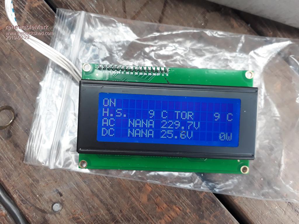

Posted: 11:10pm 22 Sep 2019
Poida, what is the 0W in the bottom right?
If it is meant to be watts, mine isn't working.
Also what is the offset settings for?
ALSO, found something great, it can be left with the DC power on, but the inverter not actually running, (so caps still kept charged) and it only uses 0.05A.
Then the single momentary button brings it to life, then it uses 0.34A @idle with the 240v available.
So basically it can be in "sleep mode" with caps staying charged and it uses only 1.25 watts.
So I won't need to teach the wife a start up procedure, just leave the dc on and caps charged and she can just hit the round ON/OFF button.
Even left on overnight that won't draw bugger all.
Edited 2019-09-23 09:28 by renewableMark
Cheers Caveman Mark
Off grid eastern Melb
poida
Joined: 02/02/2017
Posts: 1510
Posted: 12:58am 23 Sep 2019
0W in bottom right corner is the product of DC volts and DC current.
IF there are available values for both, and they are sensible values,
then we get a DC current value visible and a DC power value.
Offset settings are needed due to many and varied methods we can use to
feed the nanoverter it's inputs.
The analog to digital conversion requires a voltage from 0 to 5V.
I like to use LEM closed circuit control Hall effect current sensors
for DC current. These are totally isolated, need 5V supply and give output
of 0V for -50A, 2.5V for 0A and 5V for 50A
I expect the zero amp sensor output to be close to 2.5V but never exactly
what the nano sees as 2.5V
So I need to obtain zero offsets for both current sensor inputs.
I have offsets for both NTC thermistors, so I can have them both showing the same
temperature when they are exposed to the same temperature.
I could not leave it be when I saw 5 degC difference between two thermistors which
were seeing the same temperatures.
The latest code for nano2 has a display of output AC amps and AC VA
I label it as "W" but again, it's the product of AC volts and current.
It is ignorant of power factor.
latest code (AC power display):
nano2_5_ac_current_sensor_dc_signal.ino.zip
