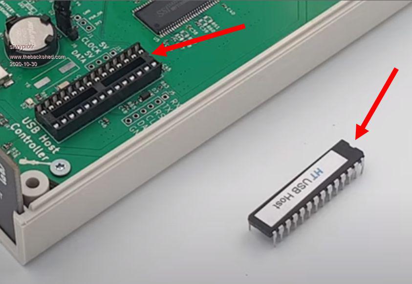

USB version of Maximite is working!
Latest version USB controller installation:
https://youtu.be/lRGXsFi5QTs
Latest version USB mouse functionality presentation:
https://youtu.be/Tf0sAGK0CPM
More information available on this thread:
https://www.thebackshed.com/forum/ViewTopic.php?FID=16&TID=13005

Do you have the Eeprom for the HT chip? I cant see it in any of your pictures.
Kind Regards

  bigmik said  Hi siwypiotr
Kind Regards
Hi
What do You mean by Eeprom? Eeprom is inside this pic microcontroller:
This microcontroller You have to buy from https://hobbytronics.co.uk/ and it comes flashed with USB firmware.
I have on stock couple pcs and I can sell them together with Maximite

Hi Siwypiotr,
It is the 24LC02 in this schematic from HT..
Schematic
I have a home built unit with a HobbyTronics SOIC chip..
Without the eeprom the error led is permanently lit (pin 12 is high on the PIC chip).
Whether or not that is really important or not remains to be seen..
I suspect PeterM sets all the settings for the mode that the HT chip is going to be used in so maybe it is superfluous....
MICK

  bigmik said  Hi Siwypiotr,
MICK
I used minimal schematic for my design:
https://www.hobbytronics.co.uk/datasheets/usb-host-v2-basic-IC.pdf
If You look closer on HT web page:
https://www.hobbytronics.co.uk/usb-host-dip
You will find that:
  Quote  The EEprom on the USB Host Board is not needed for normal functionality. All settings will be stored in flash memory on the chip itself if the eeprom is not detected. The reason for the eeprom on the board is that the flash memory is erased when new firmware is uploaded, so settings will be lost (the settings will go back to defaults). The eeprom on the board avoids this.
That is why in my opinion eeprom is absolutely not needed.

Hi siwypiotr,
That is a good find about not really needing the Eeprom..
I have two new PCBs in DHL's hands coming down under to me. I did cater for the EEprom to be installed and have added the ERROR LED..  I can put in the instruction manual that these are optional and dont need to be installed.
Honestly reading the link you found I dont see the point in having the Eeprom, why save settings for say a MOUSE and then flash say a KEYBOARD code in? The settings would not in most case make much sense.
Anyway Good job on your design you are really doing well there.. Keep it up
